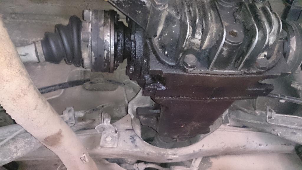

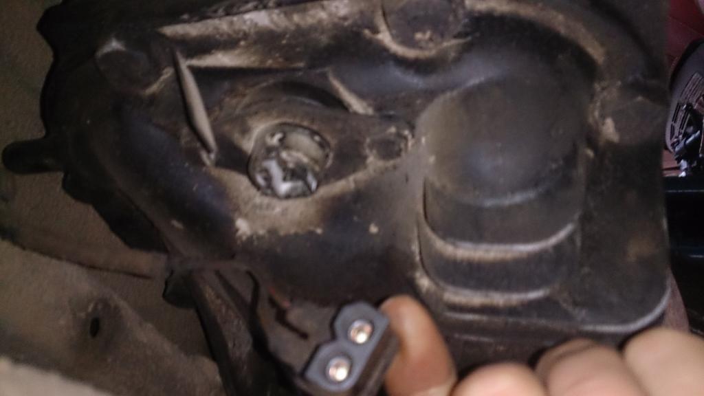

    Hi Al, this is my first post on here so I hope I have the right section. Just got myself a 318i manual. Just cone from a life as a drift pig. Supposedly it has an e36 diff in it. Now to test that. Any ideas? The speed sensor and plug are different. So that might be one thing suggesting e36. Is it a 4.33? Or is it actually an e30 diff. Any suggestions would be much higher appreciated.
    Cheers, Jordan

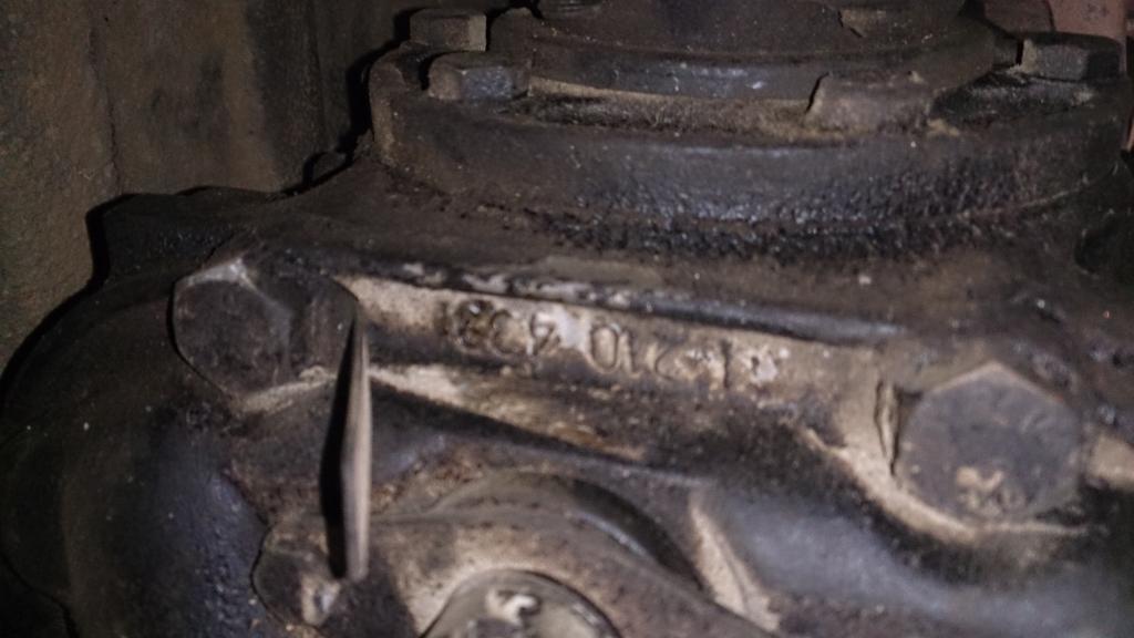

    The little tab that is bent up in your picture should hypothetically tell you the diff's ratio in the last three digits. However it's best to check the ratio on your own.

        The tag you flipped up to take the picture of the 433....the tag is where the gear ratio is, not the diff case. Another thing...the first picture, it seems the shaft isn't all the way into the diff which is causing that leak. The flange in the diff should not be sticking out that far and if you can't push it in anymore than you have the wrong flange on there.

          That is a small case 168 differential. The flanges stick out more on them. Looks like it is leaking though. If it feels extremely short, it could be a 4.44 from an E36. Just pull the tag and clean it. Most tags have the ratio on them. Speed sensors can vary on the E30 (for instance - the iX uses the same # as some E36 cars). If it is LS mark the flanges and count revolutions.
          The speed sensor looks like the early type. If the car feels pretty buzzy on the highway, It might be a 4.10 from an automatic. In the USA, manuals came in 3.64 and 3.91 while automatics were 4.10.
              Not true. That is a 188mm Medium case Diff. The small case 168mm has the drain plug and fill plug offset from one another. The Diff on pic is a 188mm but maybe it has output flanges from the E28?

                My bad. It is a 188. I took one look at the flanges and jumped to conclusions too fast. Those don't look like E30 188 flanges.
