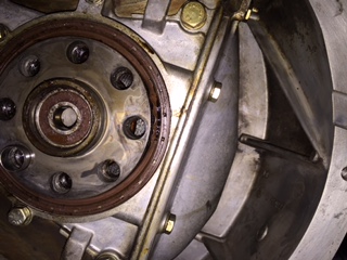

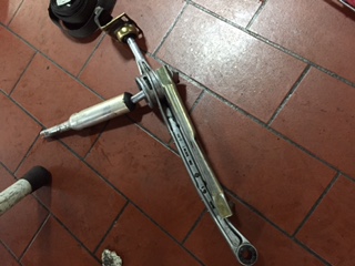

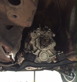

                              Update
                              So.. Today I decided to replace my clutch with pressure plate, throwout bearing, pilot bearing, and rear main seal. Doing all this and the growling/humming noise at idle is still happening. Kinda bummed, but at least I fixed my oil leak from the rear main, and have a better clutch feel/grab. Also had time to clean the tranny and shift linkage while I was at it.
                              Since none of this fixed the problem, I am assuming and almost 100 percent sure the noise is coming from inside the transmission. Probably the input shaft of the transmission.
                              Some pics from today.
                              The old rear main seal developed a wrinkle..
