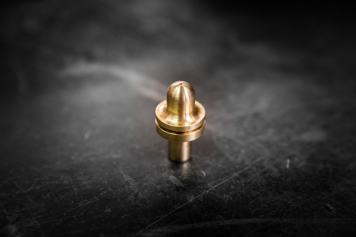

                  • Supratreo
                    • Aug 2016
                    • 135
                    Well, my cousin already picked up another TOB so I guess we'll just go that route. Just out of couriousity, how did you extend the pivot? Just a couple washers behind it?
