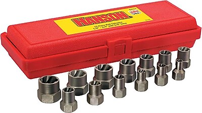

          You might have enough exposed thread to get a bolt extractor on there.
              I don't know if any stores here have these around here and I definitely mangled the threads by hammering on it with a chisel :)
                Mangled is what theses are good for.
                Lowes has them:
                https://www.lowes.com/pd/IRWIN-BOLT-...8-40b4188cb319

                  You'd need a huge one, though...
                  It is tapered- and it often wedges itself in there pretty good.
