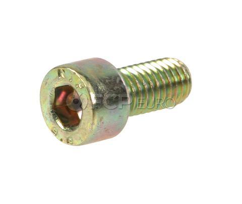

    So I managed to strip a few of the pressure plate bolts with an improperly sized allen key. I found the part number on real oem, but pelican and ecs tuning want way to much money for a small bolt. Can I get these at a hardware store, or are they somehow special?

    Not sure if those are 8.8 or higher but I would think as long as they are the correct grade you should be fine.

      Aren't these specific torque to yield bolts?

        Not the ones holding the pressure plate to the flywheel. They are small M8 cap head machine screws.
        I wouldn't hesitate to get some from the hardware store. Like Jeff said, just get the same grade and you will be fine.
        Looking closely at the picture FCP Euro has on their website, it is an 8.8 grade.

          Perfect, Thanks guys!
