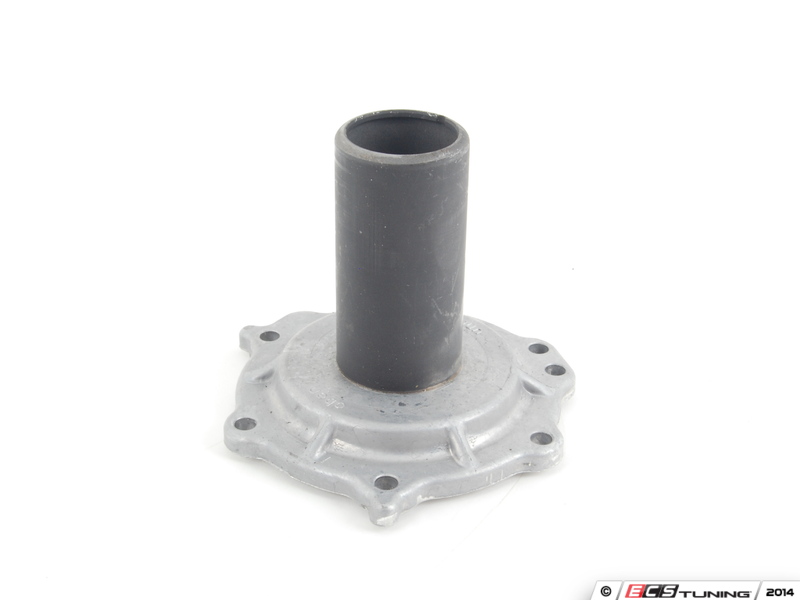

    I have Getrag 260/5 from 88 M20 e30. Realoem list only one piece housing cover (cover and throwout bearing guide as one unit). My throwout bearing guide is bolted to the cover. Anyone has the part number? I can't find it anywhere...
    Or does anyone know if e36 one will fit? Trying to save $200.....:rippedoff:
    E36 part number :23117510016

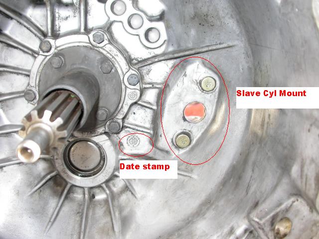

    My Getrag setup:

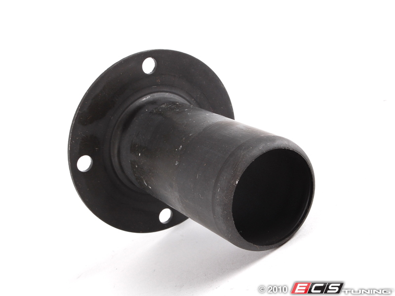

    unit that Realoem lists:

    well....I ordered one to give it a shot. It looks like BMW changed that part sometime in 88 for some reason. Kind of sucks since throwout bearing guide should be replaced for new bearing install and new guide/cover assembly goes for $200 vs $20 for the guide only. Also, the downside of replacing the whole cover is the fact that input shaft bearing has to be re-shimmed.
    Fingers crossed that BMW was cheap enough to redesign/manufacture new part for E36/E46 and went back to old E30 part. Looks like their diameter is the same (cars share the same TB)...the flange diameter/bolt circle is my only concern at this point
    Will let you guys know once I find out.

      I didnt touch the shims when I replaced that seal and mine is the one in your last pic. Why are you replacing this ?

            Ive never heard of anyone replacing that so I call BS. Besides, based on your pic, yours has 4 bolts so just rotate it 90 degrees and re use it

                      I just checked both the spares I have here which both have the 4 bolt guide you have and while they both have shiny areas where clearly something slid on them, I would never contemplate changing either.
                      I can see how checking this on the bench might be a concern but I dont see how installed it would matter since all the pressure is on the PP fingers, fork & TOB whereas the guide is...well...just a guide.

                        Mine shows wear way past the coating, tube itself is worn out. I can see why Sachs specifies it as potential issue as uneven surface can make TB to bind while sliding. I just hope $20 will fix this.

                            I might have to take you up on that. BMW old design is no longer available. New design is $200 hence I'm trying $20 part in first pic from e36

                              That e36 piece sure looks the same as what you have. Curious to see how this works out.
