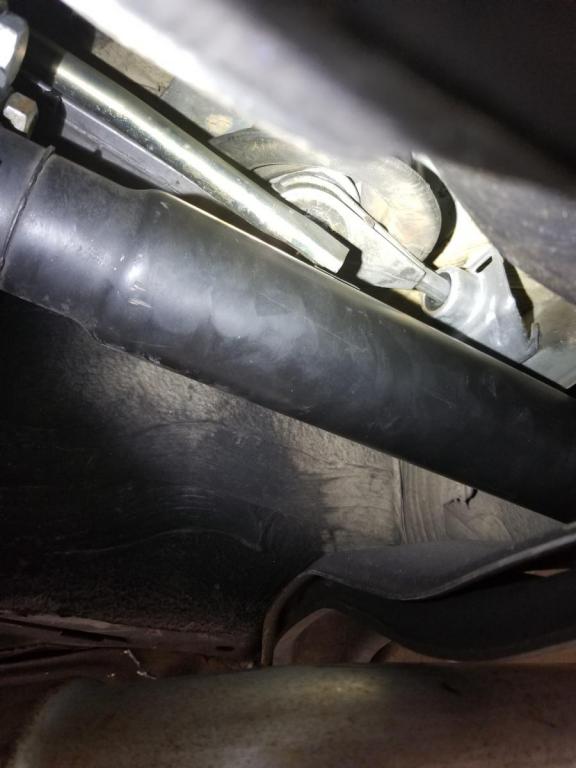

      BMWman91 - Thanks for your reply. At this point, I have decided to forge ahead with the ZF transmission, the E36 328i driveshaft, and BMW guibo. Before doing so, I need to replace the driveshaft output flange as the one on the car was either drilled out or warped out with the Revshift guibo. Here is my additional question - The current shift rod will hit the E36 driveshaft so I assume I need to go to a stock E36 shift rod - not sure if the current one is part of a short-shift kit. Is there anywhere to gather measurements for E36 shift rods - it looks like it needs to be about 1.5 inches shorter than what is in the car. Thanks in advance for any and all assistance.

          I have attached a photo of the current shift rod - as stated I have a E36 328is driveshaft ready to put in the car but it appears the current after-market short shifter will interfere with the E36 driveshaft. Any thoughts on the correct shift rod/linkage to solve this problem?

            You have a few options. 1. grind down the rod so that it clears 2. change the shift lever to a slightly longer throw (less distance between the ball and the rod) 3. Use an ERK kit ($50?) to raise the pivot (and shift lever) higher so that it clears the driveshaft.

                It looks like your carrier bearing is installed in the lower position. You should be able to bring it into the second hole to raise the rear of the shift carrier. That may give you just enough clearance.

                  just to reiterate - E30 with S52 engine, ZF transmission, Revshift guibo and stock E30 driveshaft. In mounting the Revshift guibo, it looks as though the holes on the output flange have elongated and will be replacing with an M3 output flange to mate with E36 driveshaft. Shift rod, carrier etc is where I need help. Two things - I have no idea what is in the car for a shift rod and carrier but as you can see from the picture, the shift rod is almost interfering with the stock, E30 driveshaft. The E36 driveshaft has a raised hump and thus there will be definite interference.
                  I have seen people suggest an E30 shifter with an E36 carrier. Just want to be able to hurdle this shifter/driveshaft issue and move on to the next issue. Thanks in advance. Frank

                    Have you confirmed placement of the carrier??

                      Dude8383 - I have yet to as I have not had time to get the car on a lift and have a look. Thanks for the pictures. I am a bit confused as I was not aware the carrier bearing has 2 applicable settings and I was trying to get my bearings looking at the photos. In my picture, all the way on the right side where the shift linkage enters the silver square (??) is there any way to make adjustments there - the PO swears it's an E36 linkage but I have my doubts. Waiting for an M3 output flange to arrive before I take another run at this. Thoughts other than carrier bearing? Thanks. Frank

                        No the only way you can adjust it is raising the position of the aluminum arm/carrier with that bearing or using a shift lever that doesn't have as long of a length from the fulcrum.

                            I think that you're overthinking and not DOING lol. How many days have we gone back and forth now? Why don't you get under there and take a look. The linkage and selector rod are irrelevant with respect to the HEIGHT at which it sits. The lever and the position of that carrier bearing DO play a roll in the clearance of the shaft.
                            So stop overthinking this and physically check with your own two eyes and report back. We can't help you if you don't actually do some diag yourself dude.
