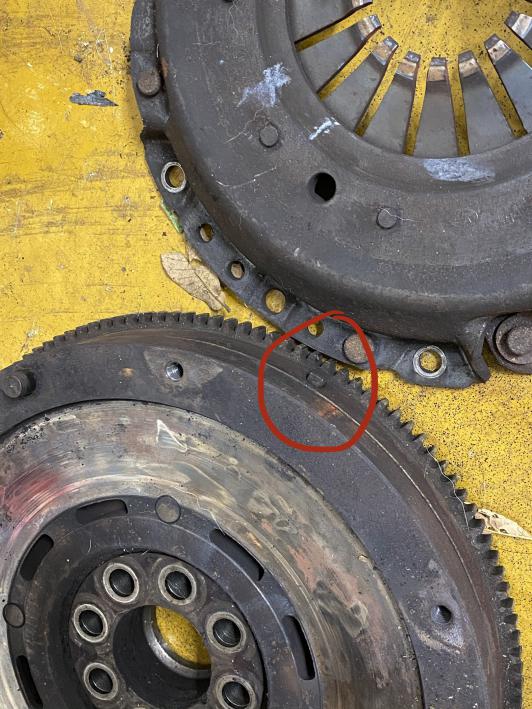

    Attached some photos of my previous dual mass flywheel for reference, as well as the Valeo flywheel kit install papers:

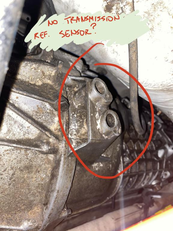

    Do you have two sensors on the transmission bell housing down by the clutch slave cylinder? If so, one looks for that reference tab and one counts the teeth.

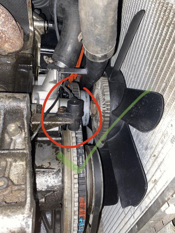

      If it's a seta, then there will be one sensor at the front of the crank.
      Two things are telling me you have the wrong clutch kit. One, the holes explained in the instructions is for an e36 - those holes are for timing the VANOS. Two, the e36 has a smaller ring gear (same with m42). So the starter will grind.

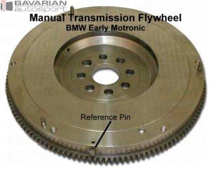

      If you do in fact have a single crank sensor (toothed wheel on the crank hub), then all you have to do is swap your starter from an e36, or m42. If you have the two crank sensors in the bell housing, then you will need to change back to a FW with the cylinder reference pin.
      https://www.r3vlimited.com/board/for...nce-pin-broken
      Click image for larger version  Name:	flywheel_manual_ref_pin_text-300x242.jpg Views:	0 Size:	20.8 KB ID:	9935486

        I can confirm I do not have two sensors on the bell housing by the clutch slave cylinder. So thats good news in a sense?

          Seeing now that I do have a single crank sensor. It looks like I somewhat lucked out for only having to swap the starter to be compatible with the flywheel swap then.
