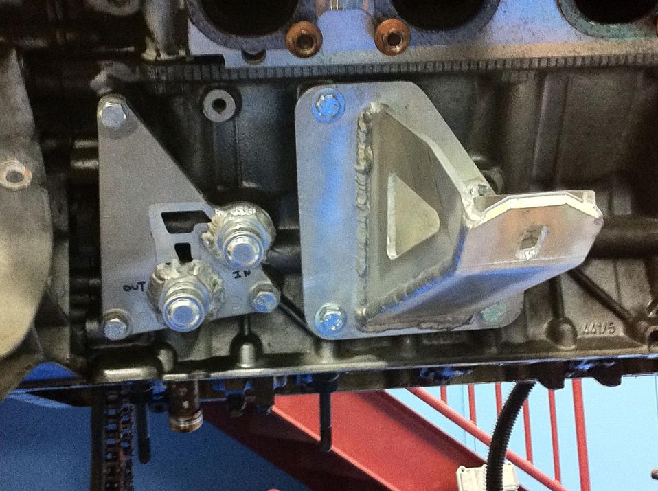

That is a very useful swap part. With two -10 AN Aluminum bungs welded to it, that plate is a slick take-off to a remote filter/cooler. I was going to either tap the block, or build my own plate with O-ring'd counterbores, but this is easier and less expensive.

I've attached a photo of the modified X5 part, with -10AN bungs welded to it. This will make it trivial to install a high-performance remote oil filter, and ditch the stock, heavy BMW filter housing. And since the plate bolts on, the block remains unmodified.
-Bruce
Wow Bruce! That's a pretty slick mod to that part! I still may just tap the block for mine to run a remote filter setup, but in your application this is right on the money. Nice motor mount, as well. Still waiting to get mine back from the duplicator(Jean), Lol! Any new news on the clutch/pressure plate front? Keep the pictures coming...

I like that modified x5 part, pretty sure I'll just go with that as well :)

That's cool Jean, just had to razz you a little, Lol! I like Bruce's piece, as well... maybe I'll do it too. Since my motor is completely disassembled, though, I may just tap the block...

I didn't answer this right away... I thought I'd let Jean post a reply, but since he hasn't yet... I made the mounts Jean is using. He "borrowed them a while back from me to use as patterns to fashion his own. His fab guy is not the fastest fabricator, as he's been at it for a few months. Chances are, he works on them in his spare time, which may not be much, Lol! Jean has promised I should have the mounts back soon, as I'm getting closer on my build to needing them. They're not difficult to make, I copied the idea from the ones Jonsku made, which are the ones that are for sale. They're pretty salty, pricewise, which is why I just made my own. Jean and I were talking about our swaps, which were going on simultaneously, and asked if he could use mine to pattern his and I said sure...
