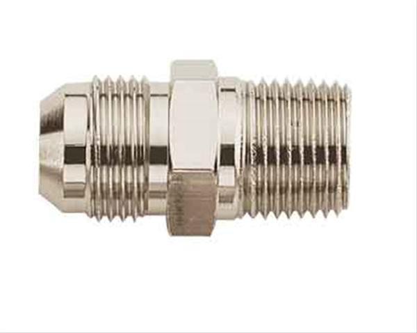

  • gregslow318i
    replied
    Originally posted by bmwmech1 View Post
    Never thought of tapping the block... I was going to source the E39 remote filter setup and use that, but this would be better and less expensive... I'll do it this way... what size tap, Lol?
    Garey
    iirc -10 to 3/4 npt make sure you use a steel fitting
    Free Shipping - Aeroquip AN to NPT Adapter Fittings with qualifying orders of $109. Shop Fittings and Adapters at Summit Racing.
