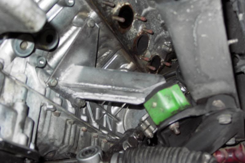

  • gregslow318i
    replied
    Originally posted by Jean
    Greg - I am not going to run AC so the passenger side should be easy once I figure out the best mounting points for it and for best exhaust clearance.
    Do you have any pictures of drawings showing where on the block you mounts yours, what manifolds are you using again?
    dont have any pics of the manifolds but I used the e34 ones and modified them to 4 to 1
    only have a pics of the drives side mount at the moment
    btw just broke 8k miles on the swap

  • gregslow318i
    replied
    jean, I just removed the drives side mount all together and drilled and taped the holes in the block to fit some -10 an lines and ran a remote oil filter.
    for the pass side I milled down the back of the factory mount to the thickness of the new mount and basically sandwiched the old mount on top of the new one

  • Jean
    replied
    Spent some time yesterday with a friend of mine working on the mounts. I may need to change these a little bit, we'll see. The passenger stock engine mount is HUGE, and it also holds the A/C compressor. The driver side is even bigger PITA as it has oil filter housing lines going through it.
    Now, there are two ways (at least) that i've seen people go when mounting these engines. One way is by keeping the stock m60 engine arms, and welding custom arms to the chassis frame rails...So basically engine is not mounted to the e30 subframe..
    Second way is the usual, make the custom mounts, remove the stock mounts and let the engine sit on the front subframe.
    The issue I need to resolve now is to figure out the following:
    a) what to do with the driver side stock engine arm, since it's oil lines go through it
    b) just how much more room x5 manifolds will provide vs stock e32/e34 v8 manifolds.
    c) best mounting points on the stock block for the custom mounts.
    Anyway, on to some pics.
    bmwmech (Garey's) mount is painted, and a test mount me and a friend of mine spend some time last night making. Once I can confirm clearance it can be re-done cleanly etc... it's just a rough "draft" if you want to call it that.
    Before removing the passenger side mount, ac compressor.
    Here is the passenger side mount/ac mount/compressor
    Here you can see the driver side mount with the oil lines...

  • bmwmech1
    replied
    [QUOTEOrganicMechanic;2376621]who you all using for mounts? How much?[/QUOTE]
    I made them, then Jean asked me if he could use them to make his set from, so I sent them to him to make copies and as soon as his guy is done copying them, he's sending them back to me...
    Garey
