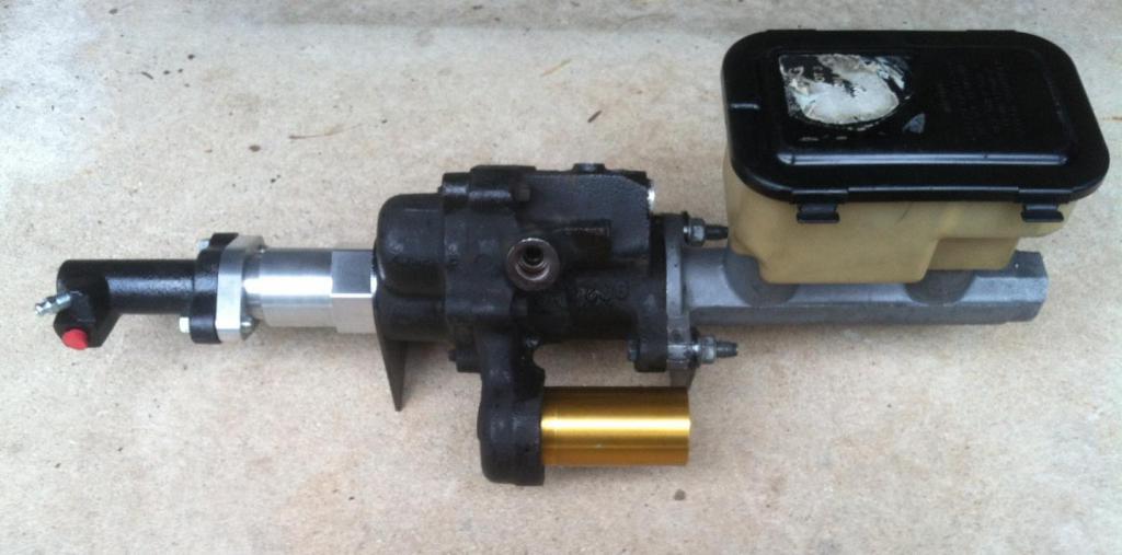

    If it were 1"... maybe, depending on which plane the smallest clearance is in.
    It really looks like about the width of the bolt head, which I would not be comfortable with... but the perspective may distort that, which is why I asked.
    He did a grea job with the pedal box, though; it looks very neat.

      there is info here:
      here are a couple things off the top of my head: i don't know if it would clear the strut tower on the left side, but perhaps the e23 booster might be a better choice because about 2" are inset into the firewall and the entire setup is in turn 2" shorter.
      also, since its hydraulic, and there is no gravity feed, i think that the master cylinder could be rotated 90 or 180(or 270) degrees on the mount if that might place the orifices in a more strategic position.

        How much clearance actually is there between the booster and the cylinder head or coil cover? Looks like less than 1" (25mm)...
        Originally posted by Jonsku
        .. which is already enough :)

                          the pictures are back up now in the link above thanks to an awesome member from finland.
                          i have actually moved on from the bmw parts and i am no longer using this system. i got the idea of using a gm self contained hydroboost unit from looking at sikky's web site.
                          the problem is that with a dohc engine, there isn't space. check this out:
                          http://www.ebay.com/itm/TDS-Remote-H...p2047675.l2557
                          instead of the chevy truck master cylinder in the pic, i am using a 750i mc and the remote reservoir from an e34 v8. it really is a much better solution. less space, less complicated, you can put it anywhere. you only need 2 hoses and a return instead of about 7.
