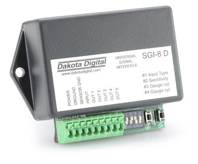

Also, I'd recommend the Dakota Digital SGI-8 for the tach signal. It's programmable, so you don't need to change your coding plug. You just tell it how many cylinders your tach thinks it's seeing (6) and how many it's actually seeing (8 ), and it does the rest. It takes 2 seconds to set up, just uses DIP switches.
