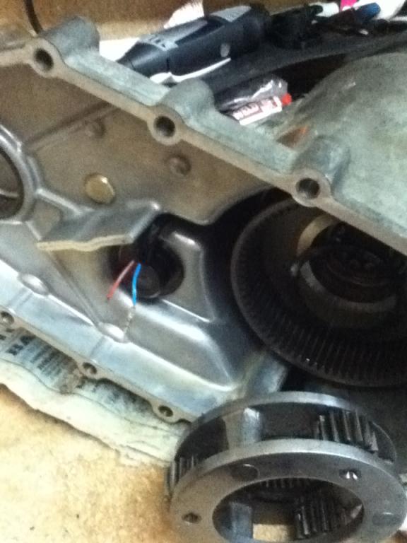

    Originally posted by Turk
    I don't have any wiring unfortunately, just the pins on the case itself. Ill try it both way round. The pins don't look that thick so I'd assume its a fairly weak signal.
    Not sure if i should attempt to remove the block behind the pins to see whats going on in there...
    Here are the wires. According to your picture of the pins, the top pin is red and bottom is blue.

      so which bit is the actual magnet?

        The actual magnet should be on the other side of the ring gear for the planetary center diff.
