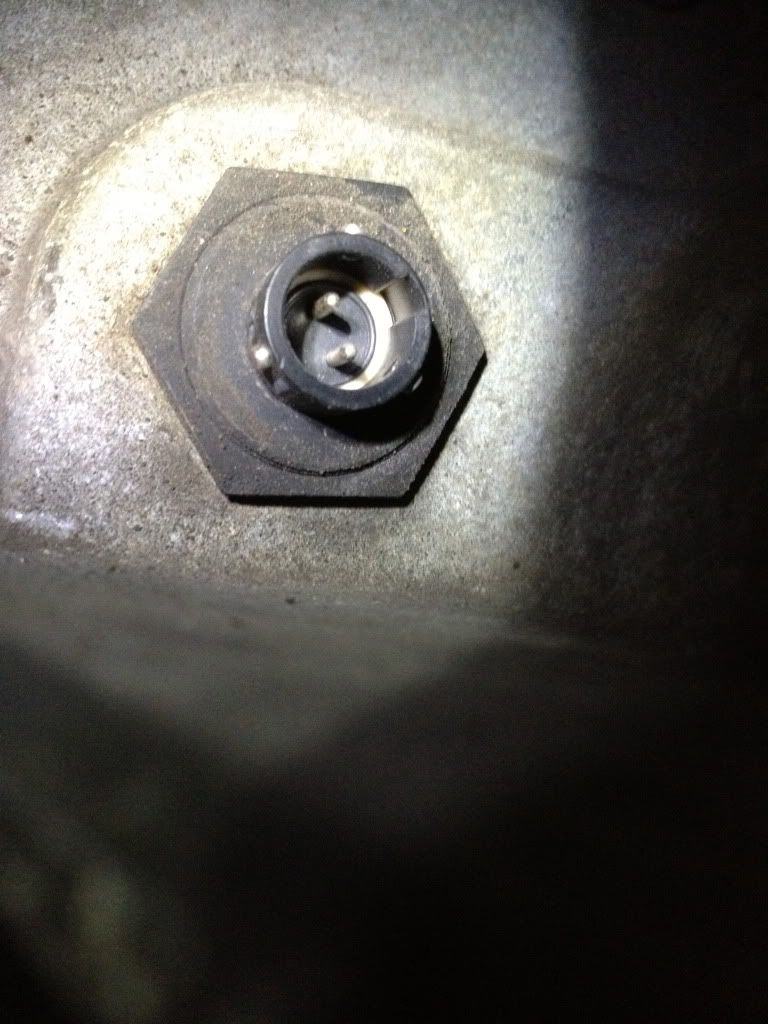

I don't have any wiring unfortunately, just the pins on the case itself. Ill try it both way round. The pins don't look that thick so I'd assume its a fairly weak signal.
Not sure if i should attempt to remove the block behind the pins to see whats going on in there...
yeah, you could always add a 5a fuse or something small to be safe, but it's an electromagnet, so unless you run 100v or something through it, it should be fine.
OK, Continuity check confirms the 2 pins are defo connected. Ohms, was all over the place the for the first second and then settle on zero.
There are 3 stubs on the outer side of the plug These also have continuity between one another, and look like they're designed to hold a circular, metal clipped plug.

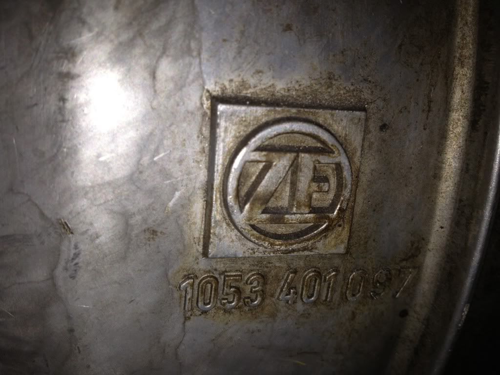

What I need is someone to post a picture of some e34 plugs with cabling on so I can attempt to lock the basterd up! There is a part number on the actual plug but cannot for the life of me read it.

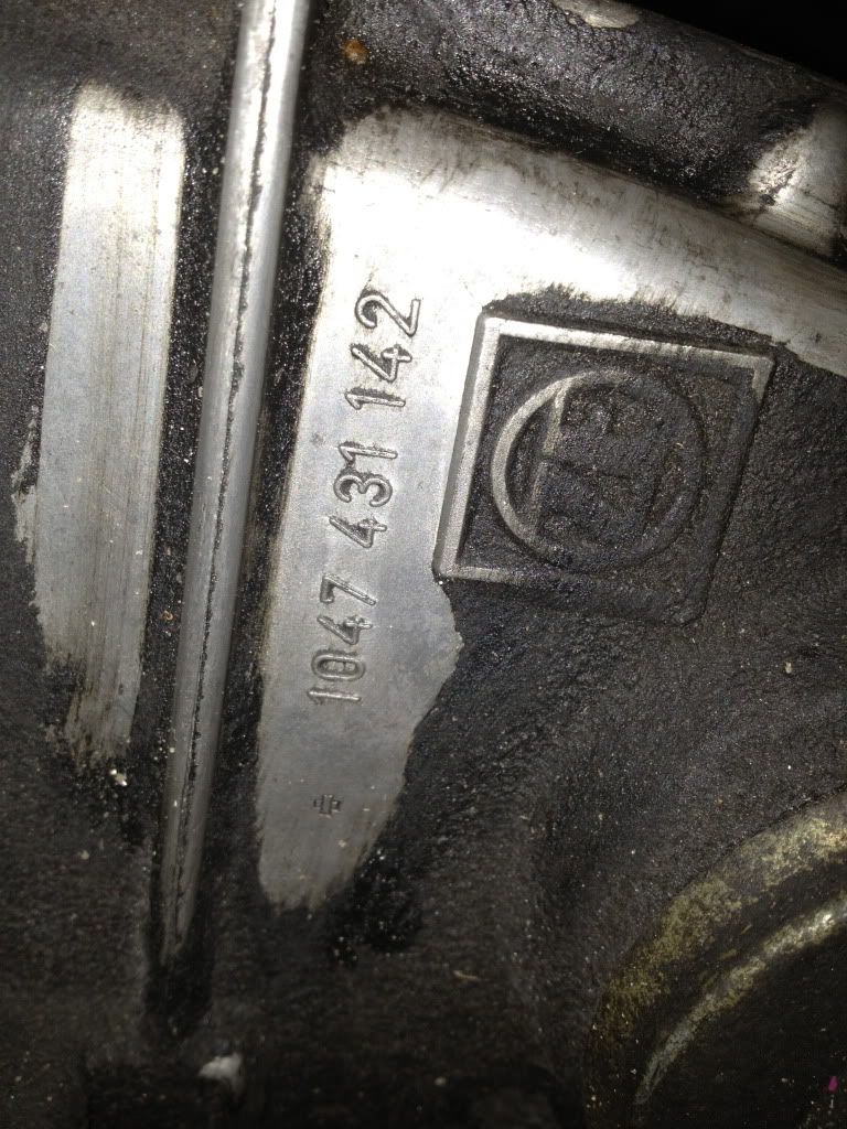

One of the numbers on the tcase near the output shaft to the front diff.
