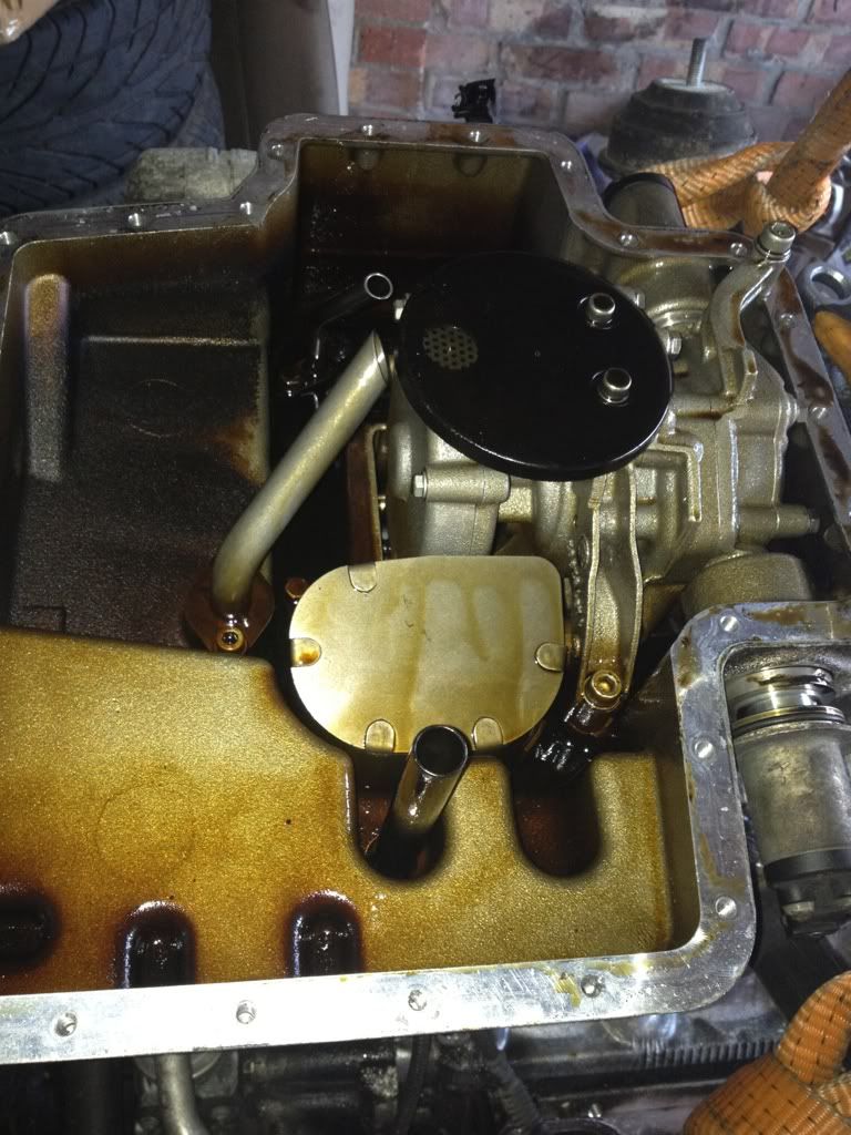

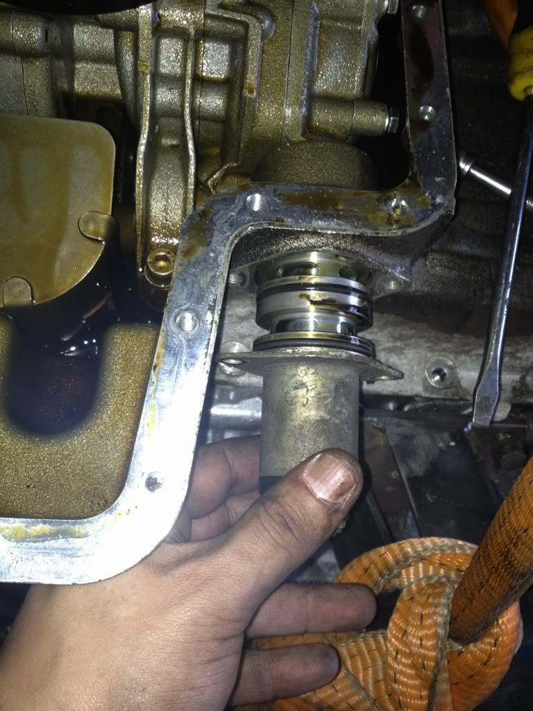

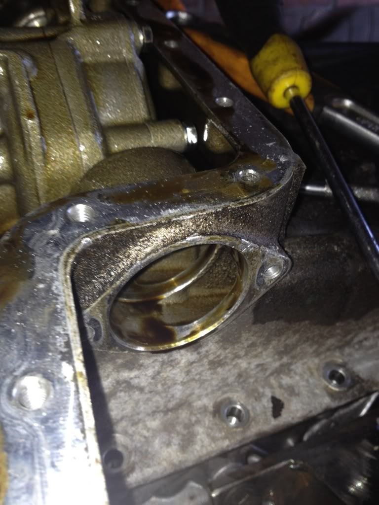

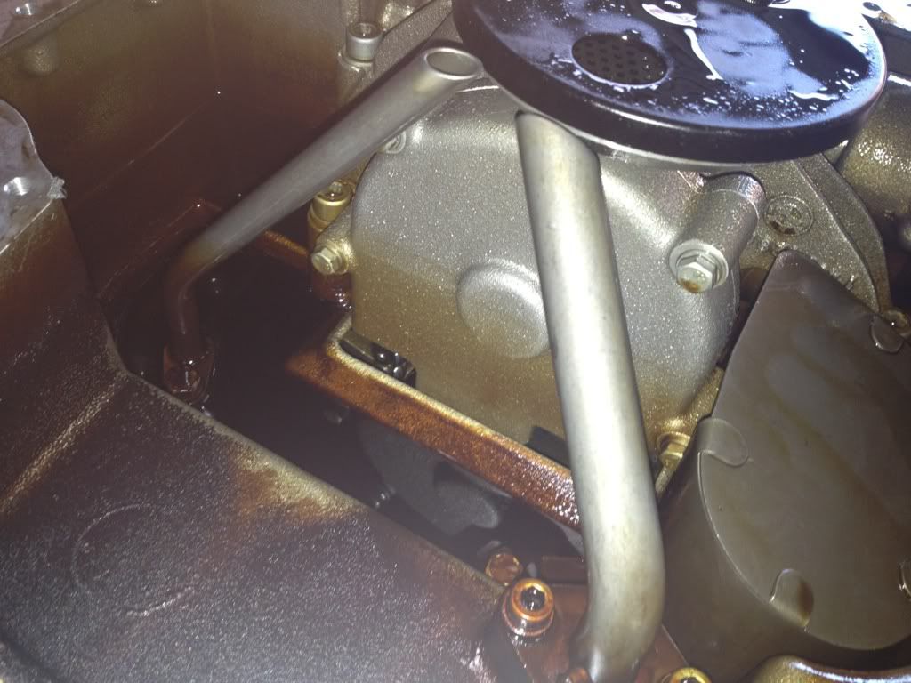

    Ok, putting the Tcase issues aside for a moment, I flipped the engine over today and started taking the sump off, The m5 has a 2x part sump (upper and lower) the lower one has to come off first as the bolts holding the oil pump in also hold the upper sump in around 4 locations from why I can tell.
    The Magnetic sump oil guide switches had to come out first, I will have to discard these if the x5 sump is infact used (99%) The functionality of these will be programmed out by my ecu guy. He has confirmed its easily done and with the lack of the chassis accelerometer (g-meter) we don't think the system of selective oil pumping would work anyways.
    some interesting oil channels leading to shallow part of sump.
    I haven't yet removed the oil pump, as i just wanted to enquire as to whether or not the m5 oil pump will fit the x5 pan?
    I can see there is a cover over the chain and i can envisage a single nut under there holding the sprocket in place (just like the 24V swaps) Im hoping the sprocket can also be used. I will chuck a cable tie on the chain to make sure it doesn't jump a tooth or anything, Not sure if the chain position effects the oil pump but better safe then sorry.
