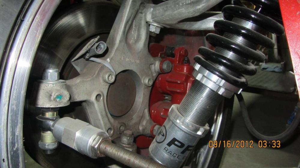

            Updates??? THis is a really cool project that needs to be out terrorizing quattro Audis and such.
            On the note of bump steer, I wouldn't freak out about moving the rack a small amount. Fit the part where it fits.
            Does somebody not make a bump steer adjustable rod end, something like what I'm running on my truck with C5 corvette suspension? I narrowed the front end of my truck 6 inches and just got a narrower rack (flaming river xl) and those adjusters in the pic... I pulled the spring off the coilover and went through the range of motion with a jack under the hub, and played with the shims until the toe didn't change any noticeable amount.
            My truck drives fine and doesn't do anything super weird in the bumps. I built the frame completely from scratch and didn't do any CAD modeling or any of that ...

                #337
                Fix to bumbsteer problem
