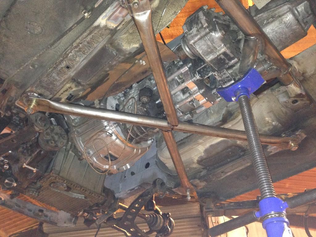

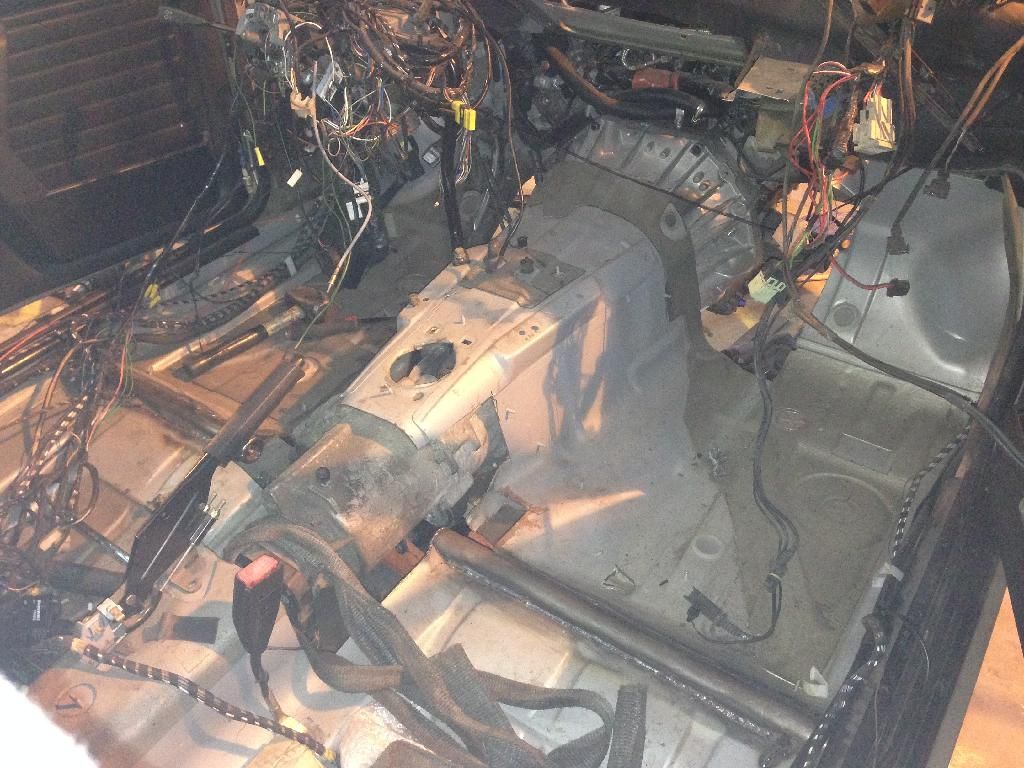

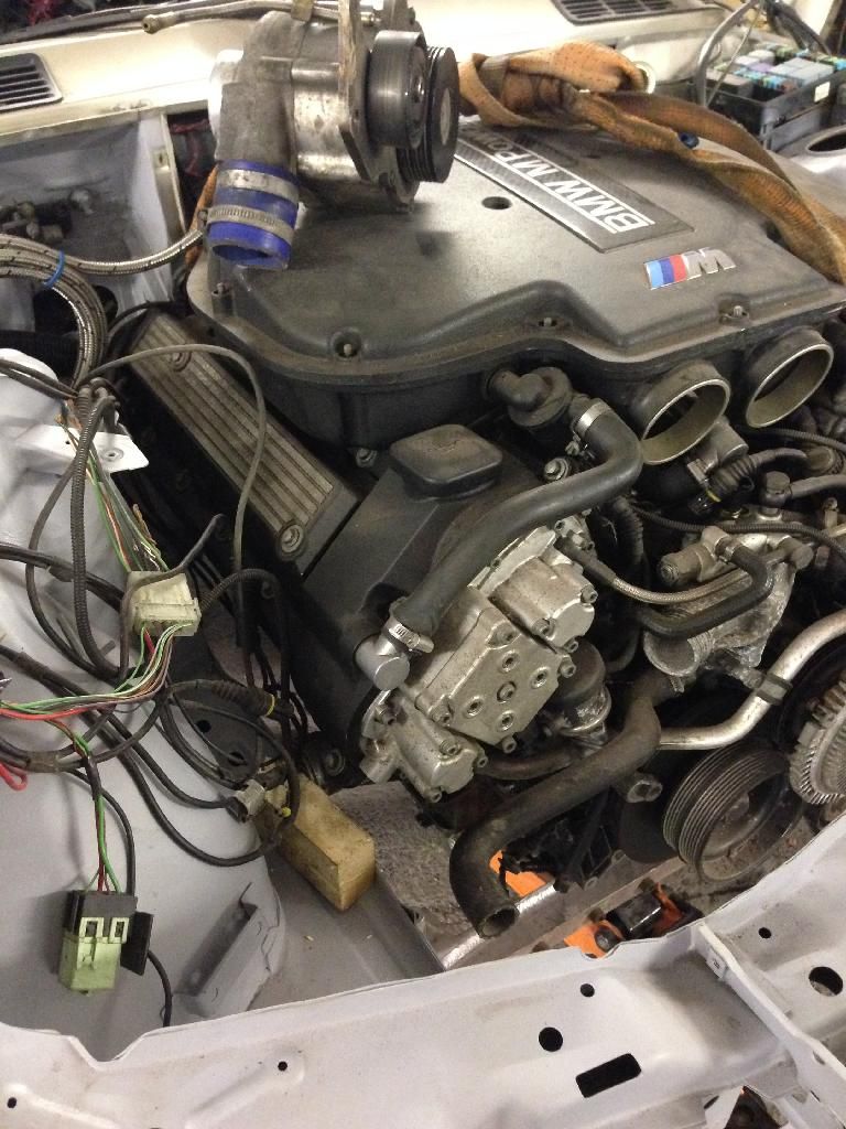

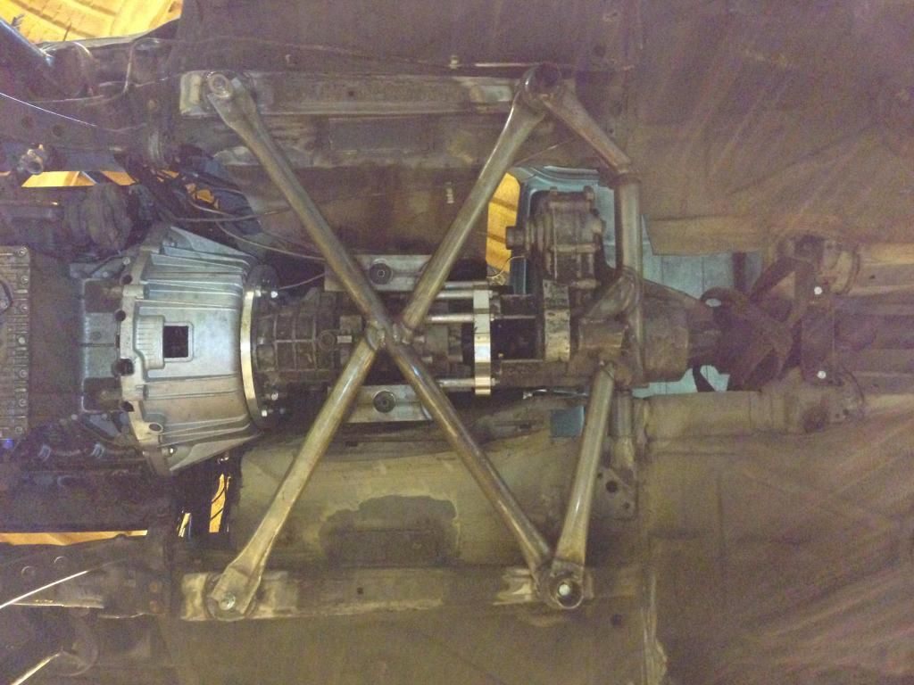

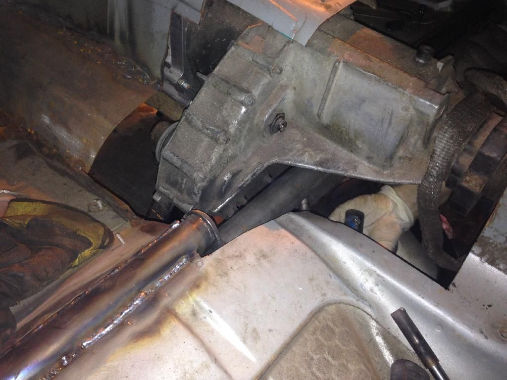

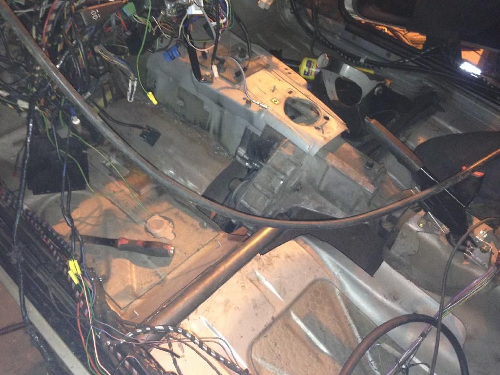

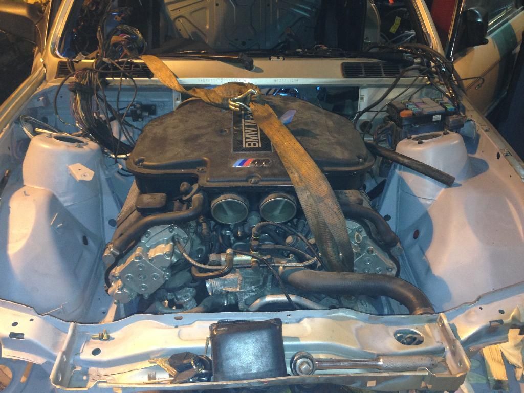

So, To recap, S62, X5 sump, diff, etc, e30 chassis, Custom interface plates between v8 bell housing and getrag 265 box, e34 Tcase controlled by a simple potentiometer to allow manual control of... grip (or lack of :) )
Now I have found some additional parts.... Which will no doubt cause more headaches!!! :D

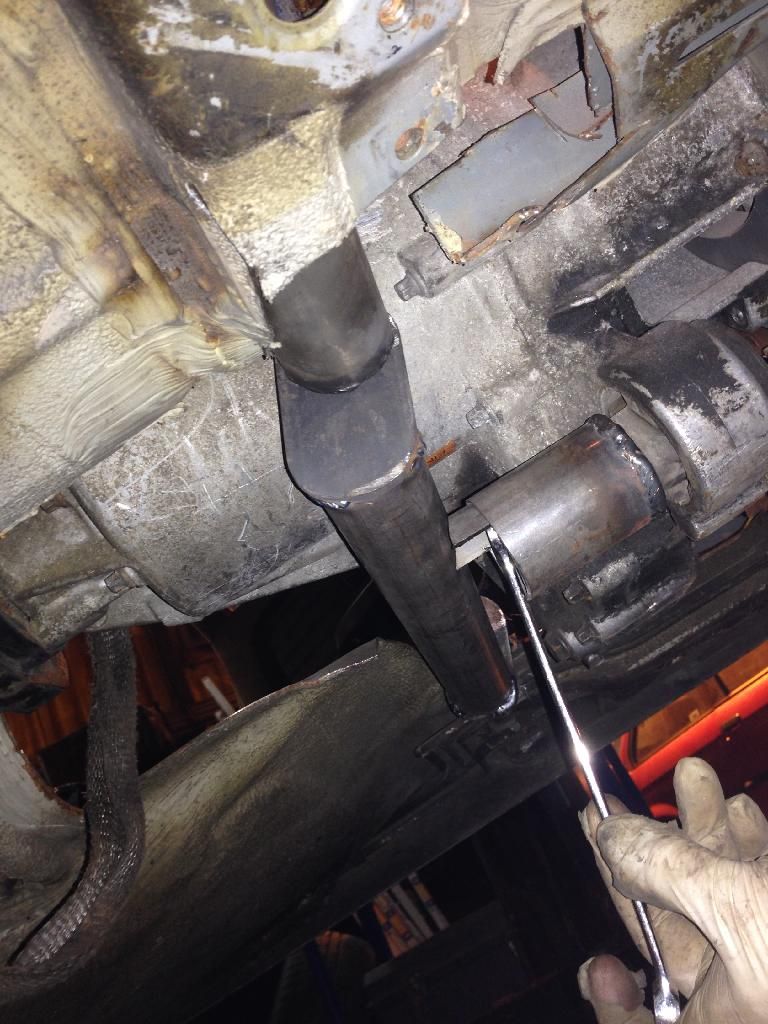

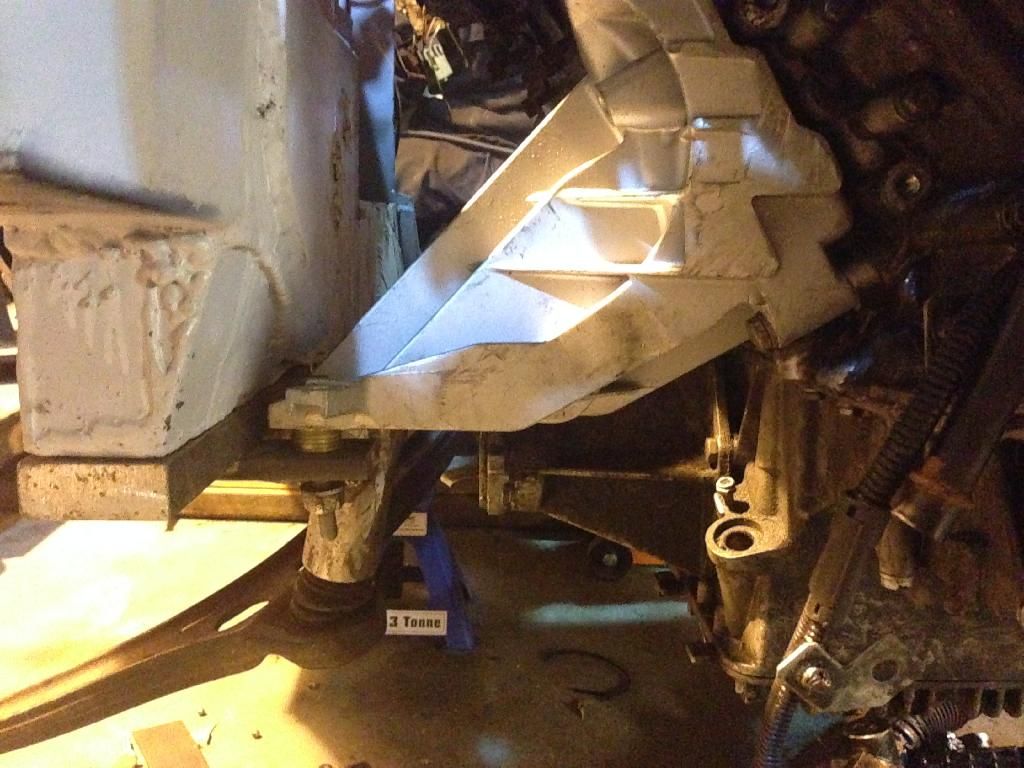

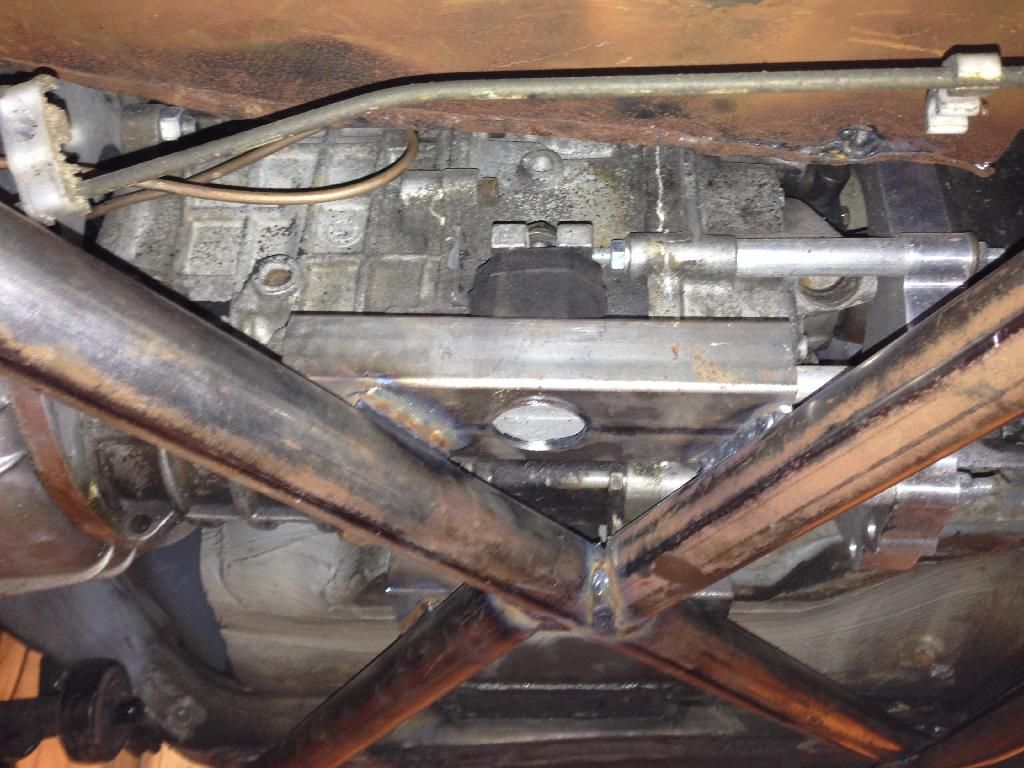

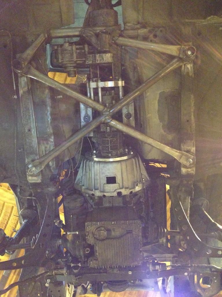

The chopped up subframe from previous pages was good, but just didnt give enough space for the steering.

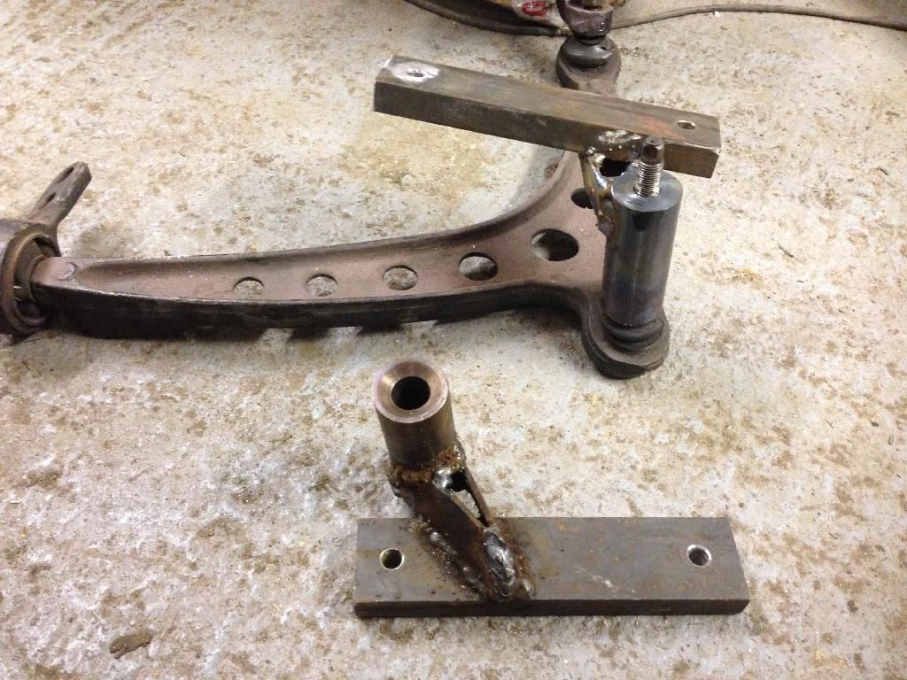

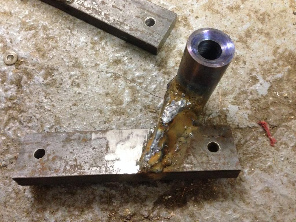

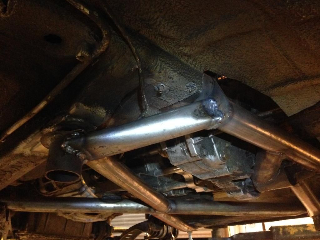

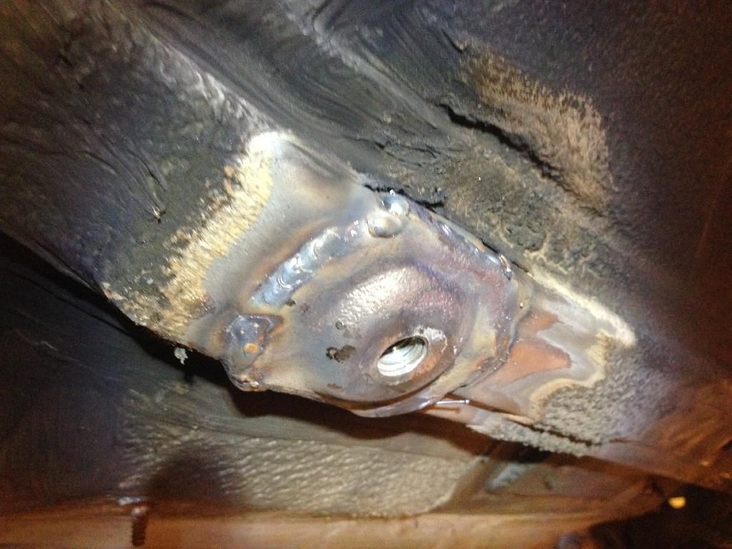

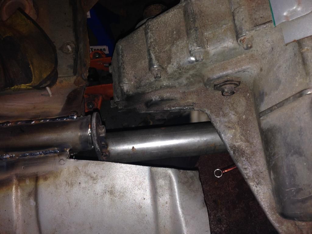

So, seeing as we're mounting the engine off the chassis, we made these:
The idea being these will locate the wishbone ball joints, roll bar mount, and will be the anchor points for a sturdy bent tube custom subframe which we'll mount the steering rack off of.

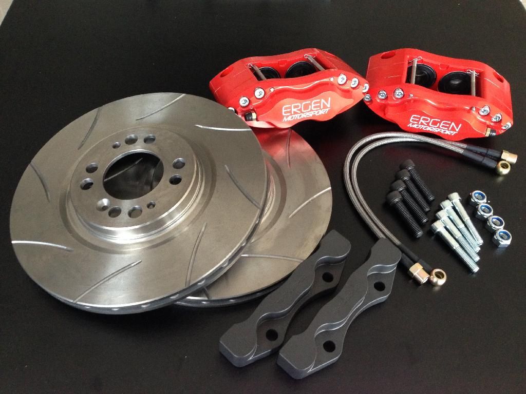

We'll also be using one of new BBK's to stop the thing :)
We have a lot more on the way :) As always if you have any ideas or spot any mistakes let us know!
