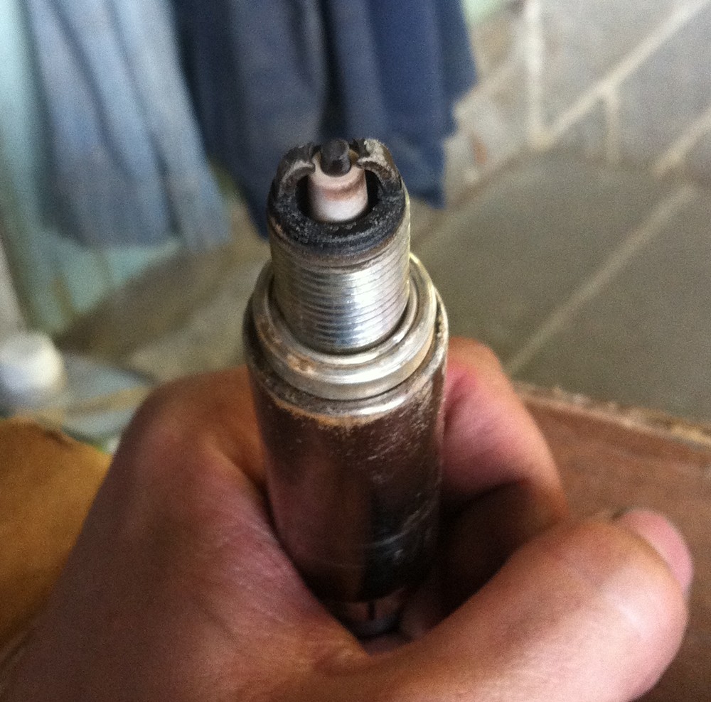

    Checked plugs, all of them basically look like this:

          The spark plug doesn't look horrible but definitely shows signs of running a little rich.
          Thought may a leaky injector but.. have you done a recent compression test on this engine?
          This is how I found out my S50 had lower than normal compression. Just enough to start but it would randomly miss at idle and idle very low, but anything above 1000rpm would rev beautifully but the power would drop when moving the car.

            The plugs have also been in there since the first time I fired this engine up, when the coolant sensor was unplugged, the CPS was bad, etc... so I guess it's not a fair representation of how it's currently running...
