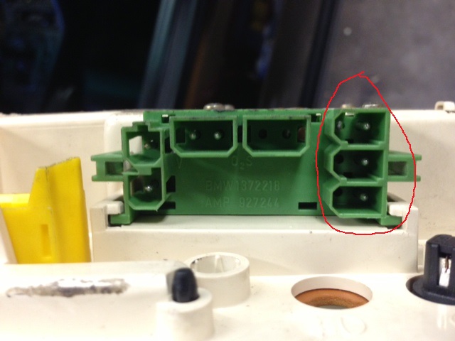

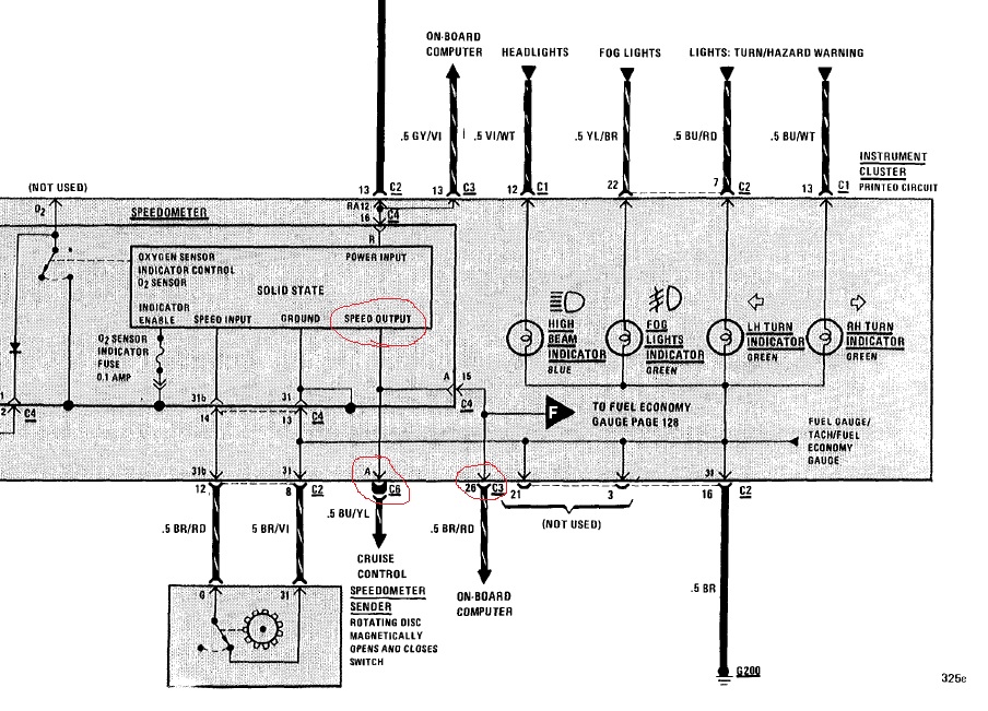

                    My buddy came over with the Autologic scanner. All seemed well except for one thing.
                    Question: Where do you have your road speed signal hooked up to? Pin 14 on the x20 is road speed signal. It should go to the cluster. I have it hooked up to one of the three pins below (they are all the same, they all have continuity)
                    However, with the Autologic scanner hooked up, my road speed signal was wrong. It read based off of engine RPM instead of my actual road speed. It read 40 km/h at idle, with the car not moving, and shot up to like 300 km/h at redline. When driving, the actual road speed had no effect on DME's road speed. It seems as though Motronic uses RPM as a 'backup' to do the calculation, although I'm not sure how it assumes what gear you'd be in, unless it's an auto. My DME is from an auto...
                    My speedometer works, so the road speed signal to my cluster is good. And I swapped clusters, with another known good one, and the Autologic still read incorrectly. I checked continuity from the road speed wire, from the end connecting to the cluster to the end connected to the DME, no resistance. And I've tried multiple DME's.
                    So either I am wrong in pulling road speed signal from there, or the Autologic is not reading it properly. Weird thing is, I'm not getting a code for a missing speed signal, even if I unplug that wire to the cluster. I did get it once in the past though when messing with stuff, but I don't remember what triggered it.

                      #100
                      Should be in pin 1 of the green C6 plug. At least that's what the ETM says. I'm pretty sure all three positions do VSS output though.

                        #101
                        Does your idle stay around 800-900ish when the vehicle is coasting in neutral then slowly fall to 600 when it is stopped? Mine does, it's seems like the only thing the VSS input to the DME does. Did your engine harness have the plug for the gear switch thing too? I guess it tells the DME that the car is in gear? (1-5/6) does not actually know what gear it is in, just closes a switch when not in neutral.
                        The idle bounces around a bit when coasting in neutral. Not severely, but noticeable, maybe 600-800 rpm? It sits at 500-600 at idle.
                        I'm not aware of that connector. The only thing hooked to my trans is the reverse light connector. There is a few extra connectors on the harness, which I left alone.

                            #103
                            Great that you have finally found (at least to some extent) the solution for the problem!
                            Some backfiring seems to be quite normal (because of the missing cats?) with M60's, at least both of the M6x E30's I've done backfire a bit when getting back on gas after letting the gas earlier. Nothing serious, they have been tuned at dyno and work exactly as they should. At least I like the sound on my cabrio, gives it bit more grunt :)
                            Now as you mention it, that backfiring doesn't exist in E32 / E34 / E38 / E39's - so it's really quite a mysterious thing altogether..
                            You take the speed-signal from wrong place. The INPUT signal to instrument cluster comes from sensor in differential, but you need the OUTPUT signal (e.g. from OBC connector, can be seen in the schematics) from the instrument cluster. To my understanding these two signals are different, which would explain why your DME is not getting it and thus doesn't work correctly..

                              #104
                              According to the schematics, that green plug on the cluster is the an output from the cluster. That's where the cruise control gets it's signal, and it's also directly connected to pin 26 on the yellow connector (OBC).
                              C3 is the yellow connector. C6 is the green connector, and the 3 pins that provide VSS are labeled 'A' on the connector.
