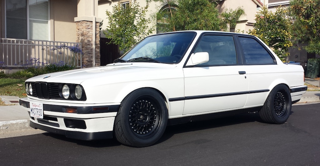

      Also I'm in the mind set to get a nice set of 225/50R16 tyres for JNC
      looking for a nice Tack setup "look"
      This tought is also brought on by the fact that the setup i currently have is pretty old and dry.
      plus I can't hookup at all... v8 torque problem..
      this is my current setup
      205/50R16
      these are 225/50R16 But this is the look I want.... :devil:
      whats say you...?

        Track width doesn't matter, you just need two strings parallel and equidistant to the center line of the car.
        For tires, i think 225/45/16 would be my choice.

          I agree. 225/45r16 would be the perfect tire!! I ran these on my Rotas before someone decided they needed them more than I did!!! No fitment issues with them.
