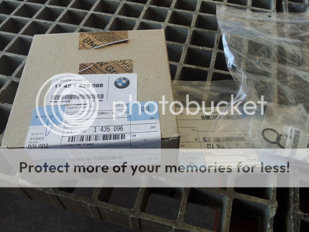

yes on maintenance im changing every seal,gasket(not head gasket), o-ring and guides and chains.then imma do the m60 plenum.

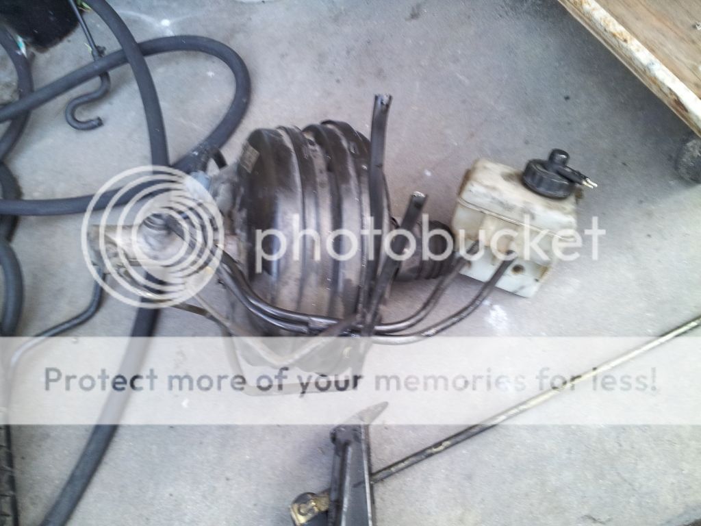

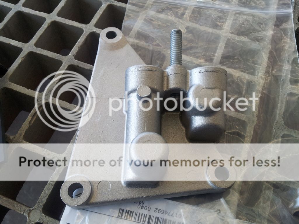

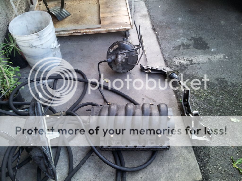

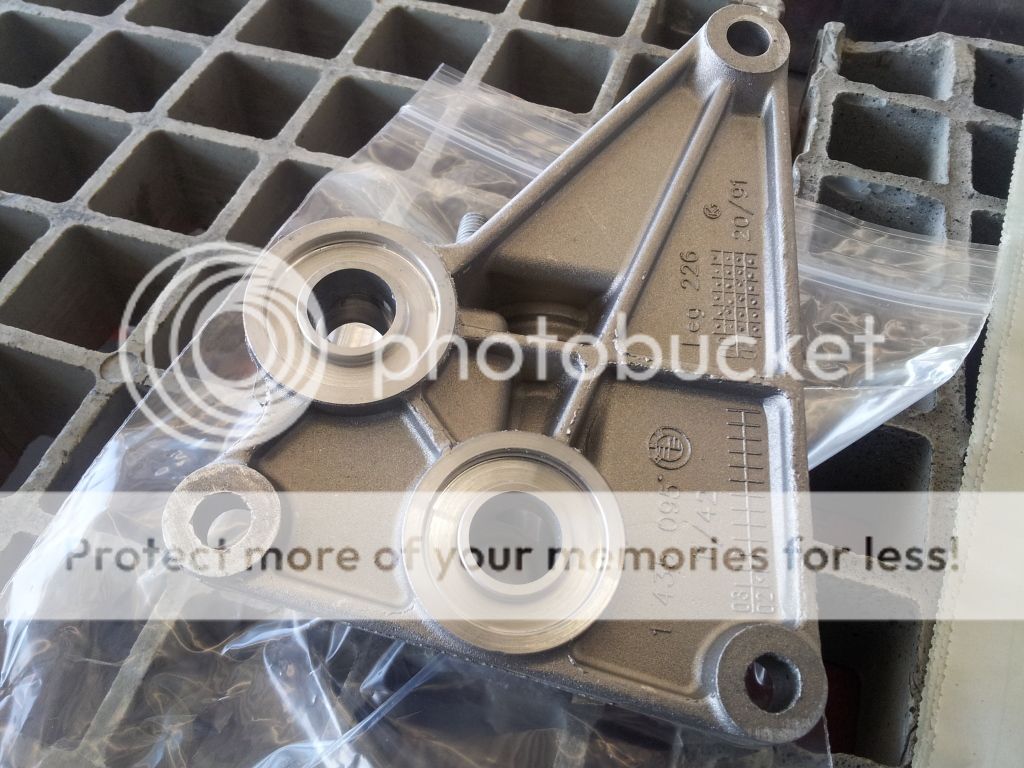

more parts :) OBD 1 manifold gotta read up on how to make it work LOL and then i gotta some how mock the brake set up and make some custom links.anyways list of parts
E34 Brake Booster with brackets and misc stuff.
E34 Expansion tank
OBD1 Manifold for more POWAHHHHH

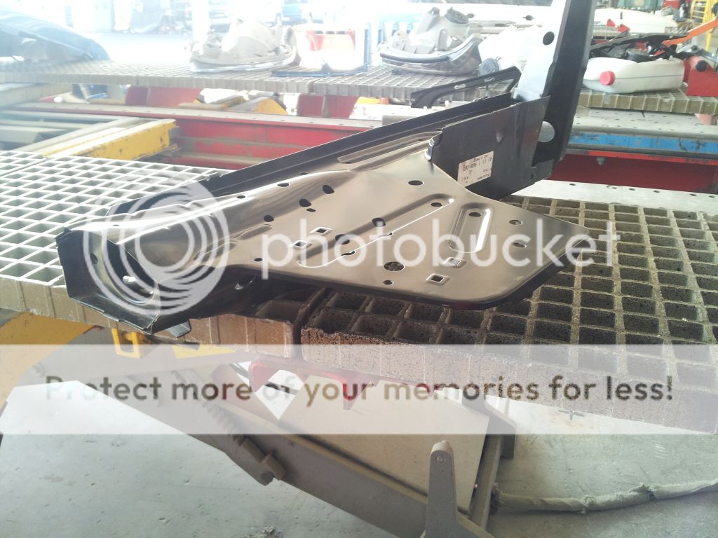

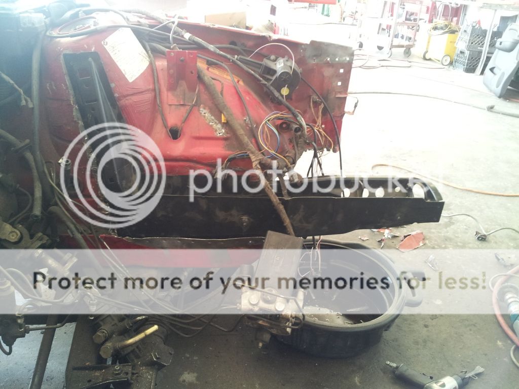

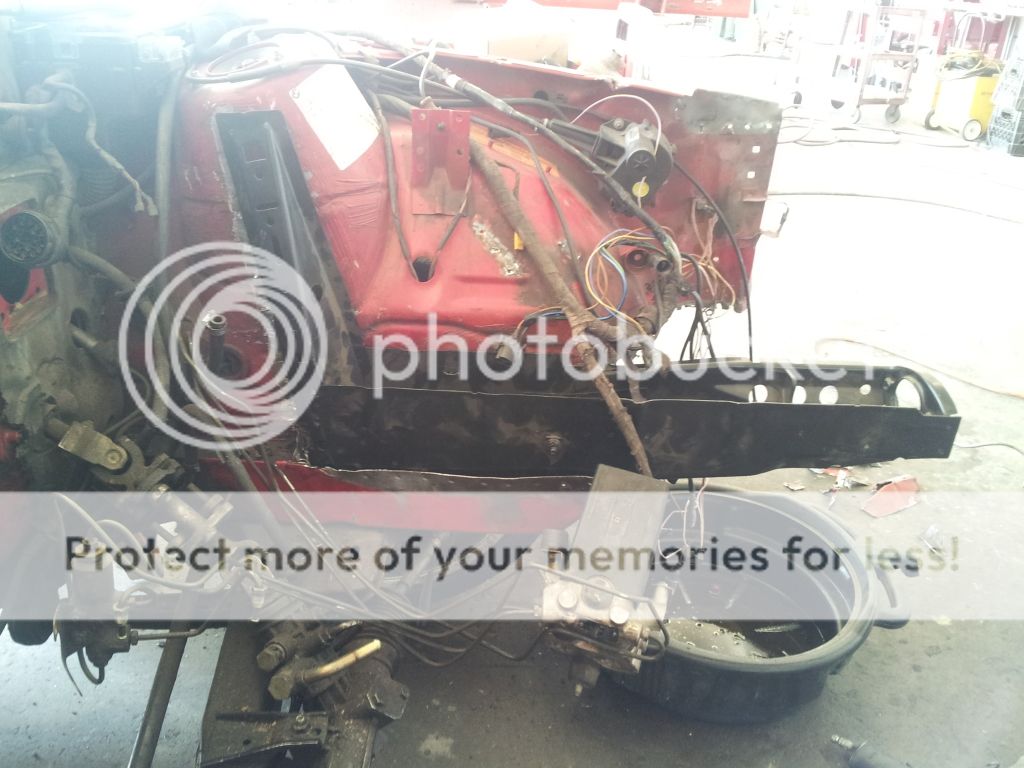

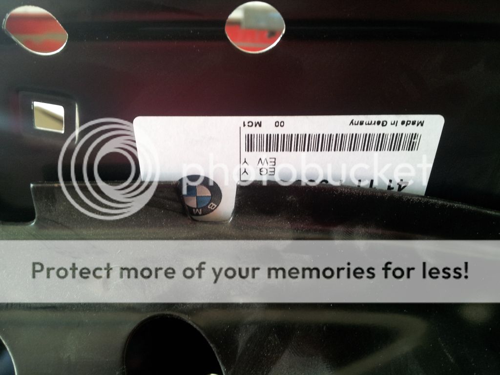

cover plate that completes my front frame rail came in today from BMW/Gmbh.oh and i got the key ring coil to power up and the ews and the dme its all working but can get it to start cuz i gotta by pass it to make it think it has a trans since the dme is out of a auto (740iL) anyways i should get it started by the end of october
nothing?I BUY/SELL REFURBISHED CM5907s & CM5908s
