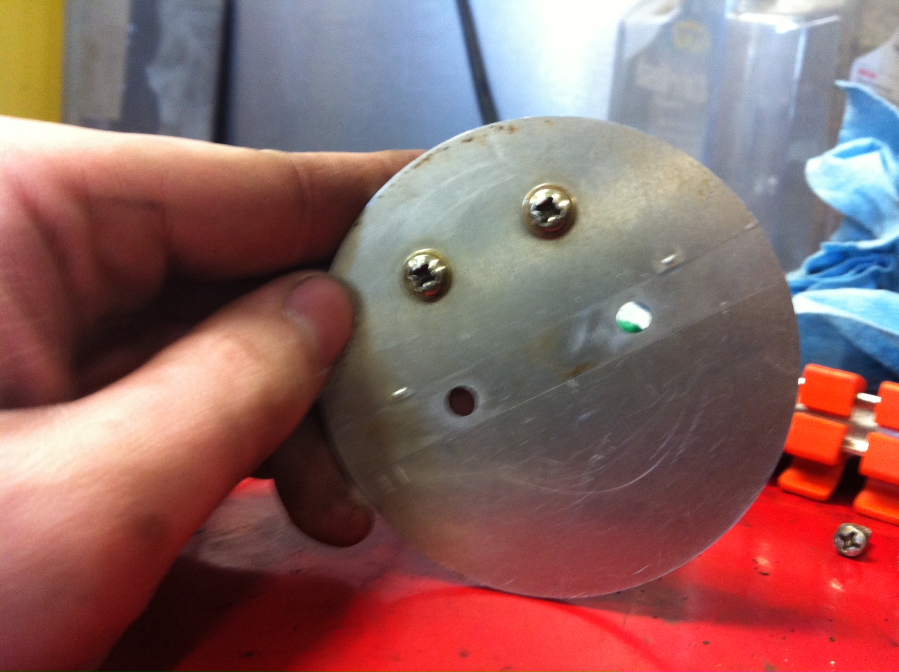

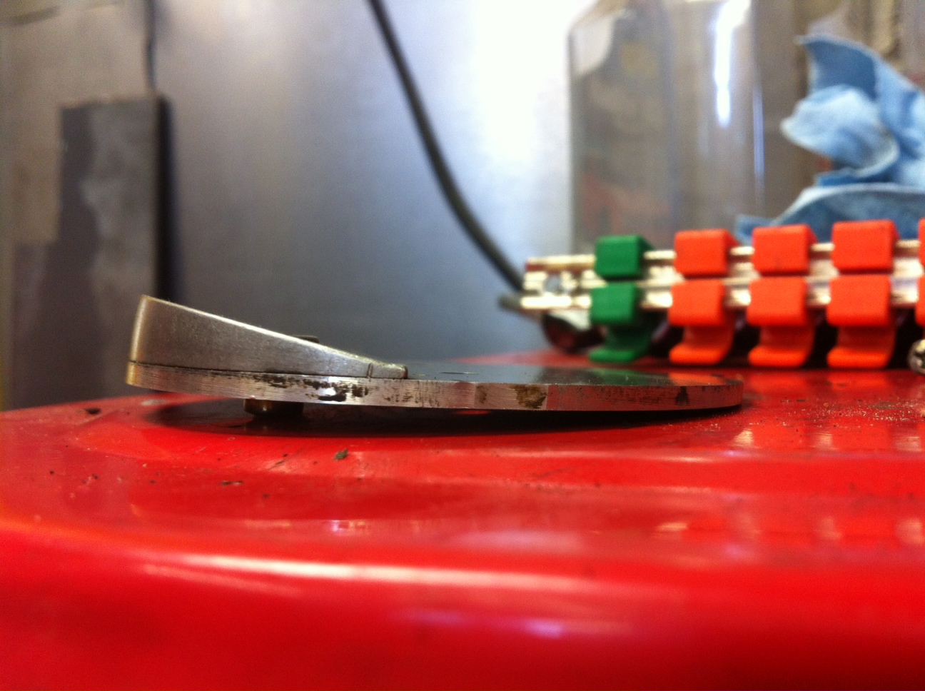

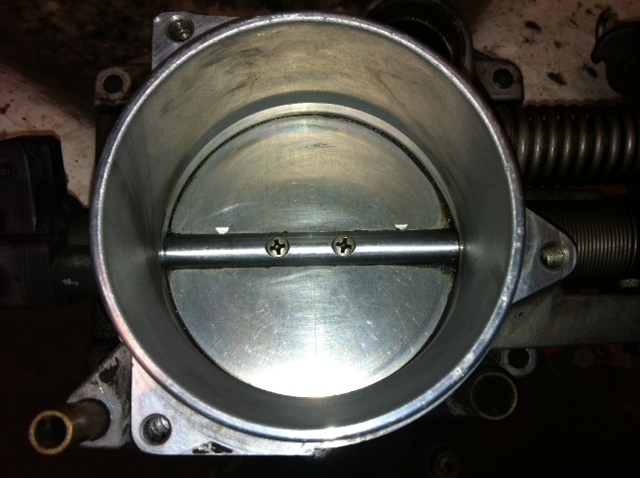

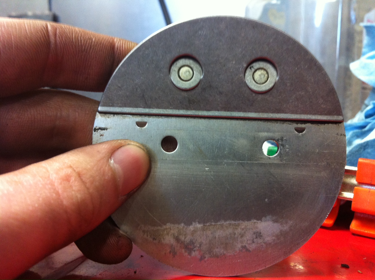

    Then, there are some throttle body differences. I *think* all m60b40 throttle bodies have a wedge installed, with the purpose of limiting airflow when first cracking open the throttle, to sort of tame the engine from it's throttle response, to prevent lurching off idle. This is fine, but it adds about 3x the thickness to the throttle plate, which would create some turbulence and limit flow a bit.
    I think all m62b44 (non vanos) engines come with a normal flat plate throttle body, of the same size, that bolts right on (since it's the same intake manifold. I'm still working on verifying this.
    I tried to pull the ACS throttle plate off and swap it with the actual throttle body plate, but the 2 mounting holes don't line up.

          Ordered an m62b44 (non-vanos) throttle body. It arrived today, no wedge installed. Otherwise it's identical to the m60 TB. I'm not expecting it to be a huge improvement, but every little bit helps. And for the price, there's no reason not to.

                              -Intake from an early m60 and early m62 non-vanos appear identical on the outside even have the same part #. Fuel rail is different (m60 has fpr)
                              -1992 m60 e32 intake is the 'good' one w/ horns but also has wedged throttle plate
                              -1998 m62 intake has no horns with good (flat) throttle plate
