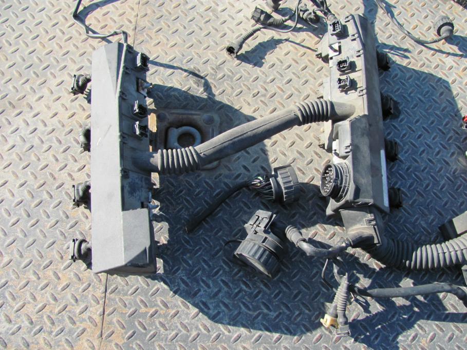

  • driftingminor913
    replied
    Could I use my M62 harness? N just take something out of it?
    Leave a comment:
  • Jean
    replied
    Originally posted by driftingminor913
    What's the difference from the m60 & m62 harness?
    Lots.... get another harness.
    Leave a comment:
  • Vtec?lol
    replied
    The m62 harness goes straight to the electronics box and has no connector for anolog chassis control (x20) which is what you have. That harness is for can-bus systems.
    That's not compatible at all with the swap. Whoever gave it to you lied.
    Leave a comment:
  • driftingminor913
    replied
    Originally posted by JGood
    That's not an m60 harness, that's an m62 harness.
    Leave a comment:
  • Jean
    replied
    driftingminor913 - That's not it, it should be on the plastic housing itself on the e32/e34 harness like this below (it's most likely going to be 25 pin, not 20 pin btw)
    Leave a comment:
  • JGood
    replied
    Leave a comment:
  • driftingminor913
    replied
    Does anyone know what this connector is called?? I'm having trouble figuring out what this is. I was told it was pulled out of a Manual 94 530i E34 but I know that the 94 e34's had a x20 (circle plug) and this harness doesn't have that as you can see its a rectangular plug...
    And like I said there is no circle plug on the harness other then the diagnostic plug

  • driftingminor913
    replied
    Ok I will try, n also I think I found my X20 harness connector....but it's not a circle like the rest it's a square one? Anyways I thinks it's a tad bit easier since it doesn't have to many wires running thorough it.

  • driftingminor913
    replied
    Installed injectors today
    Coming together soon! Ordered more things, trying to get the most power out of this this I can.
    An this is my b30 harness
    o
