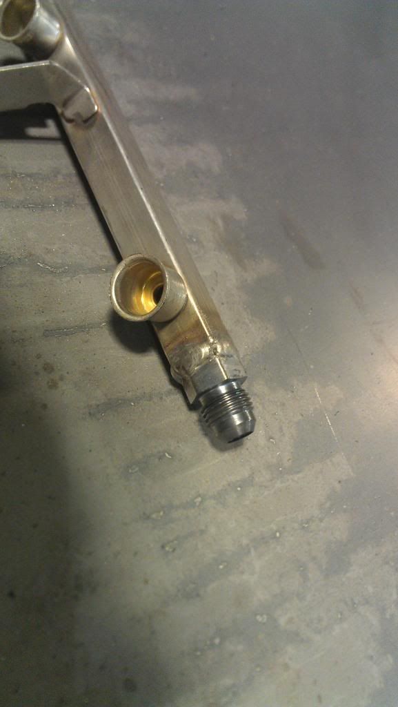

                            Front subframe
                            Notice how the engine mounts were destroyed... Instead of using the akg or similar repair kit, I had 4 plates cut. I installed two as per usual, and then two more on top, welded inside and outside. That will reinforce the subframe, plus, will give me a touch more clearance for the Z3 rack I have installed. It now bolts on no problem, and I can install it as high as it goes (more on that later...)
                            S62 fuel rails, ready to go!
