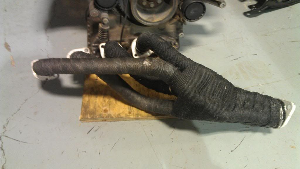

              Almost finished with the headers...
              I'll get the other side done tomorrow. Maybe

                Well dam you for making good headers, hopefully line will turn out okay :-/
                Because V8
                http://www.r3vlimited.com/board/showthread.php?t=282219
                Doing it wrong since 91:wgaf:

                  My first AND last pair of headers..., trust me. And you should have seen the first attempts!!
