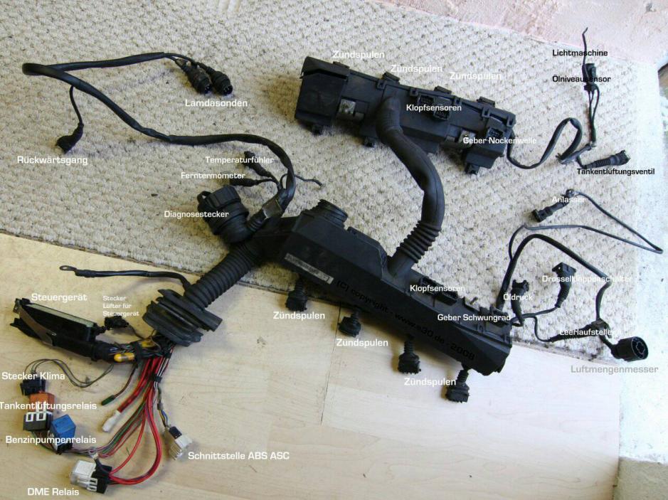

    Here is what I did find, hopefully I don't screw this harness up too badly. My German isn't great...

      There are no modifications required to use an auto e34/e32 harness on an m60 with a manual trans. The extra wiring takes up a tad bit more space, but has no effect on anything.
      I have no idea what's in that picture. It's not an m60 engine harness though.

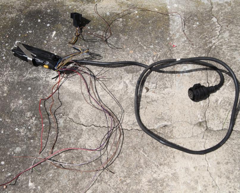

        Thanks JGood. The items in the picture are the part of the harness that run to the transmission control unit, to the transmission itself and to some other box.
        I've looked through the electrical diagrams for the 530i and have identified what could be removed.
        While nothing needs to go, I like the clean look of no "extra" connectors etc.

                              Bumping an old thread in hopes of getting some clarification. I'm in the process of cleaning up my engine wiring harness. Its from a 95 540iA but I want to get rid of all the auto transmission wiring. Here is what I have
                              So from the photo, here are my descriptions and questions on what I can do with this:
                              A) Auto Transmission Control Unit
                              B) Engine Control Unit
                              C) From what I read above, this is the ABS. Half of the wires go into A, the other half go into B.
                              D) I think this is the ASC+T but not sure. All of the wires go into A.
                              E) No idea what this is and what I should do with it.
                              F) Relay
                              G) Relay
                              H) Relay
                              I) Relay and plug holder
                              So it appears my relays are differently colored than described above. Can anyone tell me what each relay is for? Also is the relay and plug holder necessary or can I just detach the relays from that and remove it? It doesnt appear to be in the pictures above.
                              As for removing all the auto transmission wiring, am I safe just to cut all the wires that go to the TCU and tape them off, or what is the best way? What do I do with the wires that go from the TCU to the ECU or any of the other wires that are spidered into the main engine harness?
                              Sorry for the noob question but i'm not the greatest with electrical and dont want to mess up my harness. Any input is appreciated!
