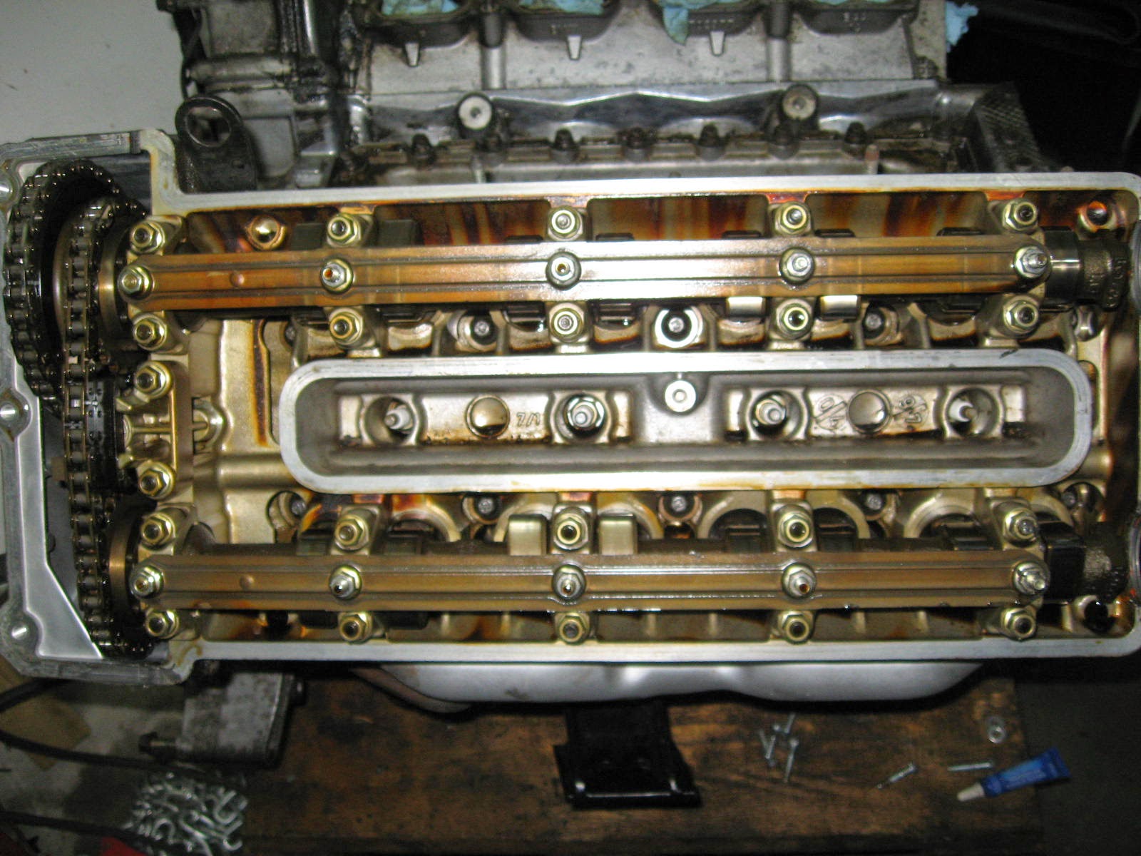

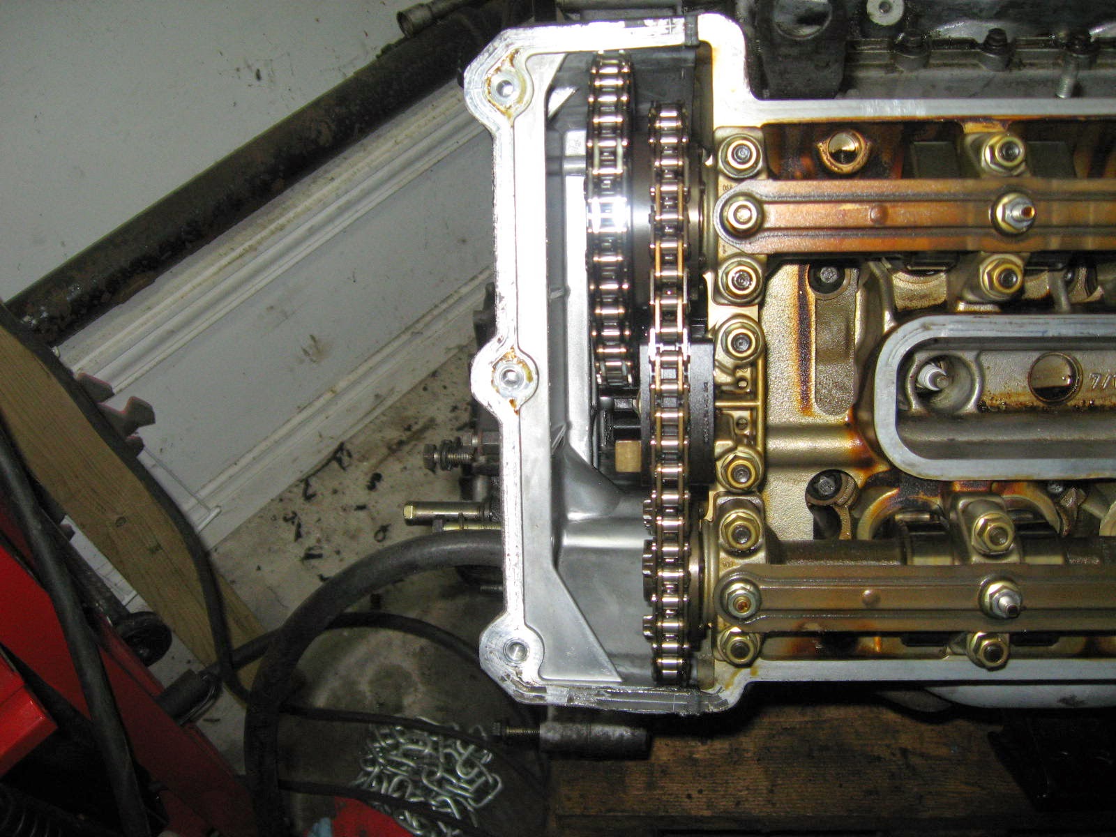

    Time to dig in the engine....
    Looks like oil changes where done :)
    going to be very busy
    I ordered an E39 M5 clutch to go with my 540 six speed...it just needs a cleanup but almost ready to go
    engine bay starting to take shape....also adjusted the brake booster bar it clears very nicely
    Valleypan going to get the URO with the new viton gasket
    lot more to come..should have the engine in permanently in january
