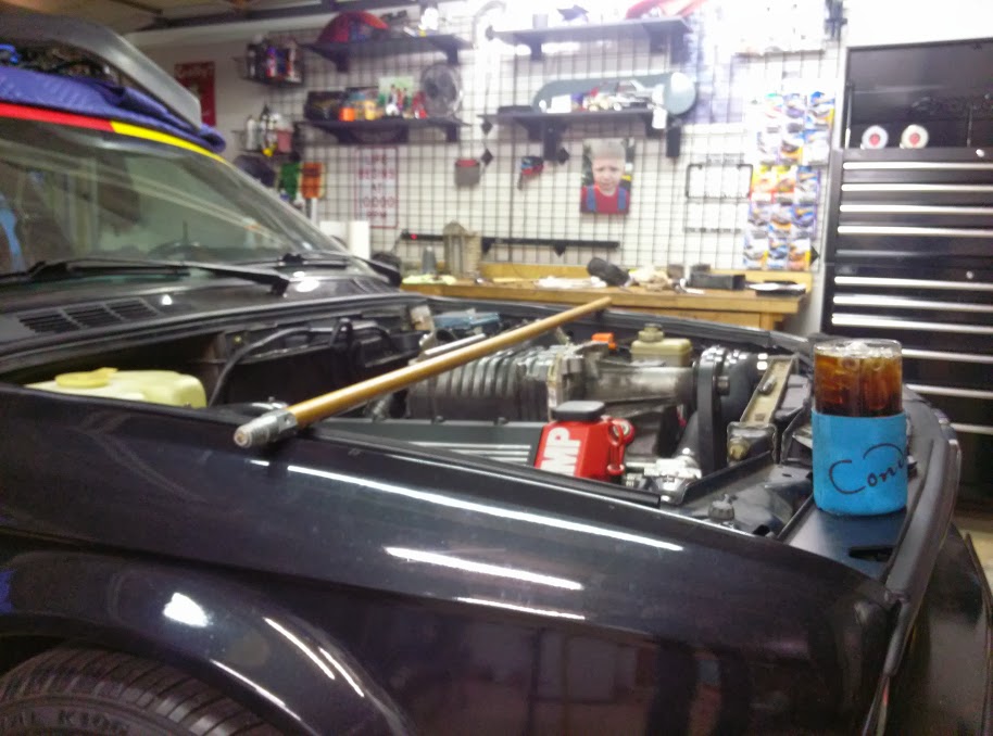

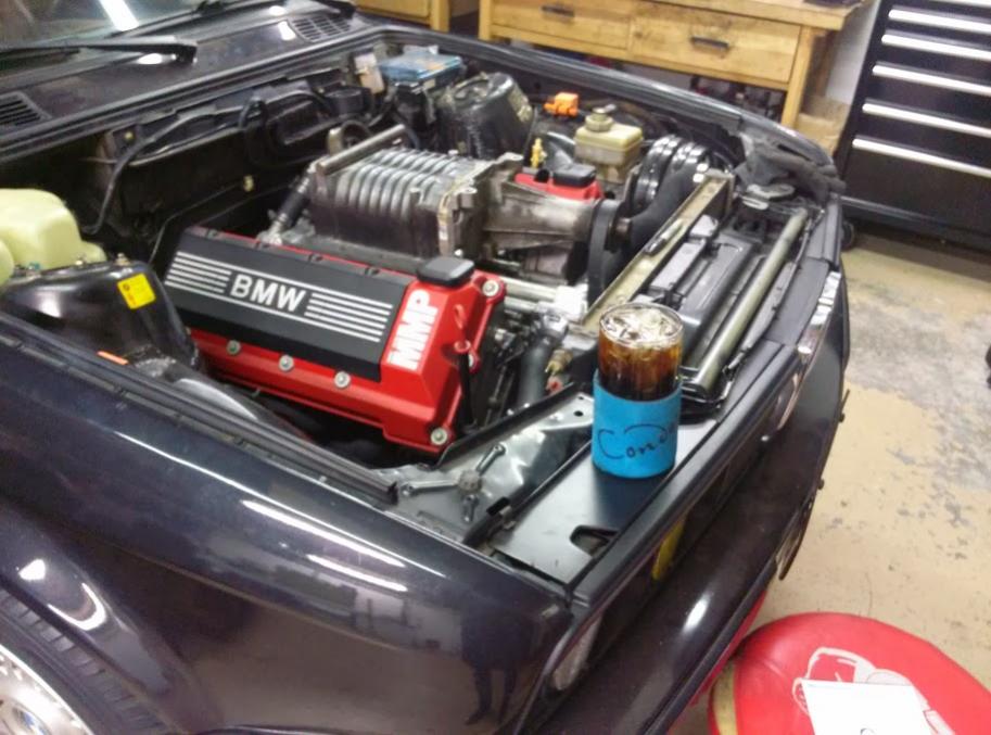

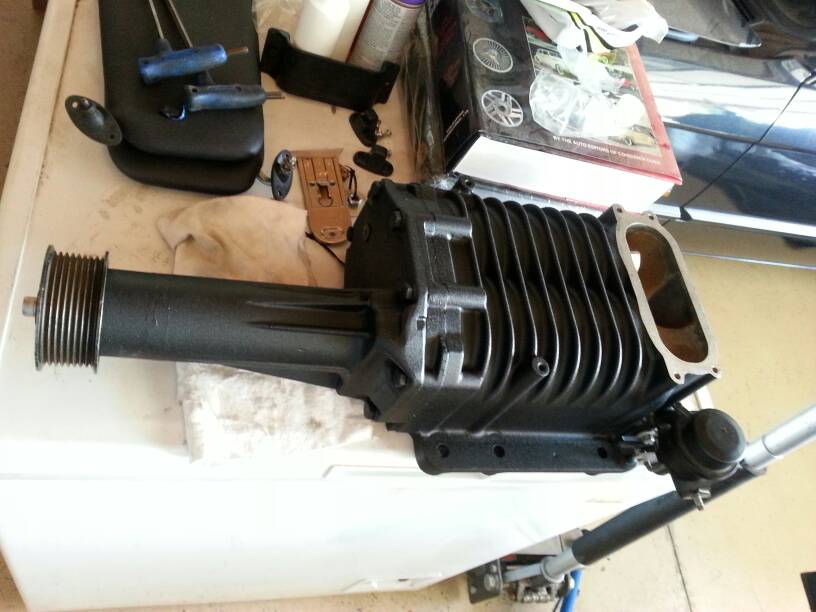

                This is my plan, Currently working on the manifold design. Shouldn't too tough thou
                This is my M112 Hybrid I built is using a Jag snout and a Lightning SVT body.
                you see can the whole build of it in my build thread.

                        In my research, I don't think the Jag setup will fit an M60 e30. Too tall, with the W/A intercoolers, and has a rear throttle....which would def interfere with the fire wall.
                        Better off running a centrifugal.

                              That's just the snout.
                              Jag setup is a really nicely packaged SC with W/A intercoolers for each bank.
