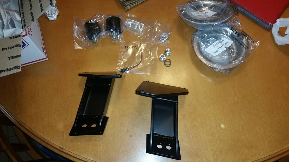

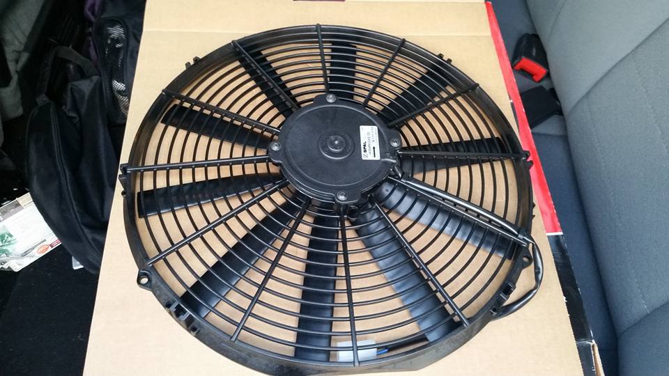

    ok, because of another shed of tools user in the forsale section, I got a mandatory 2 week vacation. During that time, I made a road trip to Cali, and ended up staying about 20 minutes from Garagistic's shop. So I made arrangements to pick up what was done of my order. They are shipping the rest when it's done.
    Spal Fan
    Driveshaft
    Engine mount arms, 95a poly Tranny mounts, Tach Signal splitter, Power steering delete, E90 drop hats, and Throttle bushings.
    I'm still waiting for the Exhaust manifolds, 95a poly Engine mounts, 6 speed tranny mount extensions, and another Camber/toe correction kit. I'm hoping they will show soon.

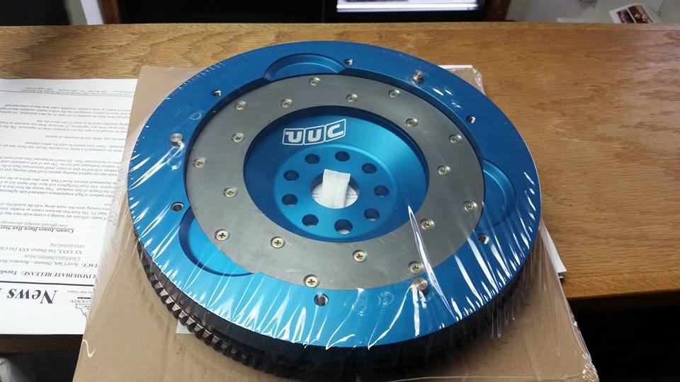

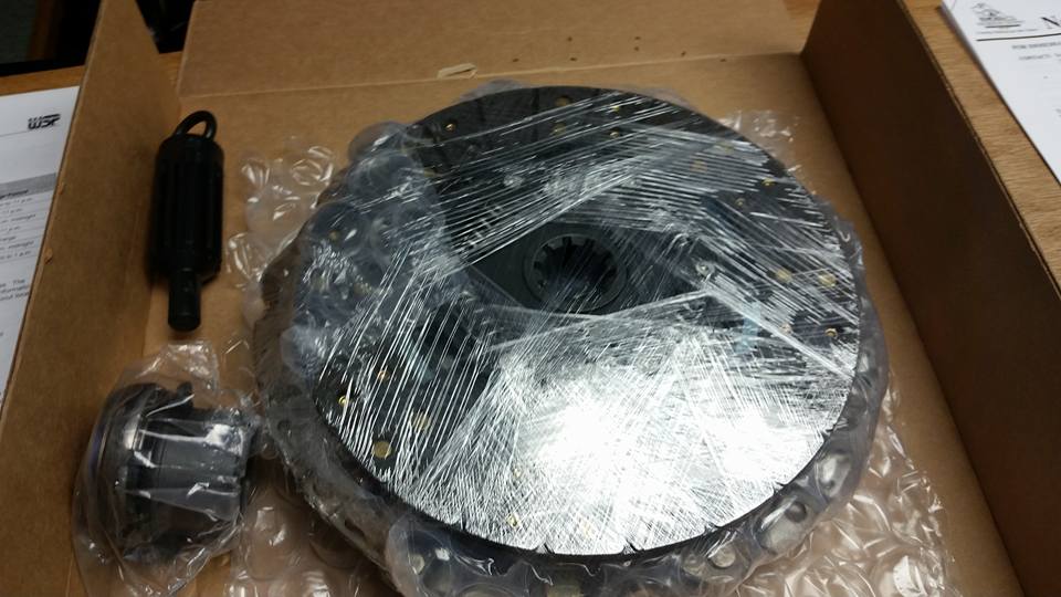

    Parts have started flowing in.....
