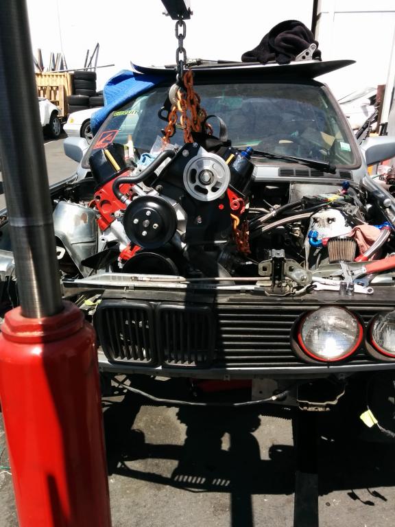

    e30 5.0 turbo (Drift project)

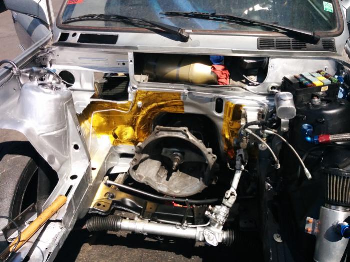

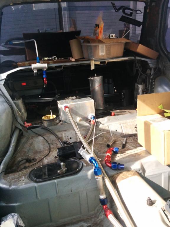

    First of all, THANK YOU VERY MUCH to all you guys who helped me with my "stupid" questions and some other not so stupid, but anyway. Thank you guys and thank r3evlimited for the platform. The car is 90% done and im taking care of small adjustments and gremlins. Here it goes

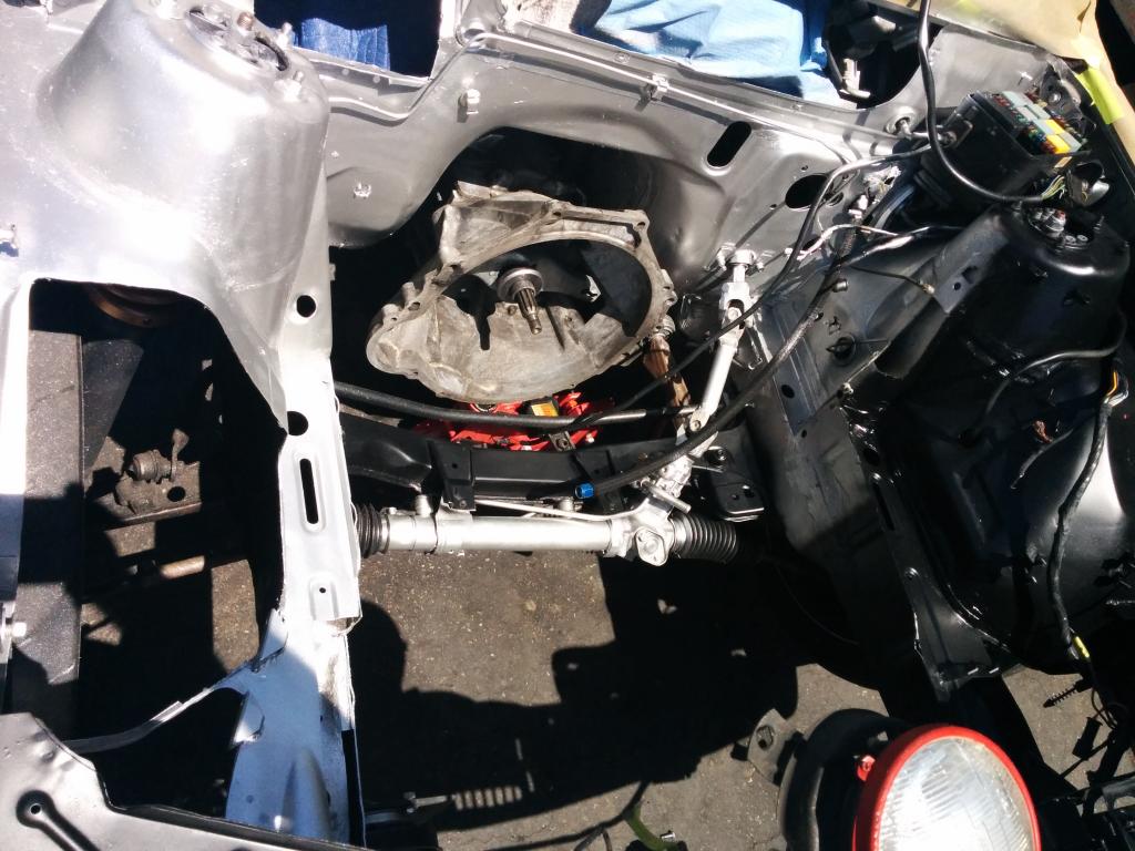

    more

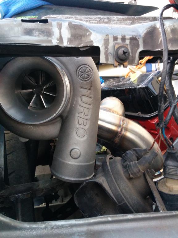

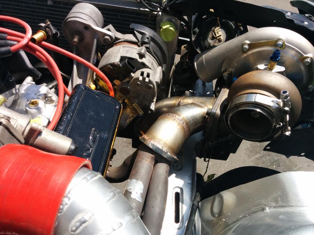

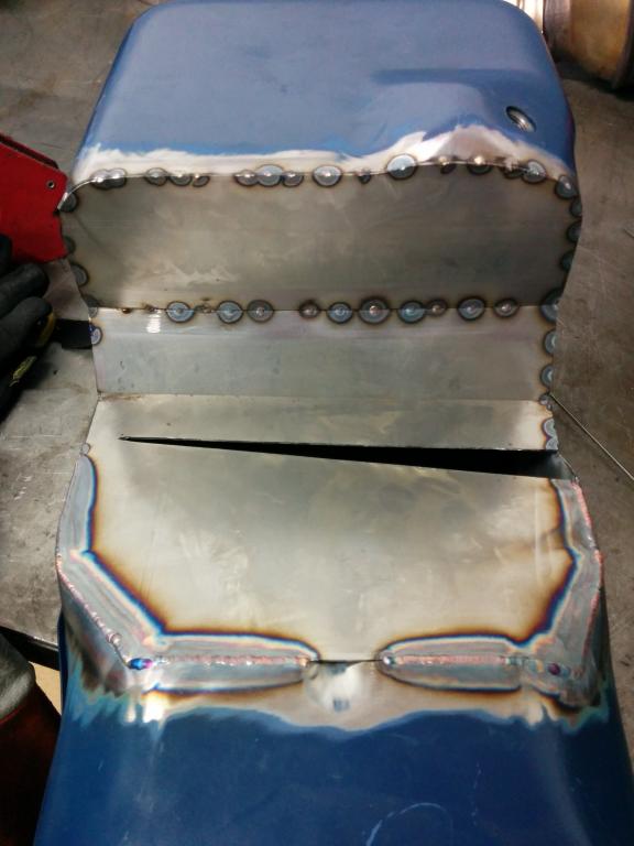

            Rad. Hope you have something to control oil starvation.

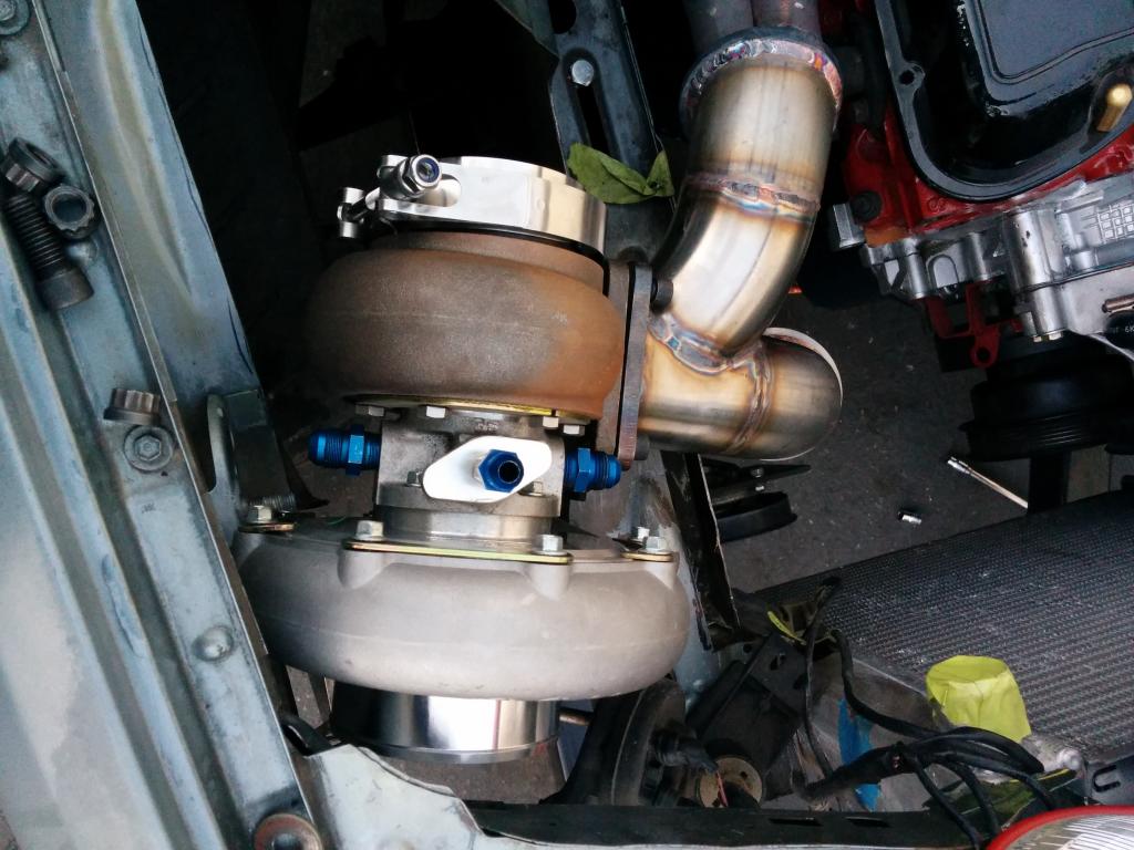

            • jalopi
              • 2370
              there's a turbo manifold that'll fit much better than what you currently have going on
              also, i hope you have access to some extra t5's, no way i see that ending well :)
                Thanks. I got some baffles going on around the pickup
                • danval
                  • Mar 2013
                  • 191

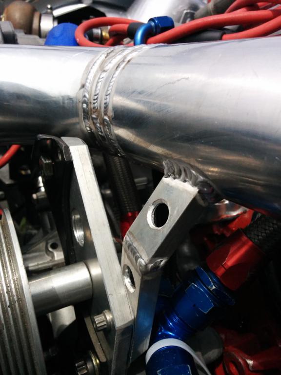

                  Thanks, I fabricated my own motor mounts so I'm not sure if other stuff will clear that area. I will Fab my own headers down the road anyway. Hahahhah I know! I have my setup to max at 10psi, but with 5 I've been getting plenty of torque to slide the crap out of this coke can! Thanks brotha!
                  • jalopi
                    • 2370
                    just make sure to keep it under 6k rpms, from what i've read on all the ford forums that seems to be the magic ticket to keeping stock blocks from splitting when boosted
                    • danval
                      • Mar 2013
                      • 191
                      Dang! Good advise!
                      • e30_302
                        • Sep 2013
                        • 453
                        I'd add an Accusump too.
