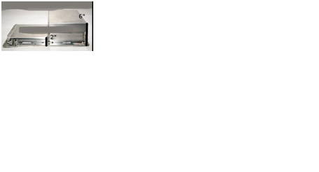

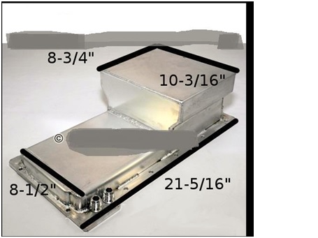

          I wanted to do a quick update.
          I attached some pictures of the Speedmaster pan with the dimensions on it, just in case anyone was curious about their pans.
          In the long run, I decided to go with the Canton Pan CTR-15-276 with GM Performance pickup NAL-12572654. When I get the pan I will take some measurements and post those dimensions too.

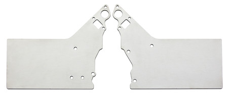

            for the motor mounts, how about a motor plate instead?
            i'm currently trying to figure out why more people don't use these for e30 v8 swaps. as far as i can tell you could actually use off-the-shelf cheapo block huggers with plenty of clearance due to the lack of motor mounts getting in the way
            • sgtskid
              • 763
              That's a damn good idea. I'll have to do a little research on those. Which plates are those?

              • jalopi
                • 2370
                generic picture on google. IIRC the one piece dealies are motor plates, the two piece versions are called elephant ears, though that might be the "street" name
                • garretvs
                  • 464
                  Use solid mounts like those and the ride would vibrate more than a Hardly Ableson.

                  • jalopi
                    • 2370
                    you can still soft mount motor plates if i'm not mistaken - just eliminates alot of the benefits drag racers install em for
                        I really like the idea of using solid plates just to free up room for headers. Once i get to the stage of mocking up the motor in the car i'll figure something out. Right now, 2x4's will be motor mounts of choice.
