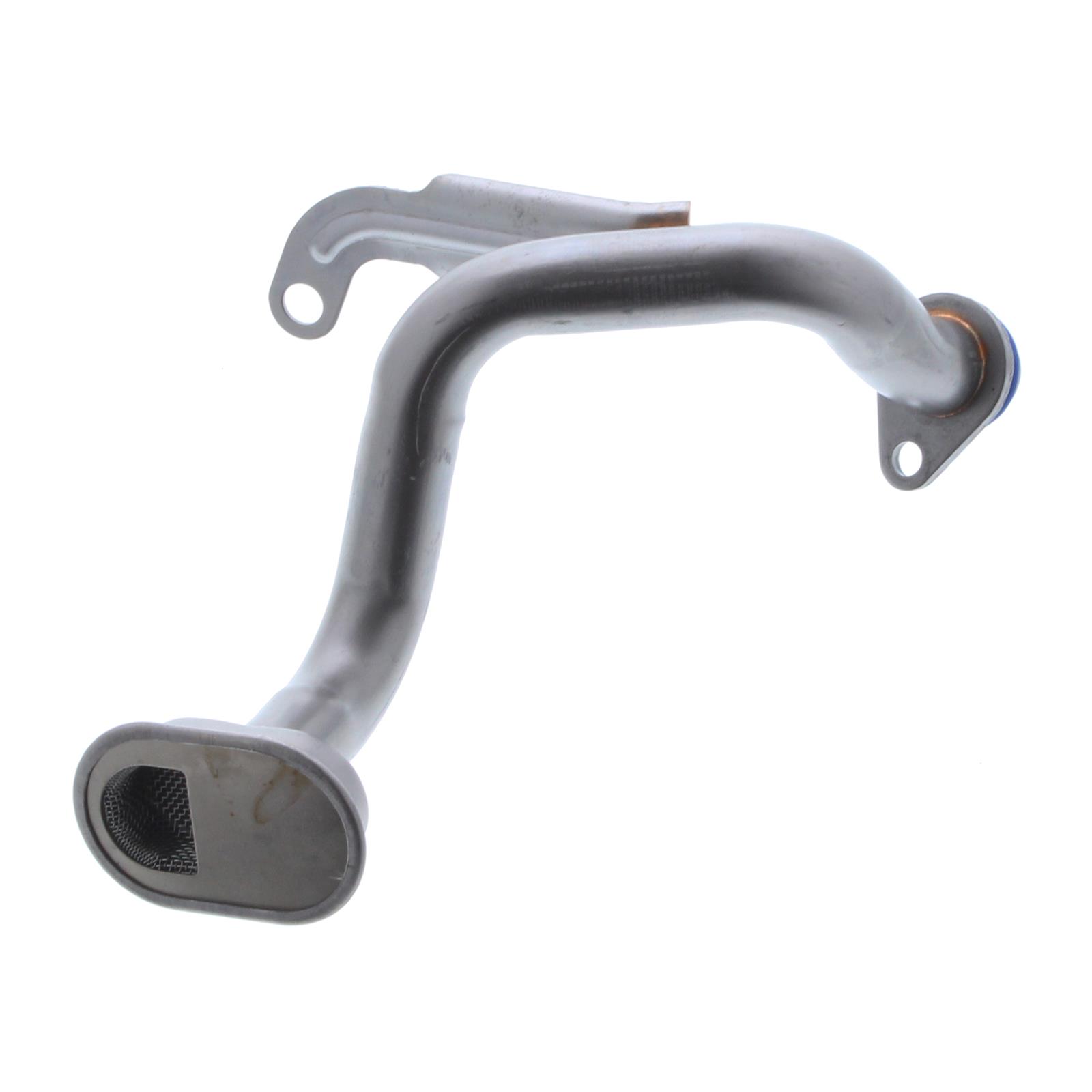

      It's been a while since I've updated this post and I said I would post dimensions of the Canton pan I purchased. Well, I was cruising Canton's website and I discovered that they have now posted their dimensions on their site.
      So for now, here is my oil pan setup - I haven't received the engine back from machine shop yet so I haven't test fit anything.
      I ordered the Canton 15-276 pan with GM 12572654 pick up.
      Our products solve your engines' oil and cooling problems. Improve your engines oil pressure, oil temperature, and coolant system with Canton Racing Products.
      Free Shipping - Chevrolet Performance Oil Pump Pickups with qualifying orders of $109. Shop Oil Pump Pickups at Summit Racing.
      Total $359
