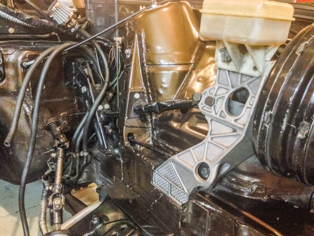

                    Might be nice if someone made a ready to bolt/weld in bracket instead of that factory AL part?
                    Originally posted by Matt-B
                    • shiboujin
                      • Feb 2006
                      • 2791
                      That just looks like a rube goldberg machine to me.
                      Status: HG repair. 488wtq though!
                      • The Dark Side of Will
                        • Jun 2010
                        • 2796
                        Except for the strut tower gusset in the middle of the brace, that's exactly how BMW built them from the factory in V8 E32's and E34's. It's definitely... German.
                        • JGood
                          • Jan 2004
                          • 7959
                          I'm not sure why everyone is so terrified of it or thinks it's some complex concoction of parts. There's a total of three moving parts. It's a lever. I literally have never seen any part of this system fail, in any way, ever. It requires zero maintenance. It's available for about $20 at any junkyard. I can understand if some people don't want a booster, there are valid reasons for that and I get that, but to say the e34 system is inferior in some way due to the linkages doesn't really make any sense.
