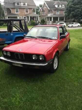

    A couple of months ago i bought a 1987 E30 325ES, Drove up to philly 7 hrs to get it. Paid the guy and 10 minutes later i got in it and drove it all the way back to NC. It had the stock engine in it, with an auto transmission. She drove perfectly fine all the way back. I noticed some things that the seller didnt tell me like for ex

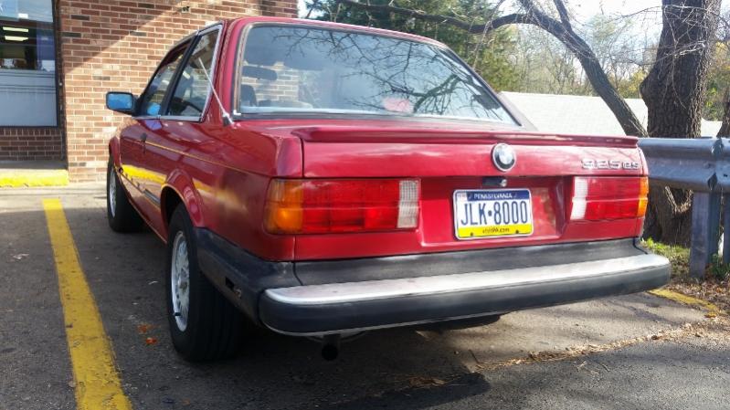

    Hopefully this way works, i'm trying to learn about how to use this fourm, This is the first picture i saw off craigslist
    here's when i first got her

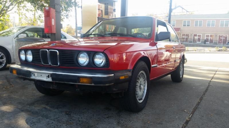

        Took this picture the day i got her
