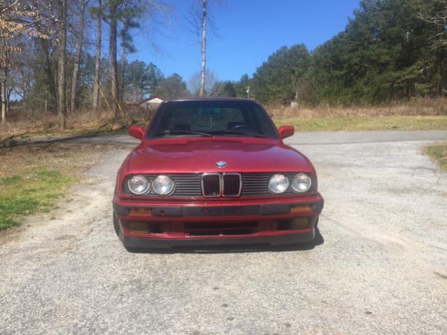

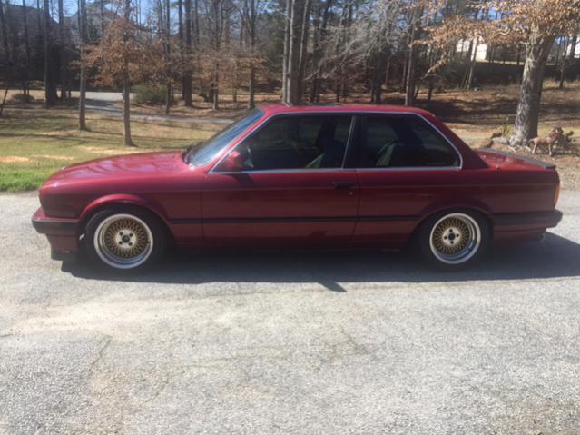

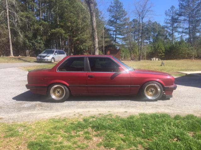

    Hello to all! My name is Wes and this will be my journey into the e30 LS swap. I work at a performance shop outside of Atlanta, GA where we support a few e30 spec racers. I love the body style of the e30 but looking at what you have to do to get any performance out of a M20, I decided to just go with a LS swap. I'm already partial to the LS motor and really know nothing about BMW engines so the fit seemed right. I'm by no means a mechanic but I am capable of doing most things with help(I sit behind a desk all day). My goal was to find something that was in pretty good shape cosmetically because I would be parting with the drive train anyway. Here is what I came up withClick image for larger version
    The paint is in good shape. The front seats and carpet will need replacing but the dash is crack free. The car is lowered with some brand of coilovers - not sure what they are. I'm going to hold off on pulling the motor until i have everything ready to go. I will be going with a full sikky kit, chase bays BBE and wiring specialties wiring harness. The motor and trans were pulled from a 2001 trans am and I will be posting some pics of that process shortly. Any feedback or suggestions along the way is greatly appreciated!
