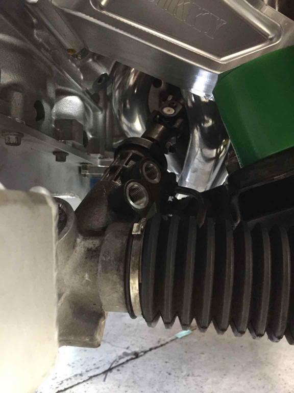

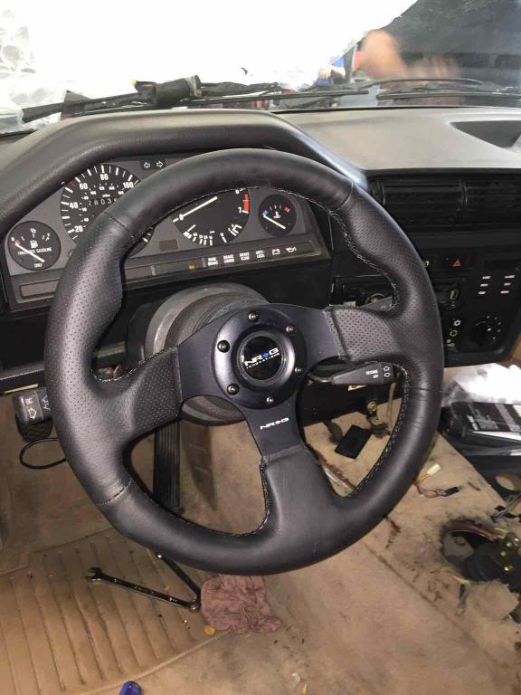

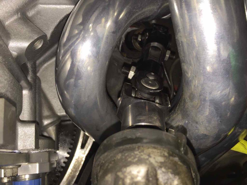

      Made some more progress today. My e30 had the airbag column which will not work with the sikky steering shaft kit and z3 rack. Pulled the old column out and replaced it with a non airbag column.Click image for larger version

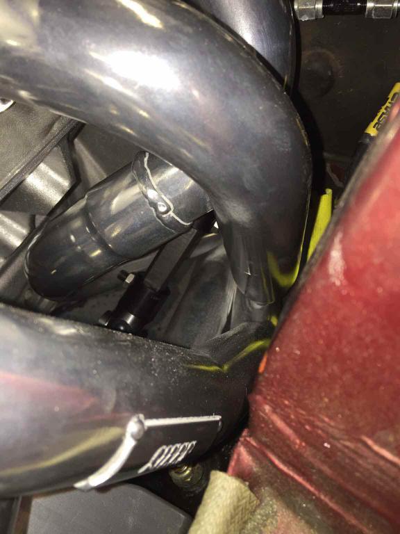

      The whole thing had to be attached to the column before the install. There is no room to work in between the headers. After getting column in I mounted the new steering wheel.Click image for larger version

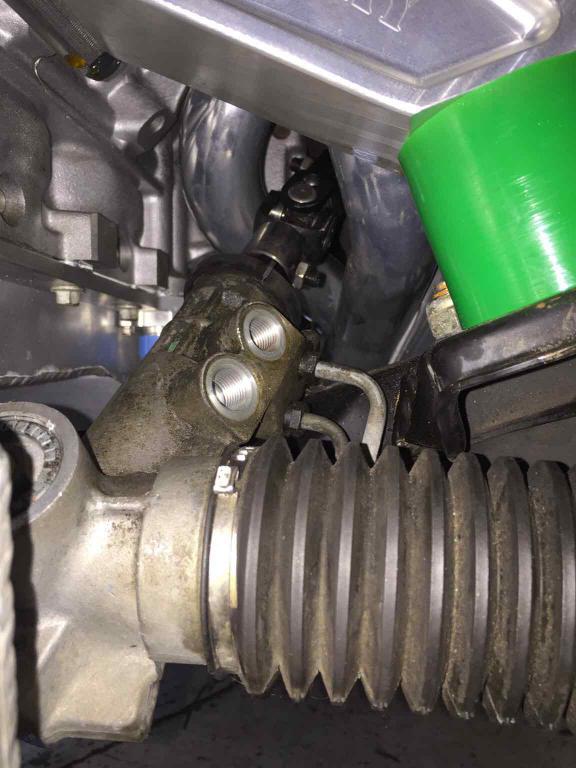

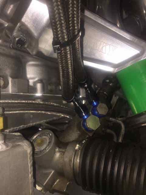

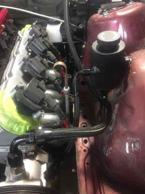

                    Made some progress....power steering lines done and mounted power steering reservoir Click image for larger version
ID:	7188799Click image for larger version

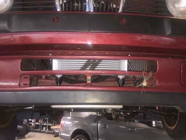

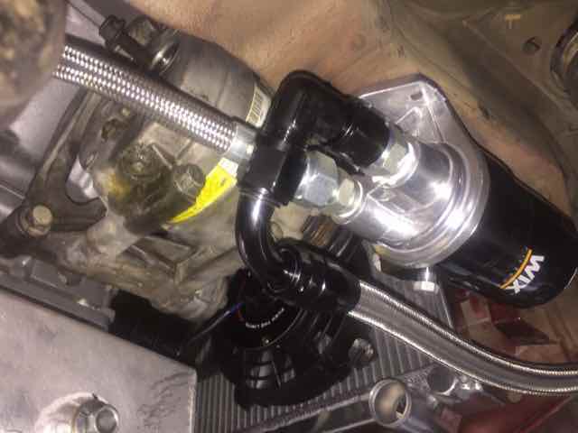

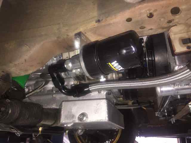

                    Oil filter relocation installed along with the oil cooler in the frontClick image for larger version
ID:	7188801Click image for larger version
ID:	7188802Click image for larger version

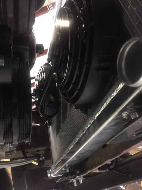

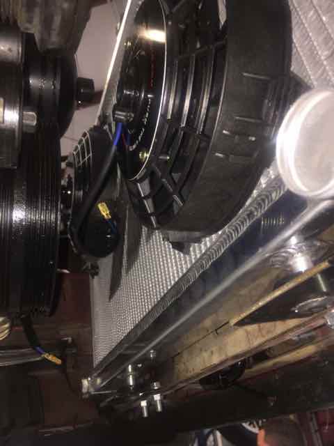

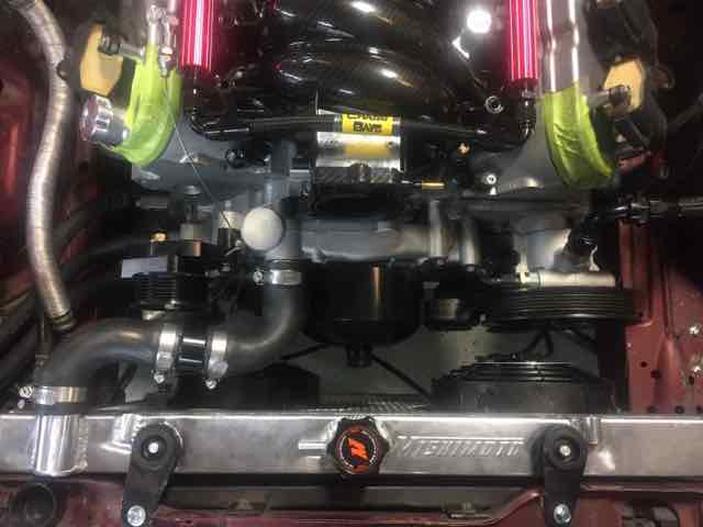

                      I was able to fit the large Mishimoto fan in front of the condenser and two small fans on the back side of the radiatorClick image for larger version
ID:	7188804Click image for larger version
ID:	7188805Click image for larger version
                      • 90e30ls
                        • Dec 2015
                        • 77
                        #56
                        Upper radiator hose done with the steam vent line. The fuel rails and injectors are mounted on the intake but it's just sitting there to see how it looks. Also got the heater lines run. Click image for larger version
