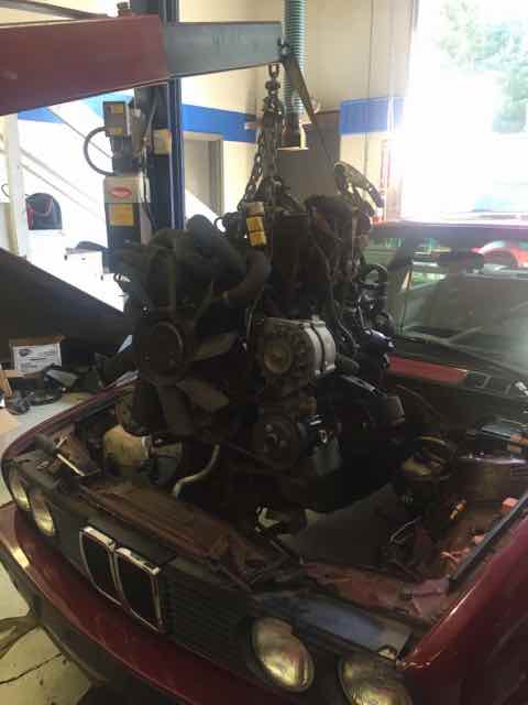

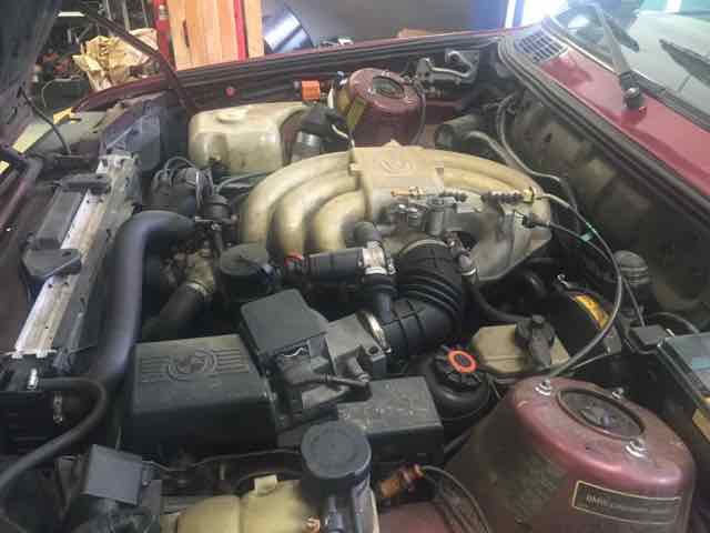

                  #38

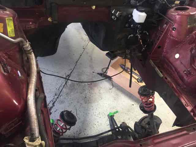

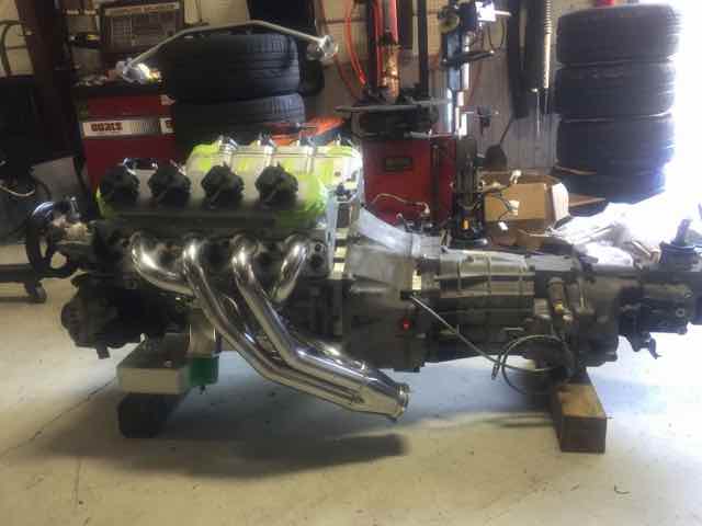

                  So finally started on the swap. Been preparing for the arrival of my second child in October so time has been slim. Would like to have it up and running by the first of October. Pulled the motor and sold the complete package for $1000. Click image for larger version
ID:	7188306Click image for larger version

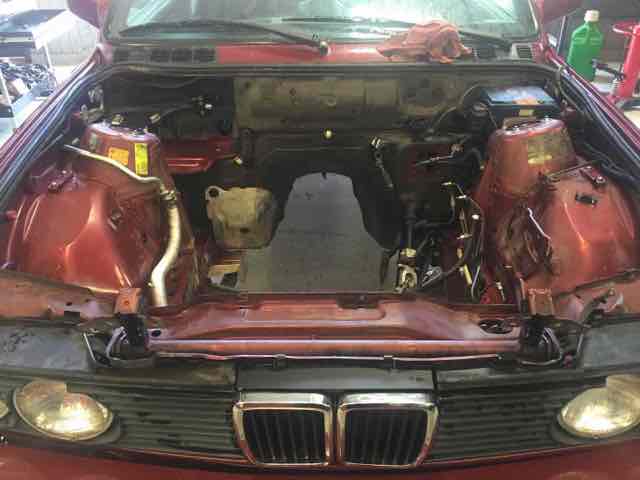

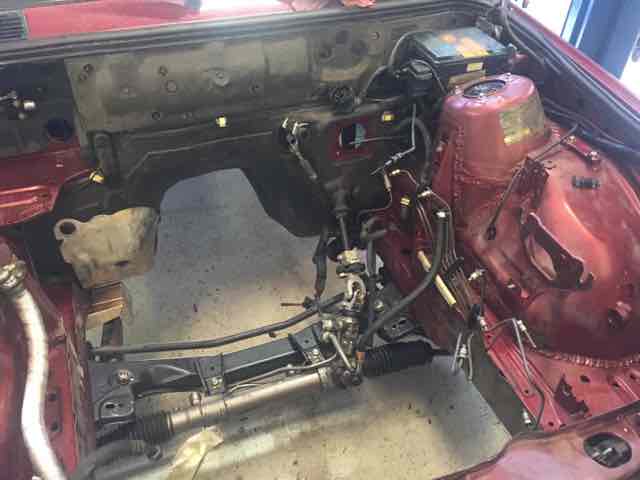

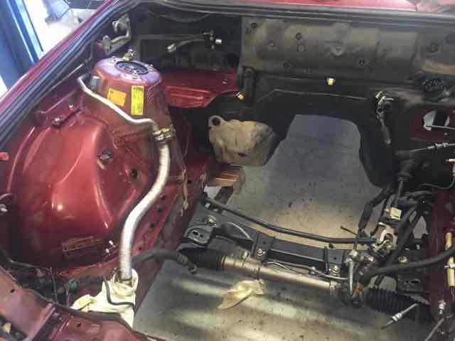

                  Removed everything not needed and have the engine bay a good cleaningClick image for larger version
ID:	7188308Click image for larger version
ID:	7188309Click image for larger version

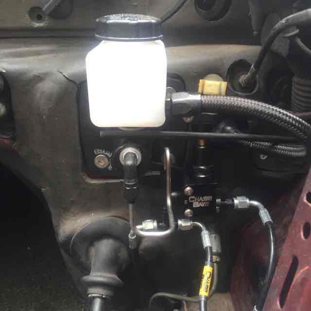

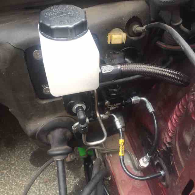

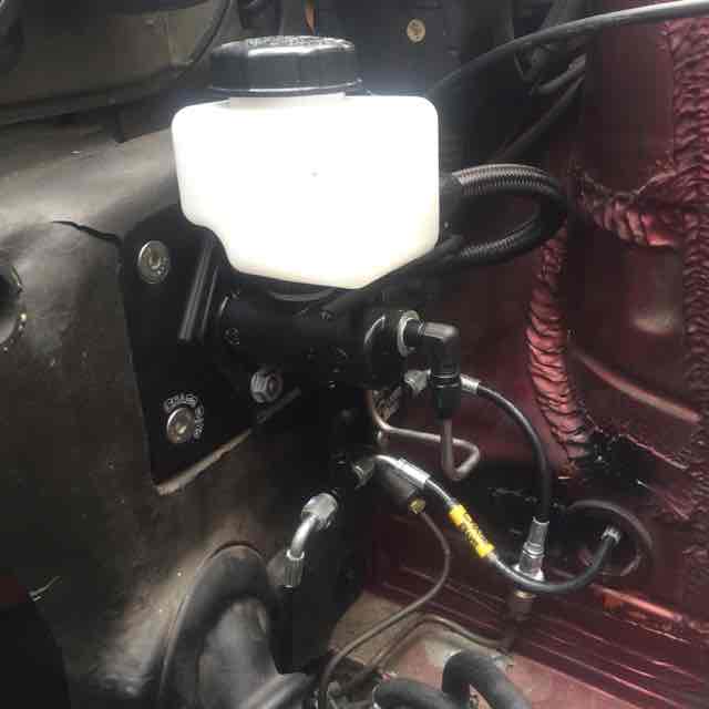

                    Got the brake booster eliminater from Chase bays installed along with the new brake lines. Click image for larger version
ID:	7188317Click image for larger version
                    The black hose tied into the brake fluid reservoir runs to the stock clutch master under the dashClick image for larger version

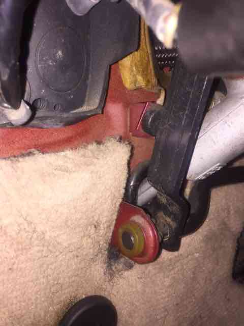

                    Getting the hose attached under the dash was a big pain because of the location Click image for larger version

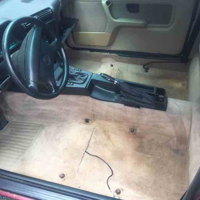

                    For the front seats out and cleaned the carpet. Came really clean except for a few places which will be covered by seats and floor mats anyway. Click image for larger version

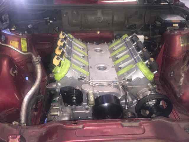

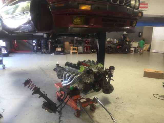

                          Well made a good push in the last two days. Decided to come in from the bottom so we dropped the front end and attached everything. Click image for larger version
ID:	7188379Click image for larger version
ID:	7188380Click image for larger version
ID:	7188381Click image for larger version
ID:	7188382Click image for larger version

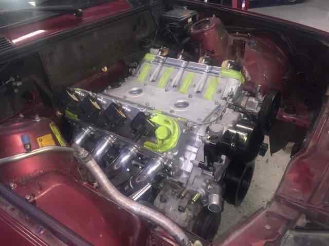

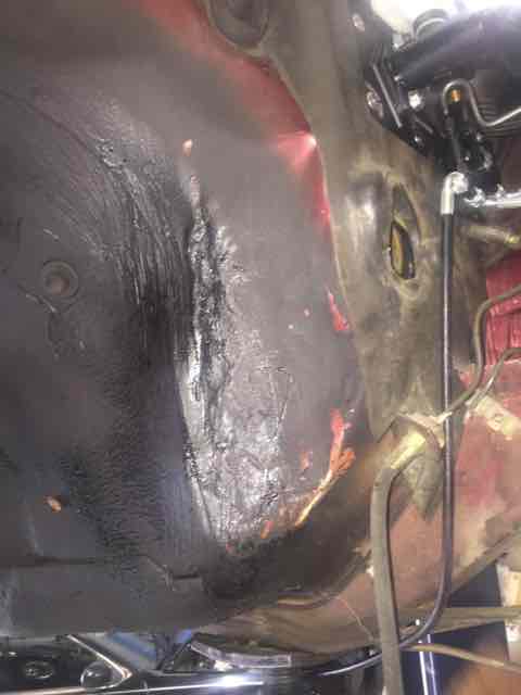

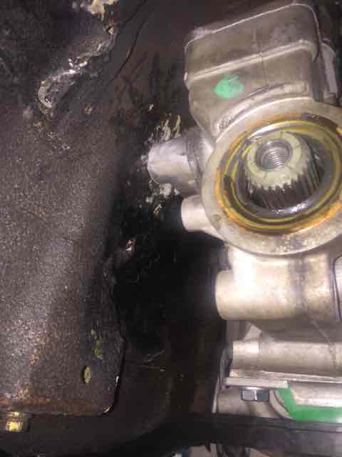

                            #43

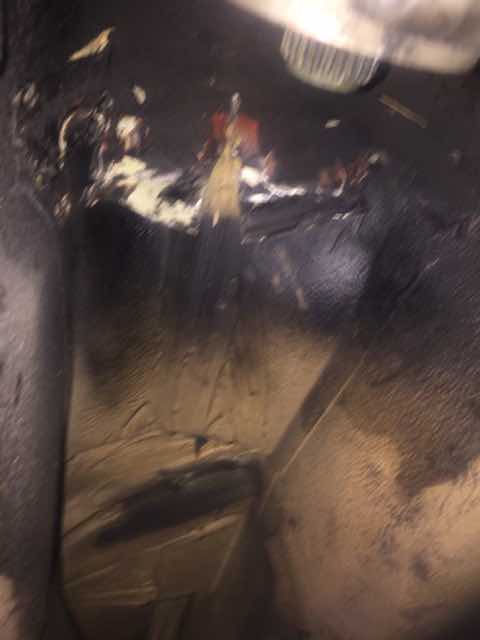

                            Accounted for relieving the area on the firewalClick image for larger version
ID:	7188384Click image for larger version

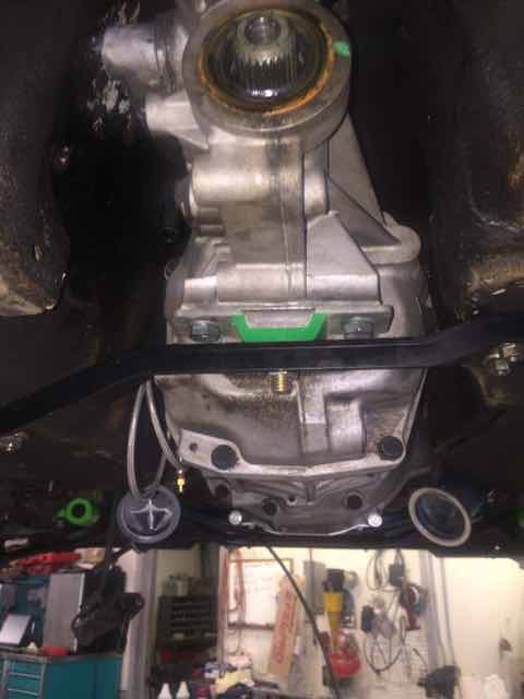

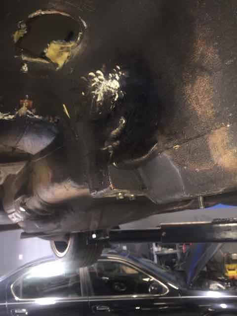

                            Wasn't aware of these areas in the tunnel that also needed some relieving. Took a few times going up and down but finally got itClick image for larger version
ID:	7188386 cut and beat this area up in the tunnelClick image for larger version
ID:	7188387 after the transmission fitClick image for larger version
                            • 90e30ls
                              • Dec 2015
                              • 77
                              #44
                              Got it bolted in....takes lots of trial and error but it does eventually fitClick image for larger version
ID:	7188390Click image for larger version
