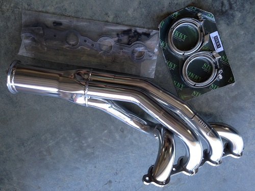

      Not Another Cheap V8 Swap...
      Headers Part 2
      So to make a long story short, Sikky clearly doesn't have a correct length header. There customer service is outstanding, mailed me several sets and even refunded me a portion of what I spent on the headers. Cheers to them.
      However, I'm still stuck with a set of headers that are to long. As a reminder, here is a pic of how low they sit below the subframe.
      Once I got the headers back off, took some rough measurements. Looks like I'll be cutting off 6" and 6.75" respectively.
      Since I don't do much of any welding, I hacked the header and then sent them over to a buddy of mine who is a self proclaimed "hot rodder" to finish modifying them.
      The Plan:
      While my friend John has the headers, I'll get the transmission and driveshaft mounted up. Then, I'll roll it up the street to his garage where he will mock up some exhaust.

        I am rather surprised.... $1000 headers and they dont fit consistently from one set to another AND they drop that low. I would be pissed. I was thinking about getting a set but think im gonna just to cutouts now :/

          1000.00 a set is the reason why I made my own headers. 60.00 for flanges, 140.00 for V band flanges and 185.00 for pipe and a week worth of bitching. lol..

                #82
                You guys are exactly right! Trust me, I did a lot of bitching and showed my ass a few times but in the end, I don't want to bash them too much because they did make it right! We lost over 6 weeks of this build dealing with headers alone which is ridiculous, I expressed my concerns and reminded them of how much I spent with there company because I wanted the quality they advertise. They made the situation right by me and I cant complain.
                The story I was given from Sikky..
                "When we (Sikky) were smaller company, our quality control was top notch. As we grew, we started outsourcing a third party company in GA that mass produces our products and drop ships to the customer. Our quality has suffered (specifically aluminum drive shafts and headers) and now building a larger facility to handle all our own product, in house."
                I have seen the new version of the E30 headers. They look good and obviously addressed the collector issue. Frankly, not everything from Sikky has been painless but the relationship I've built with them and the customer service they provide is worth the hassles. Its going to happen when building a car like this. I rather it be these guys then some arrogant asshat that wont stand buy the product the sell.
                I'm also building a destroked LS7 to drop int a FD RX7. I can assure you I know where i'm buying all my swap parts from :D

                • E30Whore
                  • Mar 2016
                  • 183
                  #83
                  Originally posted by 90e30ls
                  Ok so I went back and looked at mine. It looks like I have a different set than yours
                  Haven't tried fitting mine yet but maybe I will have a different story
                  What you have is the revised swap header. Those are the headers they are making in house at the new location in MD. You can clearly see the difference between your set and this set. Notice the 6'' of collector I had to hack is now missing from the revised set? lol

                  • Q8y_drifter
                    • Aug 2009
                    • 297
                    #84
                    Is Sikky partially refunding everyone who received the older set or what? I had to mod mine as well. Not only that but got the wrong set of headers (1-7/8" with 3.5" collector) and received 3" v-band flanges with it, which suffice to say were useless.

                    • E30Whore
                      • Mar 2016
                      • 183
                      #85
                      I can't tell you how discouraging it is to read this.....I can't believe after spending that kind of money they have to be modified to that degree. Would your buddy be interested in doing another set after yours?
                      I'll ask John, I cant speak for him but I am also confident he will. PM me and we can workout the details. I'll post the finished product later on. We also made a pretty sick exhaust too. I am thinking of making a few more to offer other Sikky V8 swap guys that are running the swap headers.
                      I have no idea and can't speak for them. This is why I was reluctant to even acknowledge that I was because i'm sure people will run to them over this comment. If you recall, I asked you in another thread if you had communicated your issues with Sikky and you said "no, I just modified them to work". In my experience, if you need a issue resolved, communicate it promptly, be understanding and most times all is worked out..
