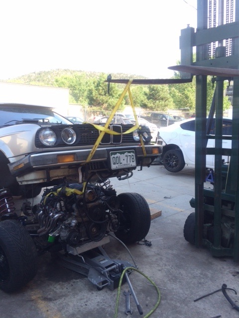

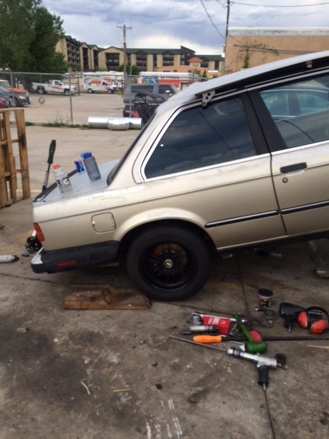

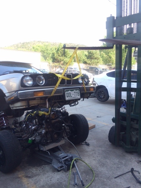

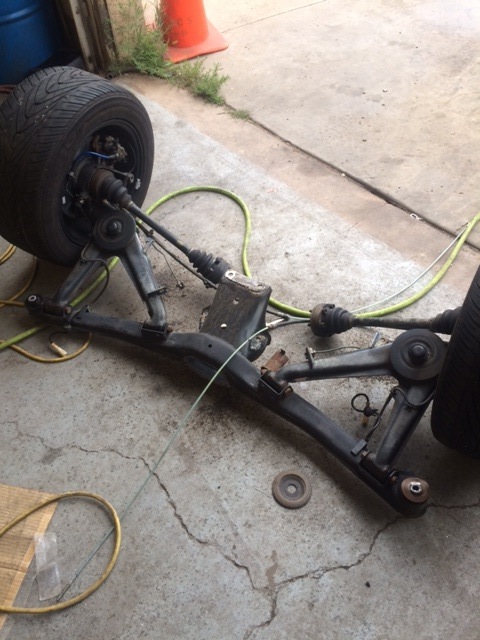

    Some backtracking, pulled the motor again. Without the lift we have to use a forklift like so. Changed the trans fluid, hammered the firewall, removed some sound deadening, shaved some bits on the tr6060. The shifter will need some fabbing tomorrow. I'm still debating whether or not to keep the A/C, It wont be expensive but it'll delay getting the car on the road!

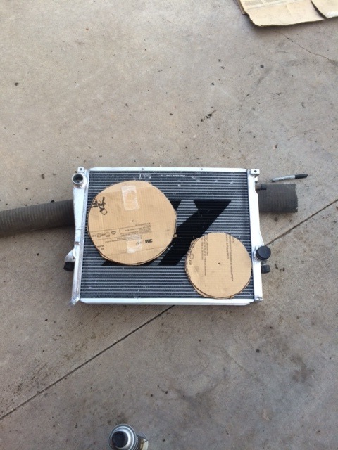

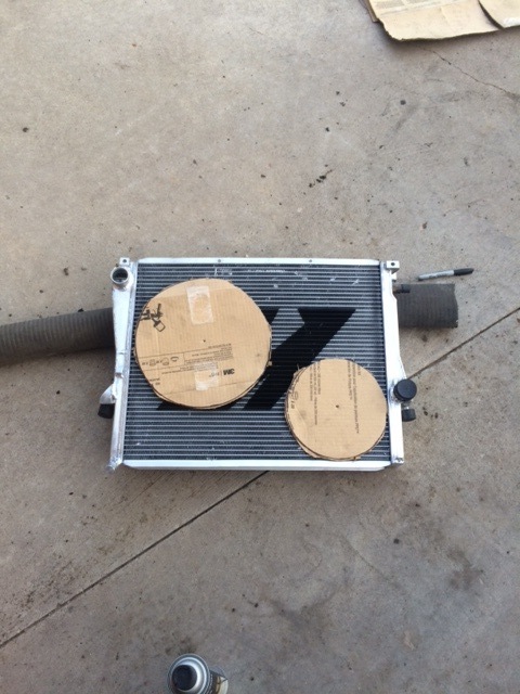

        Today some mock up fans were test fitted. The factory pusher fan will be replaced with the Mishimoto fan and 2 slim pullers will be put right behind the rad.

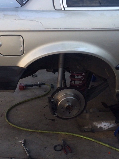

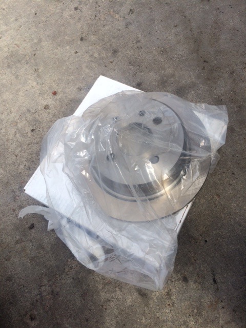

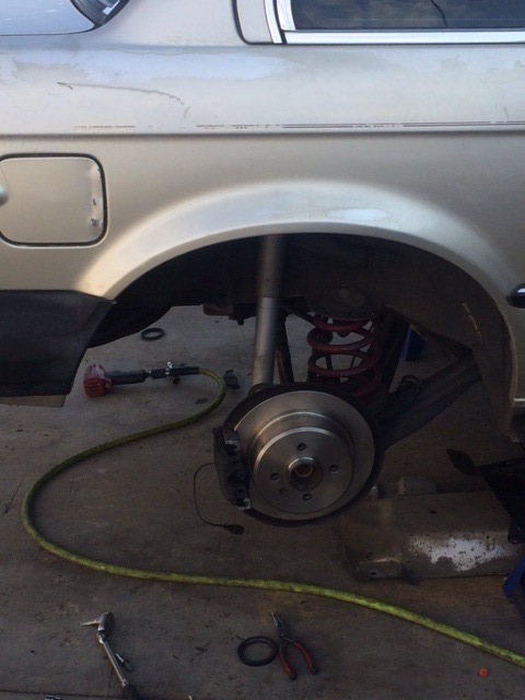

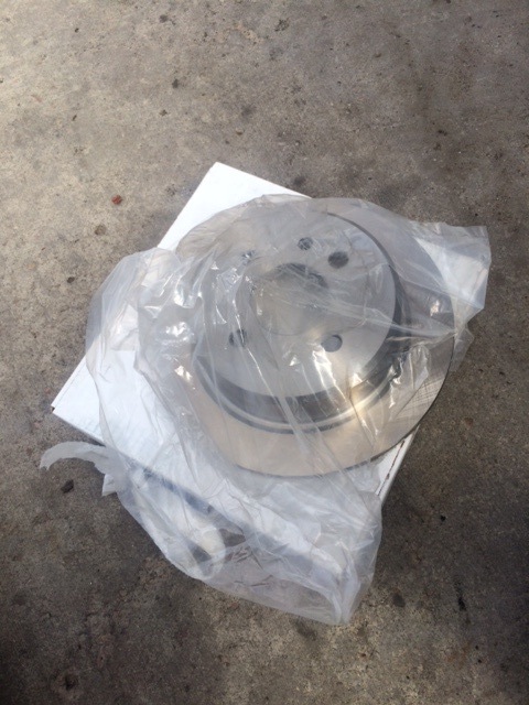

        Got some new rear rotors and hardware for the rears.
        Gear oil changed as well. As for the chassis reinforcements, the rear end might not have to come out to save time.

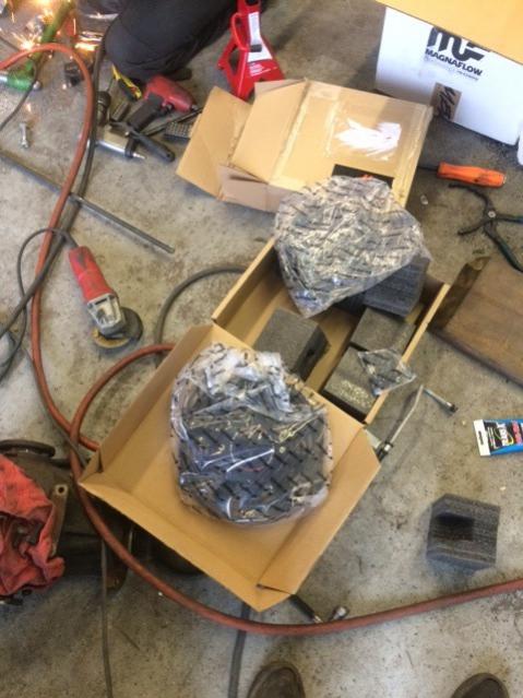

              Got some parts in today!

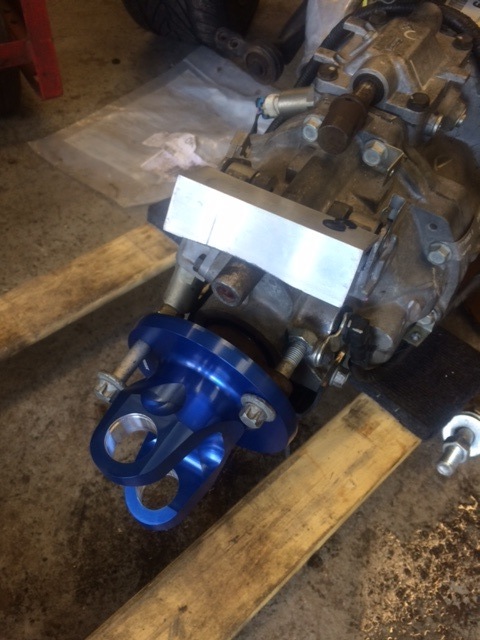

              1350 driveshaft yoke which is rated to 1000+ hp so this will not be a problem in the near future.
              2 Mishimoto slim fans since the big one doesn't fit.

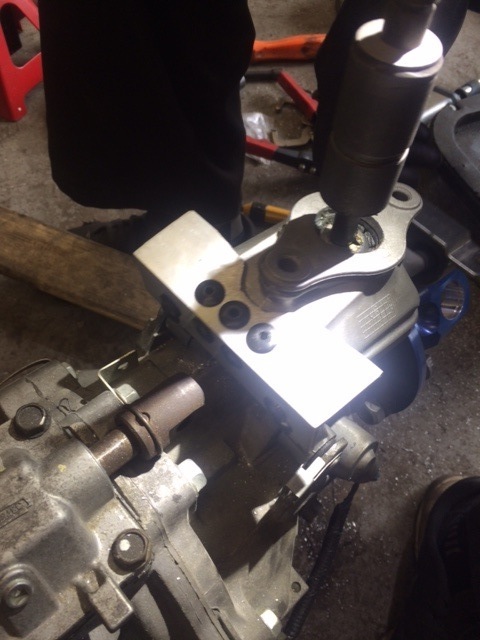

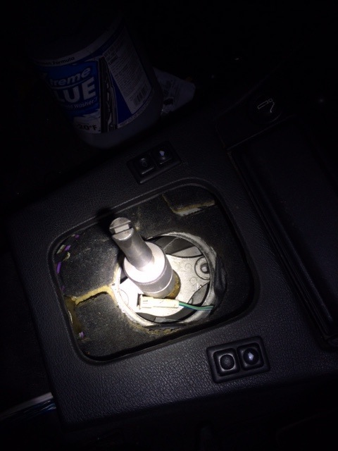

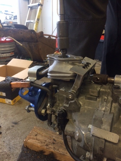

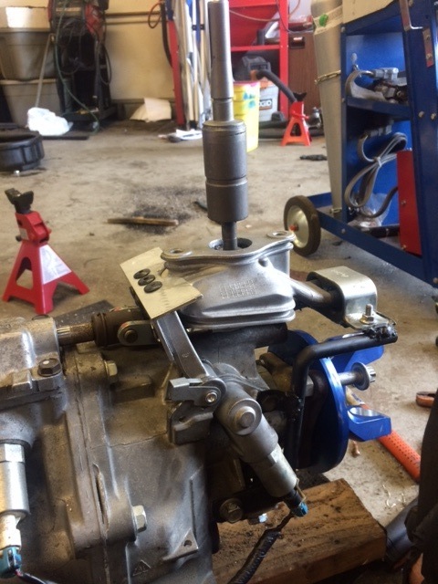

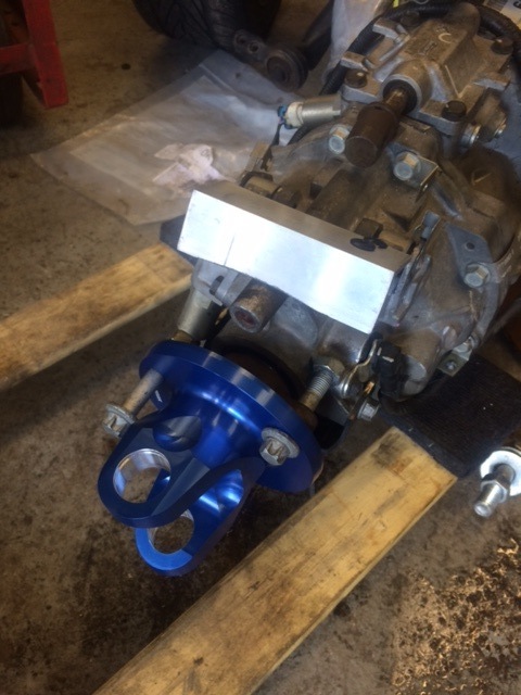

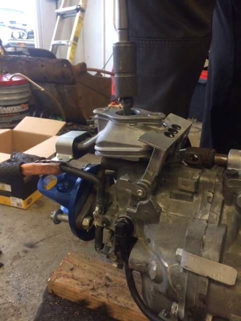

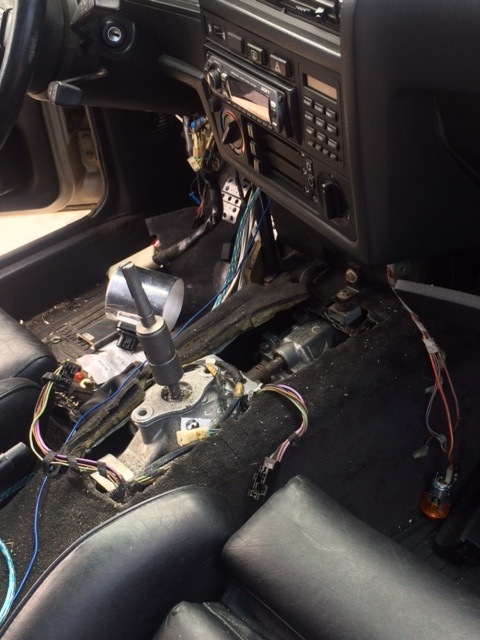

                The shifter bracket in the works. The shifter had to be moved forward a few inches so it's very tight.
                Welding pencil rod to make it stiffer.
                The finished product. The aluminum bracket flexes a little bit but other than that it's great.

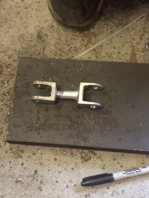

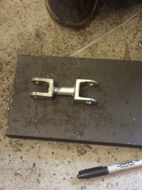

                Here is a pic of the TINY selector rod. Bit of a pain to make and it took a while but it fits surprisingly well.

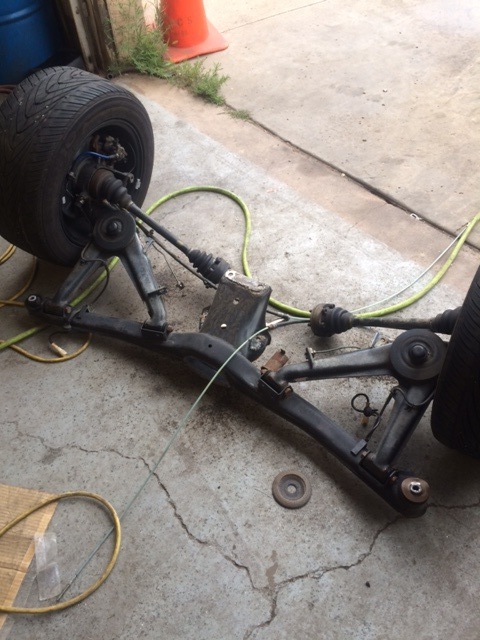

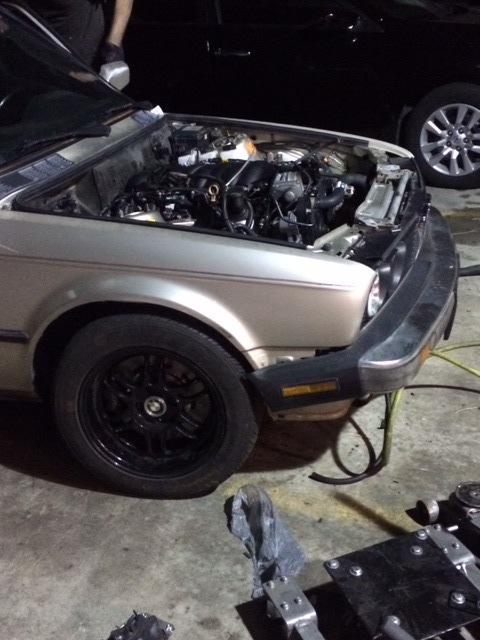

                  FINALLY! The project was put on halt waiting for a complete poly suspension kit and a clutch line. Both of them came in and then we could finally put the diff and engine back in the car.. I hope to God the engine doesn't have to come out again.
                  Sorry for the bad pictures in advance, it was late.
                  Poly Bushings from Garagistic in the diff and the diff is back in! If we can find a large case diff in a junkyard nearby we might be upgrading. The stock diff is a ticking time bomb with this TQ.

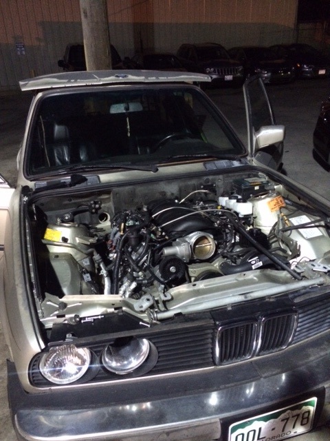

                  After a few hours the motor was put back in. Nothing broke thankfully.

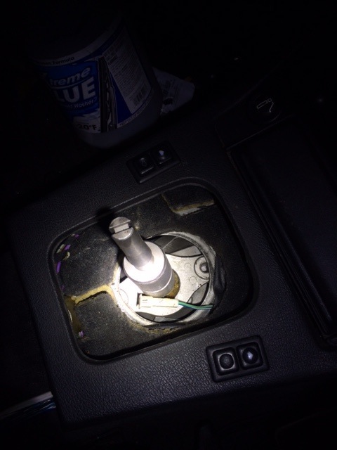

                  How the shifter lines up. Not bad the shifter hole did need a little bit of cutting in the rear but nothing bad.

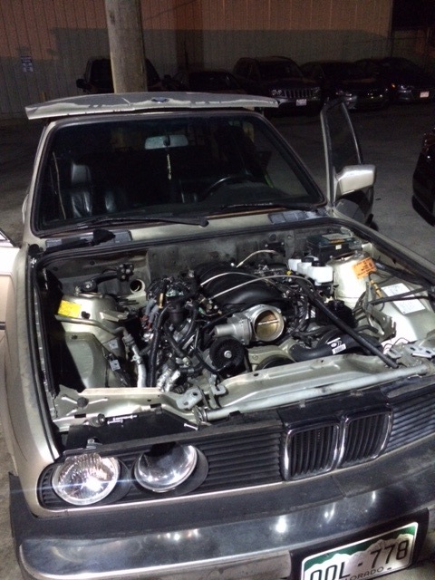

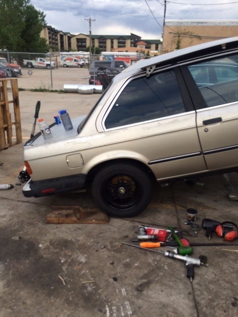

                  Here is the car finally sitting on the ground again. It's been too long since this has happened. I think it sits noticeably lower. Maybe half an inch or more. Ill have to take a better pic in the light and compare. Only a few things left to do.

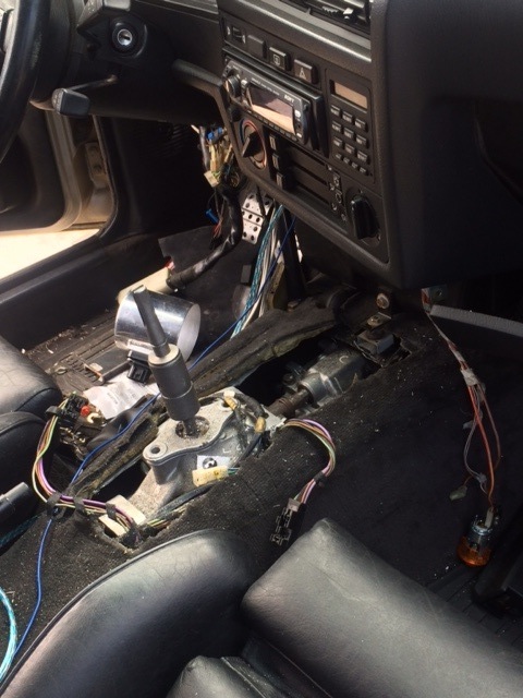

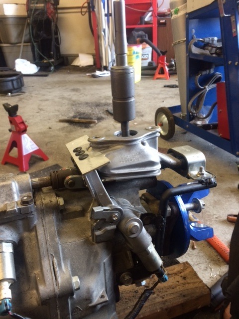

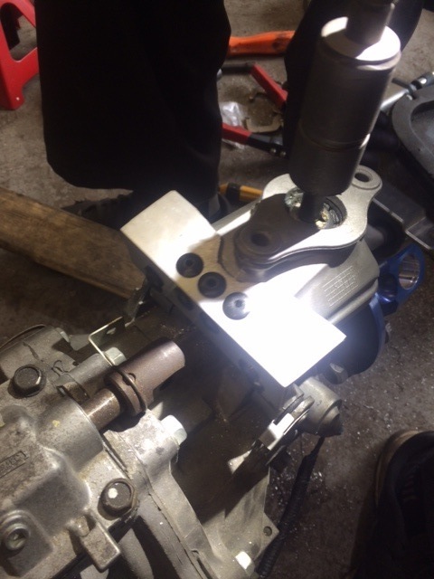

                            Not a big update, Just sorting out a few things. The shifter base was hitting the top of the tranny tunnel, so it was cut and repaired to fit. It's put on with only sheet metal screws for easily removal.
                            I'll have to snap a pic of the finished product.

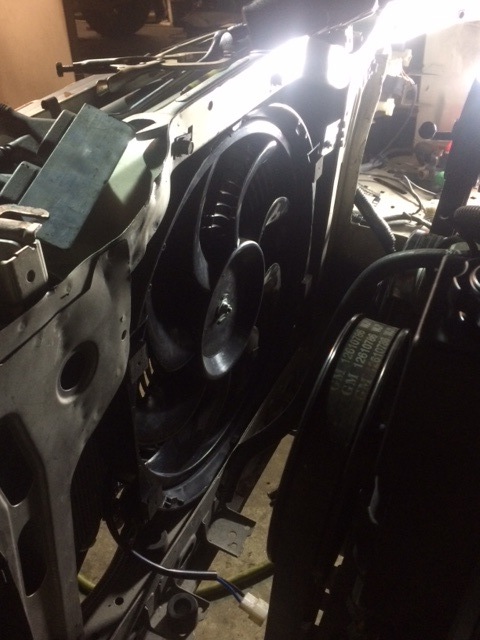

                            So it turns out the big fan from Mishimoto is too thick to fit with the condenser so that's being removed until a later date. Once I decide I need A/C I'll have to figure out a solution for that.

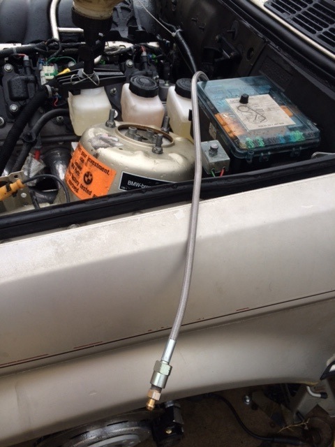

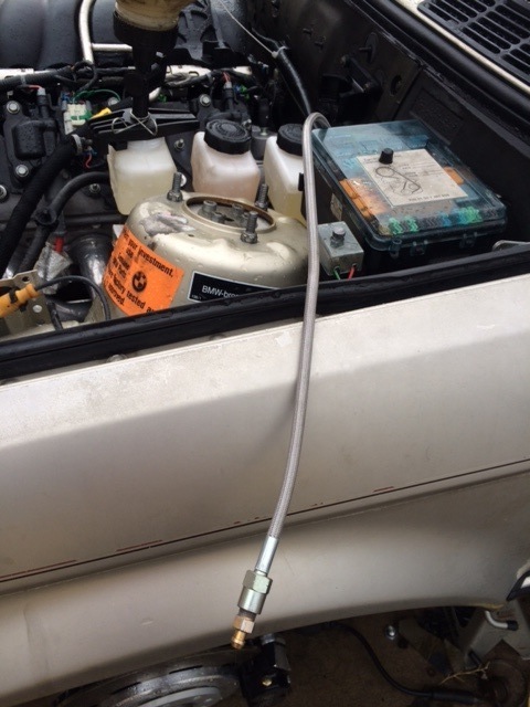

                            Here is the clutch bleeder line. It's a bit longer than anticipated but it'll make bleeding the clutch much easier.

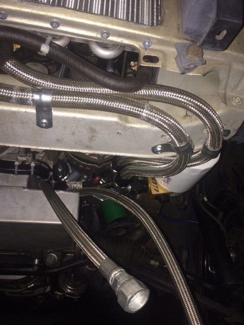

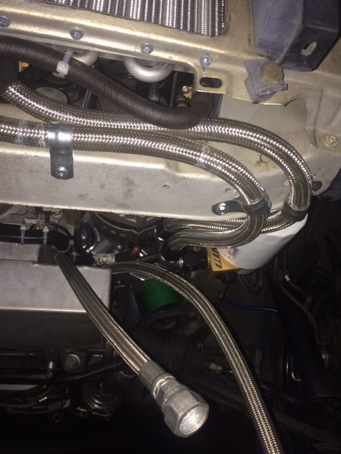

                            Last but not least some oil lines were tucked to the side neatly so I don't destroy them on the ground. Only a few things left to do.

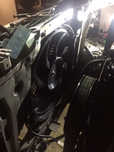

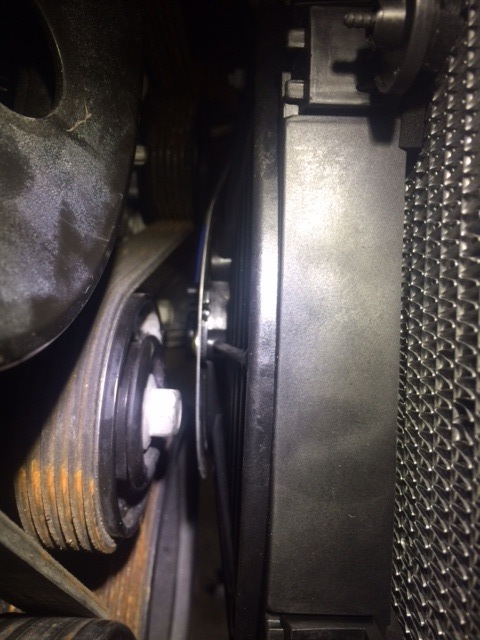

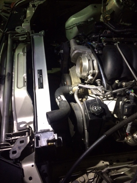

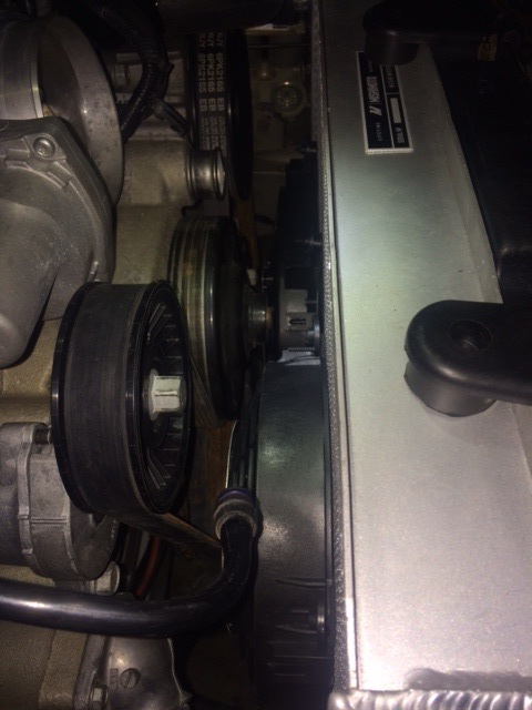

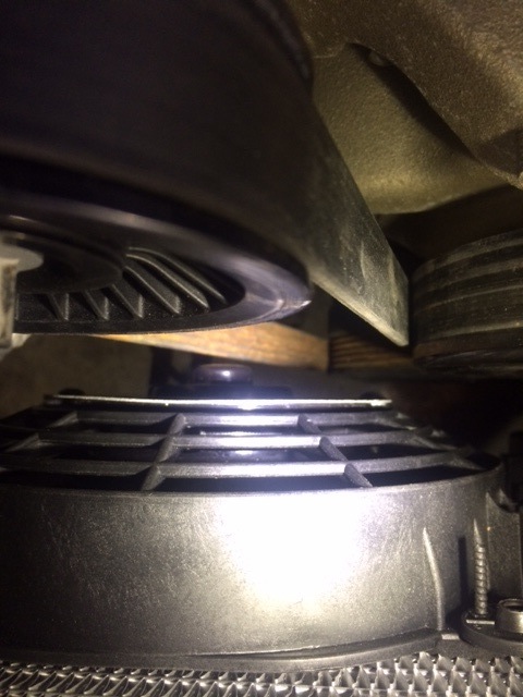

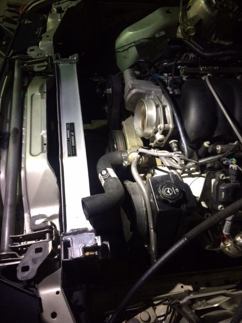

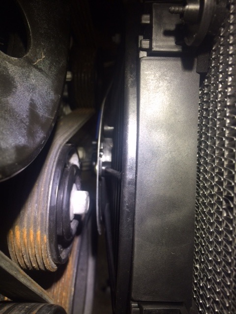

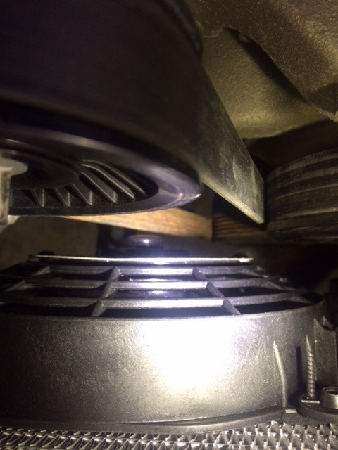

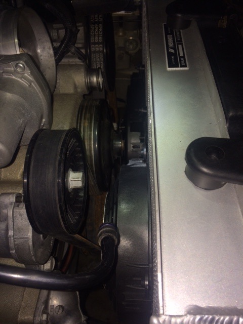

                              Got the radiator mounted with the slim fans, they have a tiny bit of clearance left. Here are some pics to show you how tight it is.

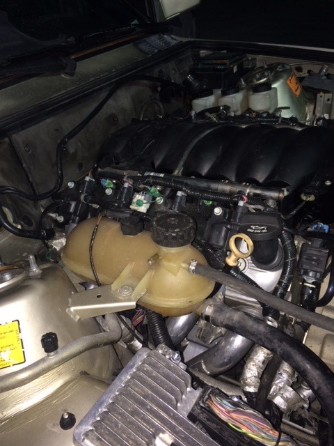

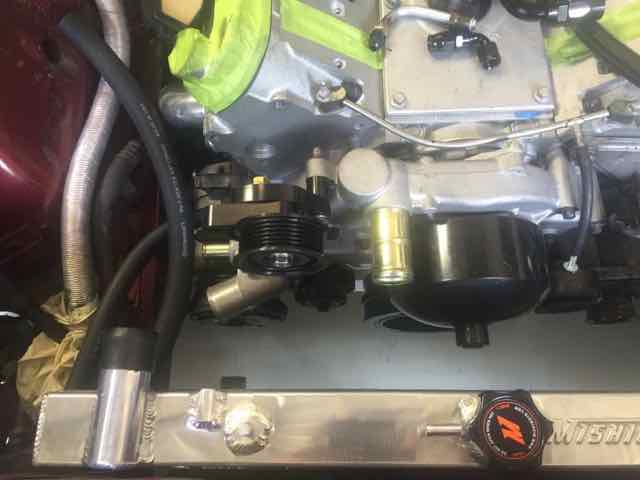

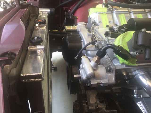

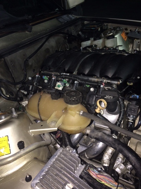

                              Also the bypass valve is all hooked up in the OEM location, very tight squeeze but it's on. Also, the coolant reservoir bottle surprisingly fits with the OEM mounting points.

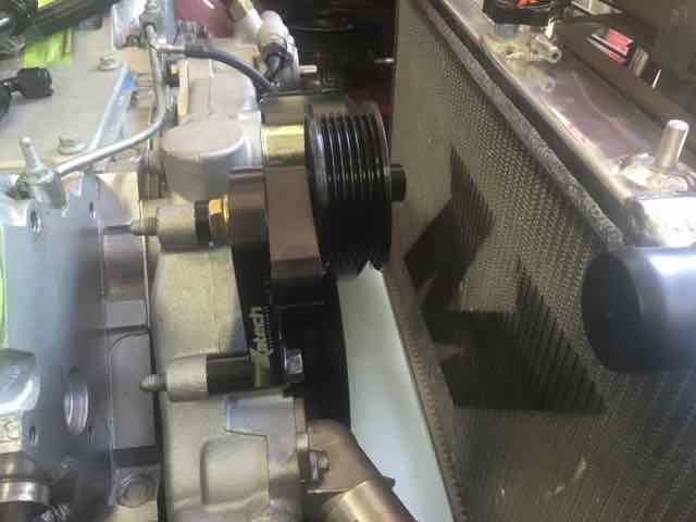

                              How are you guys mounting the washer fluid bottle? I was thinking of getting a small custom aluminum box made to fit in the front battery tray. And for the LS1 guys is the tensioner pulley right in the way for the intake? I might need to get a low profile pulley just so I can have a 4" pipe all the way.
                              • 90e30ls
                                • Dec 2015
                                • 77
                                #45
                                I'm going with the katech tensioner. Not sure if it will give you clearance but I'm running my intake to the drivers side. I'm also doing a remote power steering reservoir on the drivers side. Click image for larger version
ID:	7188569Click image for larger version
ID:	7188570Click image for larger version
