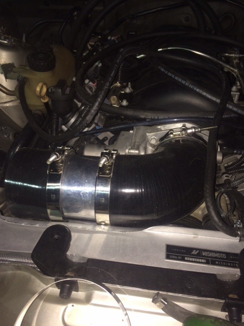

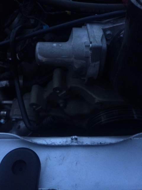

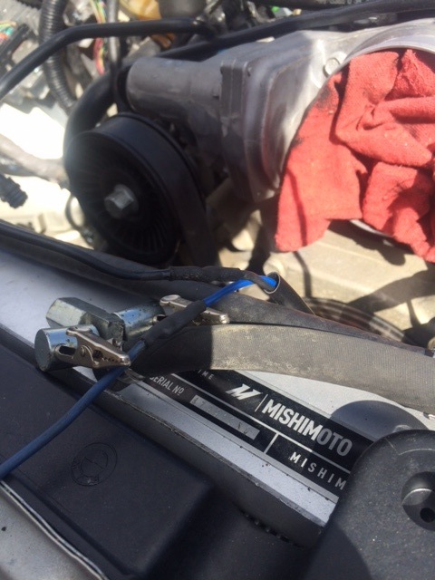

      Small update. We got all the materials to build the exhaust and the intake. With the exhaust we just need someone to come out and TIG it all together, but for the intake we've had to make a lot of room. We pulled the rad as close to the front as possible, shaved down the throttle body motor a bit, bent parts of the radiator, and we have to get a new tensioner. Possibly the MTI racing one.

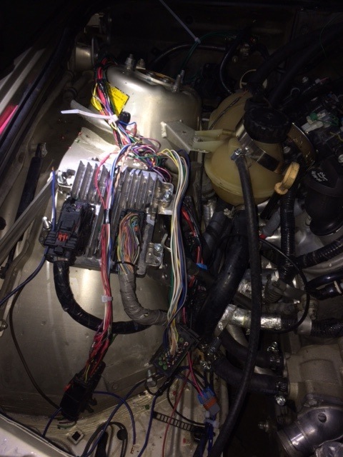

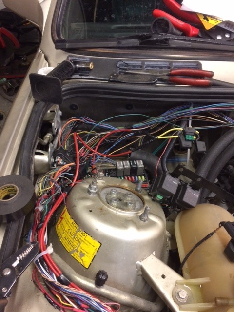

      Wiring has also been started. Just prepping until we get a fuse box that has been ordered. Shouldn't be too difficult. The hardest part seems to be making it look pretty.

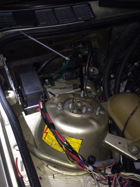

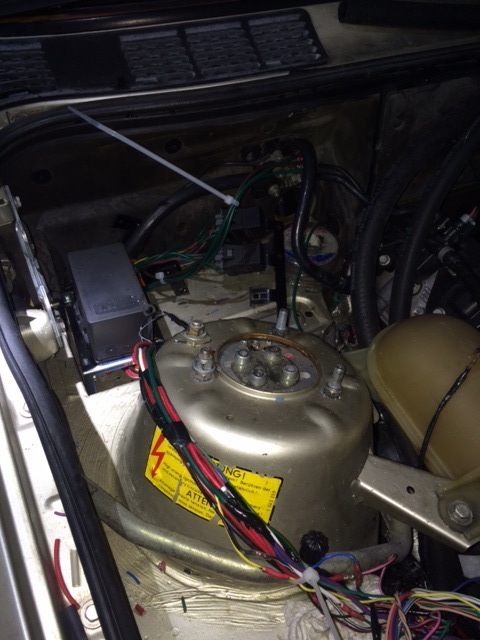

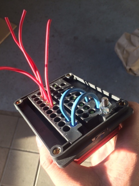

          Big update! Started wiring, it's not too difficult I find the hardest part to be making everything look pretty. I don't want this to be one of those very sloppy swaps with wiring everywhere.
          Starting wiring. We went with a fuse box to organize things.

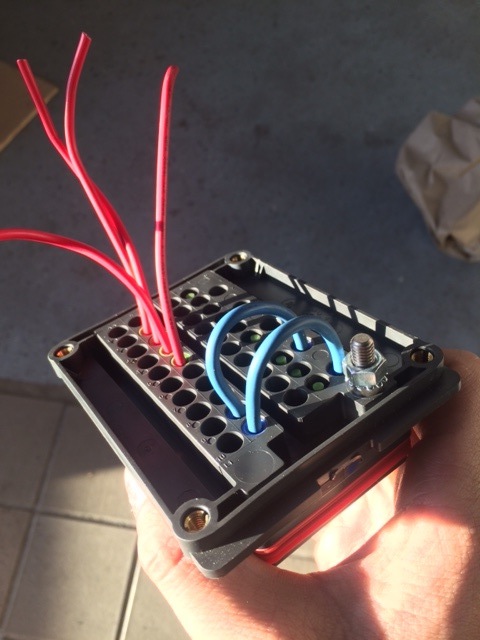

          This is after around 6 hours of figuring things out, routing, soldering, then taping them all together. The fuse box will be going in the battery tray.
          Another shot of the fuse box.
          Close to being done with all of the wiring. Have just a few mire wires to route and solder. Going to the junkyard tomorrow to pick up various things for the clutch and accelerator pedal. And we are also getting a tensioner to build ourselves, probably easier that way rather than spend 150 on a aftermarket one. Ordering the driveshaft Monday.

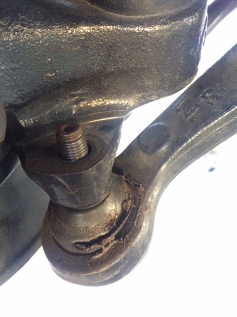

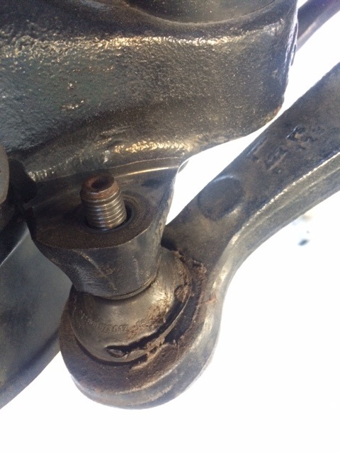

          Small problem, both balljoints were ripped and needed to be replaced. quick fix and was only 26 bucks.

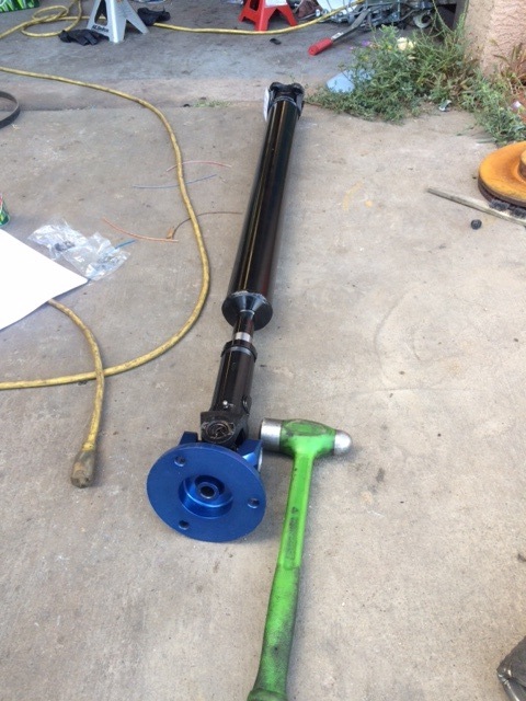

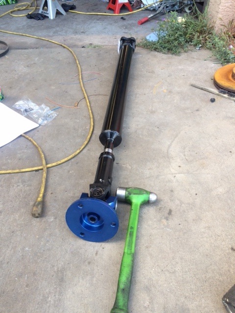

            More parts! Got the driveshaft, and paired it with the 1350 flange.

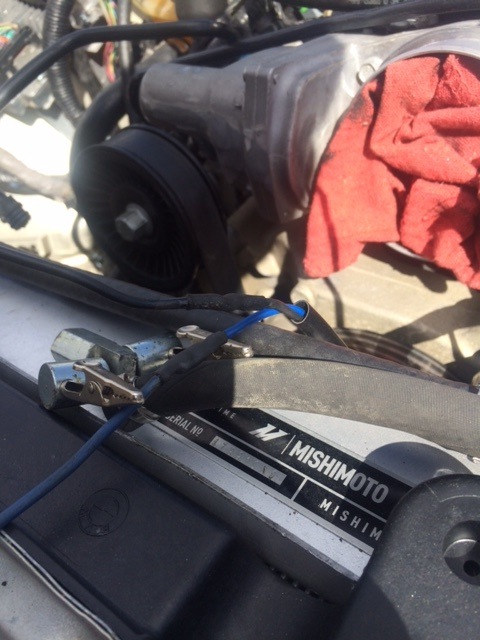

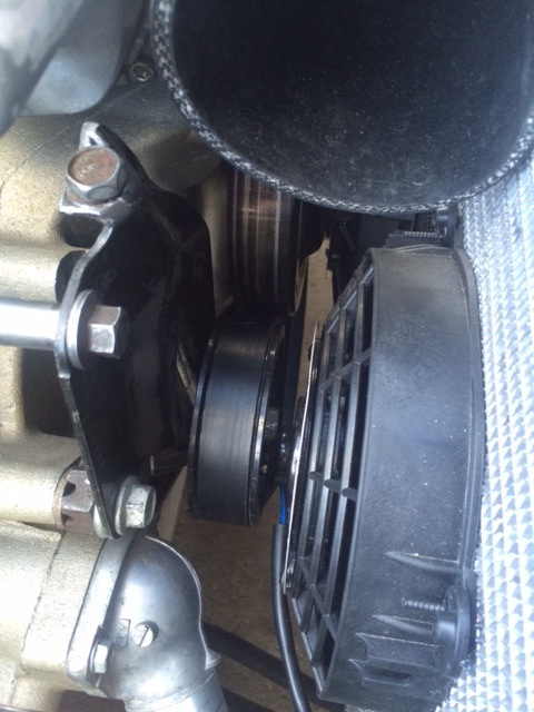

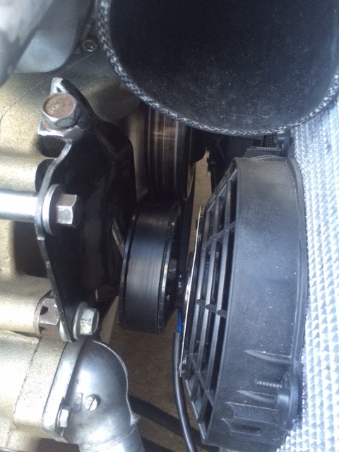

            Tensioners almost done, just need a brace then we are good! Got a new belt that fits as well.
            And since we got the tensioner problem fixed, the intake can be made! Just need to cut some and that'll be done pretty quickly.

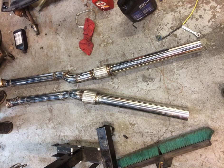

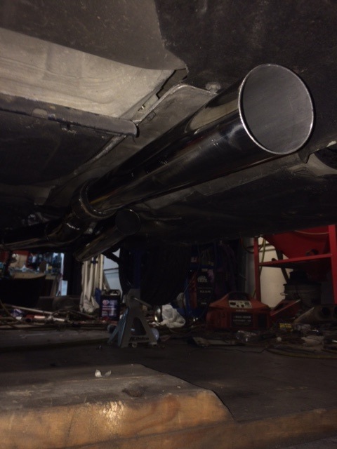

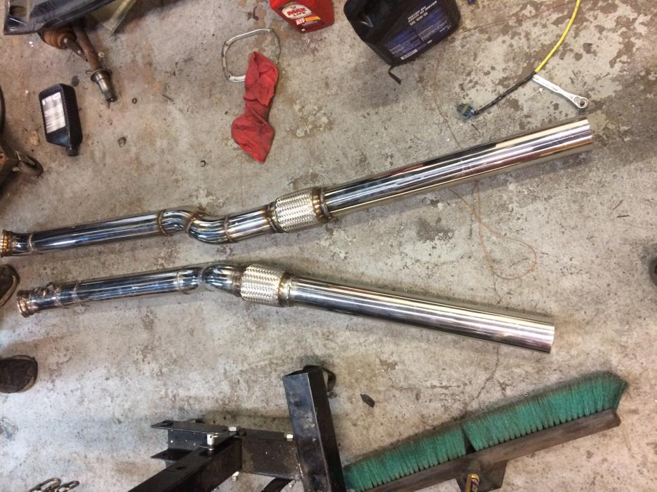

                    Exhaust is coming together! The full dual 3" is making it hard to make sure there is good ground clearance.

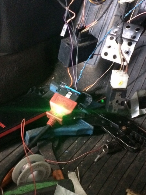

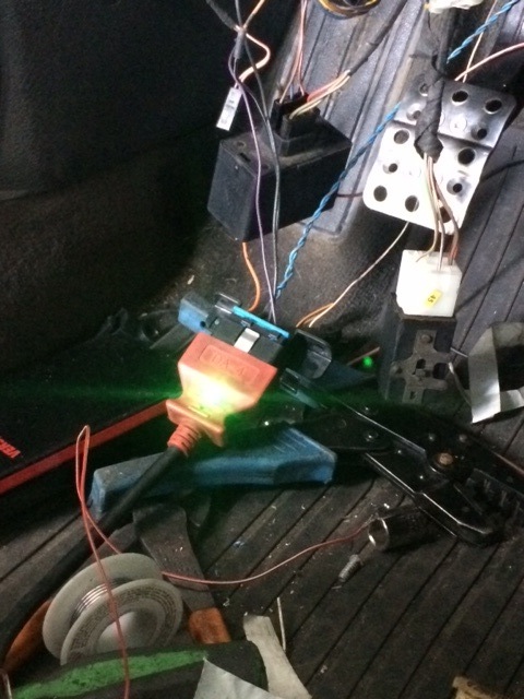

                    Got the OBD2 port wired up and working, of course it's throwing a lot of codes. None of them are cause for concern.

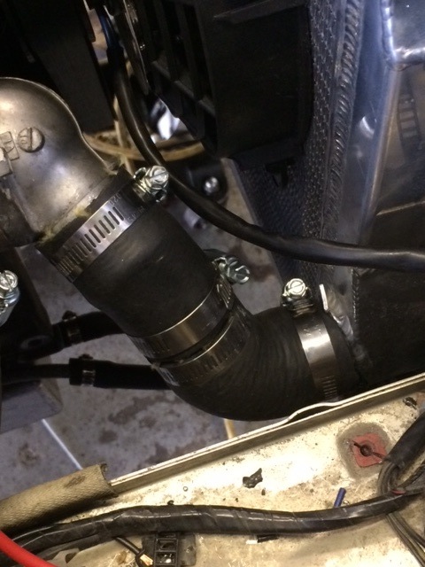

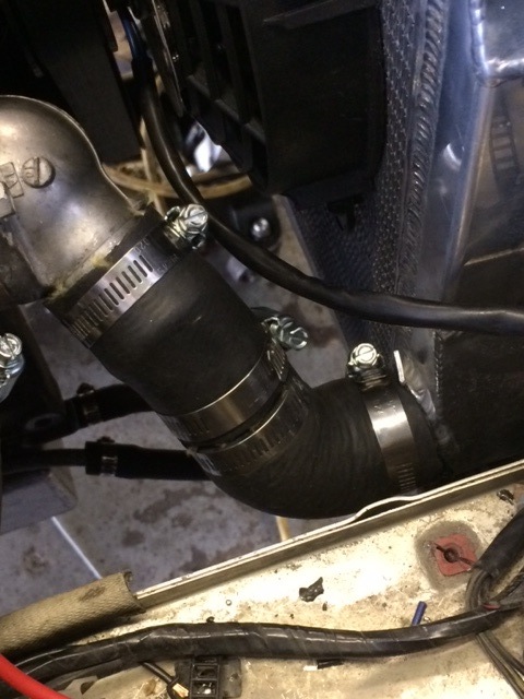

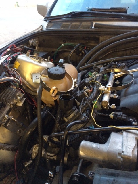

                    Lower and Upper rad hoses are done.

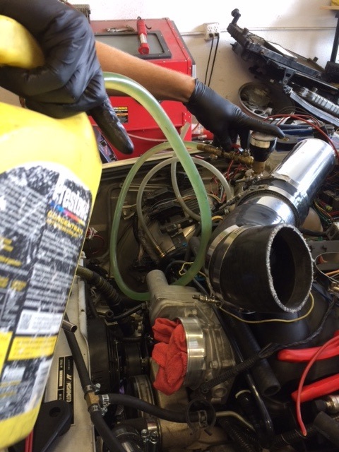

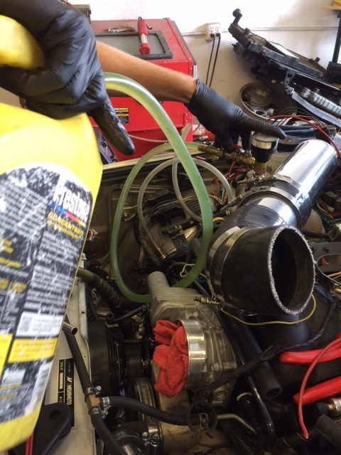

                    Since they are done we vacuum filled the coolant system.

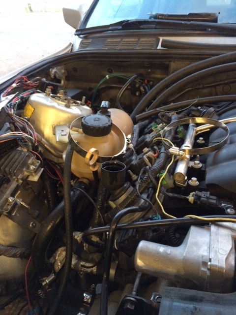

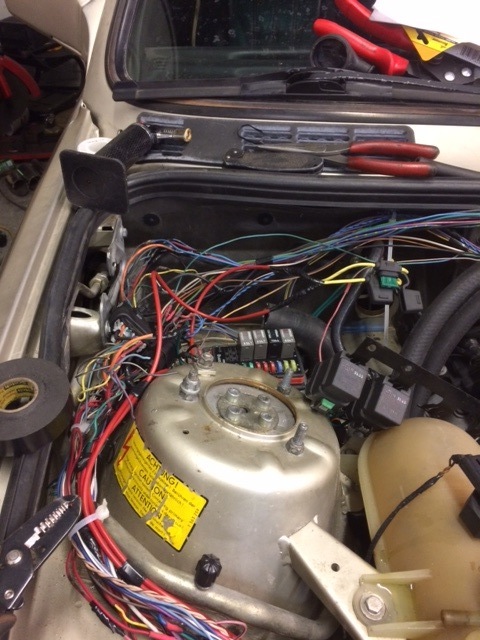

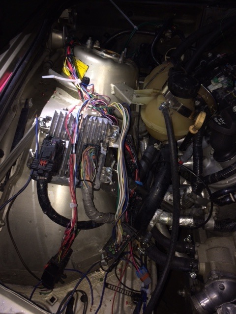

                    Wiring is still in progress, here is the mess so far... Only half a connector and some stragglers left to solder.

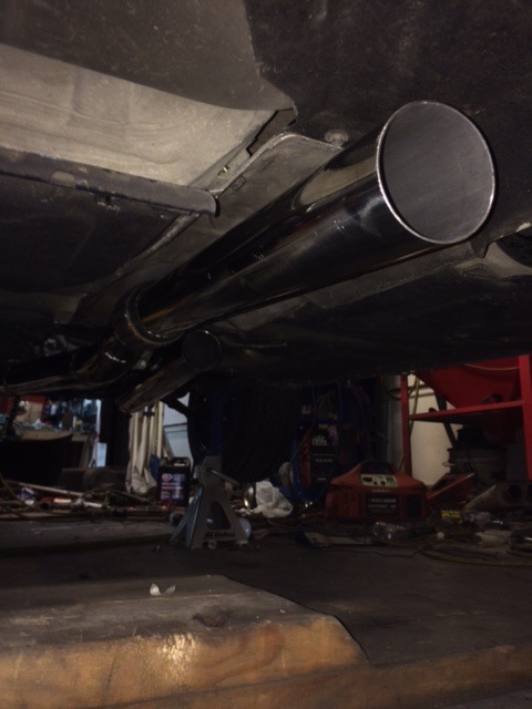

                      Got the exhaust all the way to the rear diff, the rest should be pretty quick. We almost just did a side exit right in front of the rear tire just to make it quicker. But I thought that would be way too loud. Rear diff also had to be raised by some spacers because of the driveshaft. Still have to figure out some more wiring.

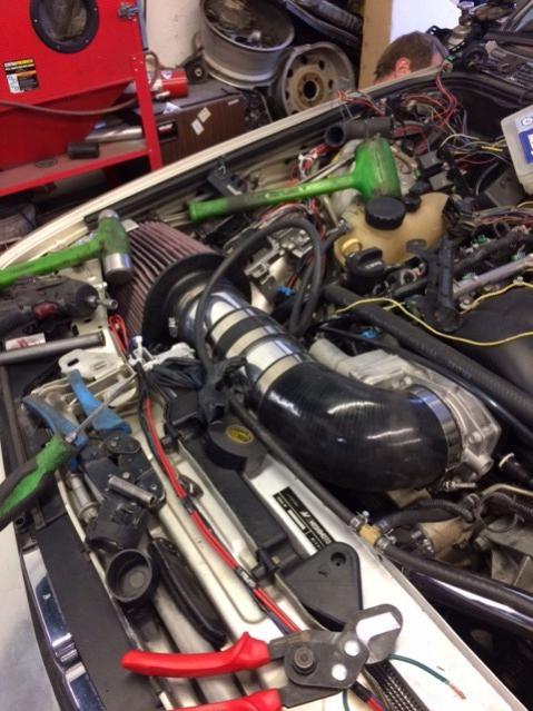

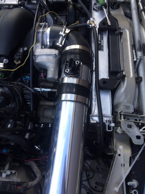

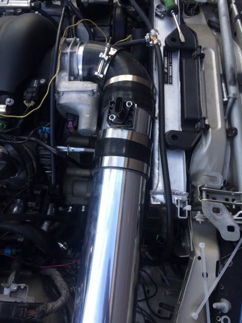

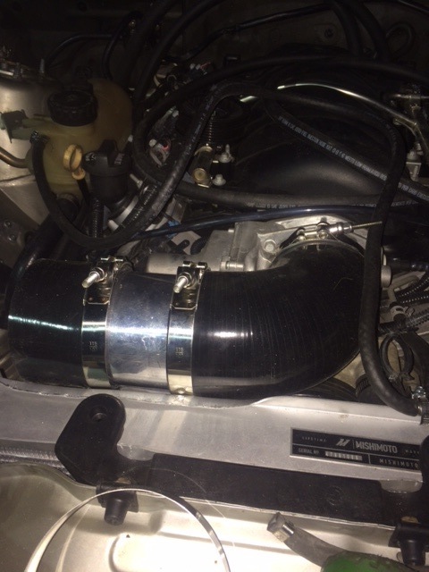

                        Got the intake done, pretty tight fit but it's done.

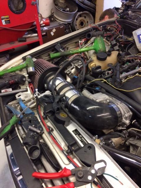

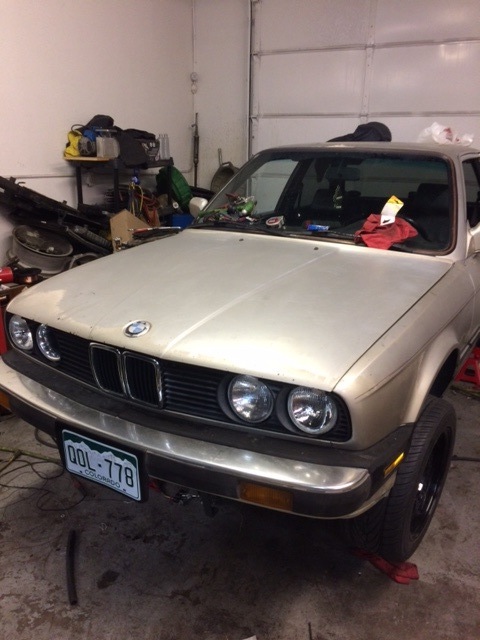

                        After we got the intake in we put on the hood. There was so clearance issues with the top of the filter. Easily fixed.
                        Now it's just killing time until the steering shaft gets here. It's ready to be started, the only wiring left is for gauges. The exhaust is almost done. Just spot welded pipes into position that will need to be fully welded tomorrow. We fabricated a hanger bracket to the tranny. Just in case if I bottom it out on a speed bump it won't destroy my headers.

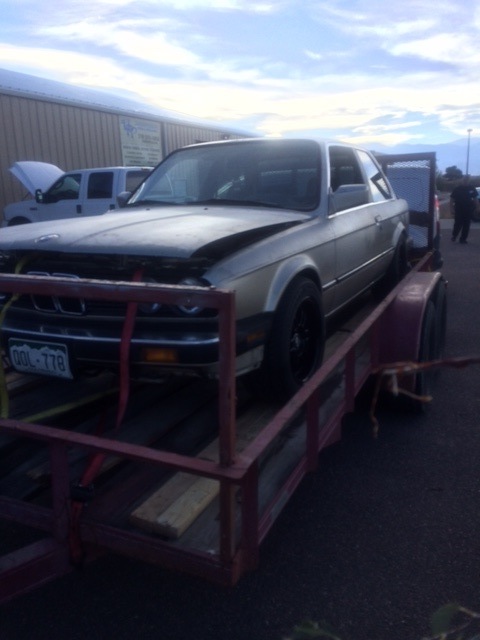

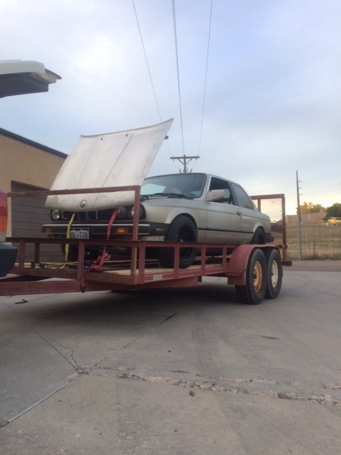

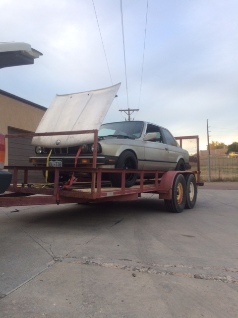

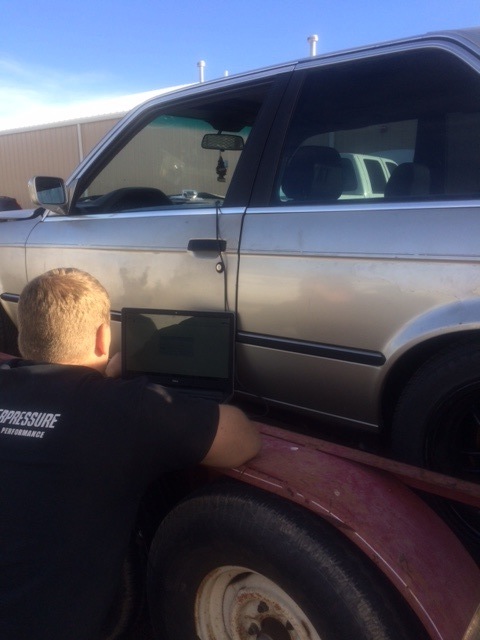

                              Big day today! We loaded it on the trailer and brought it down to Under Pressure Power & Performance. Looks mean on the trailer.

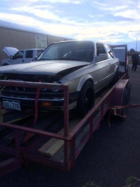

                              At the shop.
                              Tuning.
                              And some more shots on the trailer.
                              First start! First impressions are: INSANELY LOUD! The straight 3" is way too loud. Muffler has already been ordered. I'm not sure how accurate an Iphone decibel meter is... but supposedly it idles at are around 90-95. But at this level it is not daily drivable. I will be pulled over every 20 feet.
