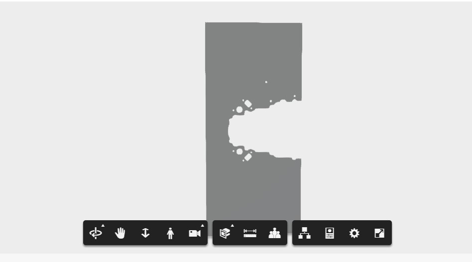

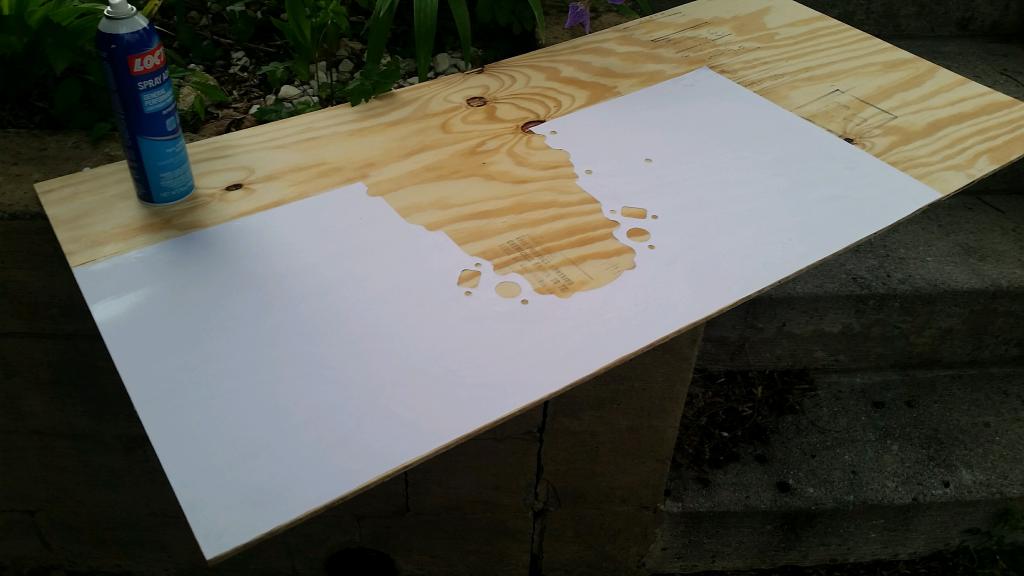

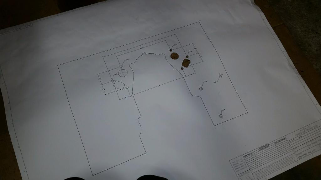

                            Front plate mounts can be purchased easily from a number of different sources. However, given the amount of modification I was going to need I decided it would be easier to design my own.
                            I started with a 3d rendering of the engine and designed the plate off of it. I then printed the drawing full scale and cut it out using an exacto knife to check that my dimensions were correct. After a few tweaks, I glued the final drawing to a piece of 1/4" plywood to mimic the thickness of the plate.
                            Creating a plywood template allowed me to mock up the accessories and take dimensions to determine which spacers, brackets, and accessories I was going to need.

                              Mounting the plate to the motor was easy. The real challenge was determining the best method for mounting the plate into the BMW.
                              I took a ton of measurements and modeled a very crude engine bay. I was then able to mock up the engine bay without ever having to lift the actual engine. I even modeled an oil pan to make sure the clearance over the cross member would be sufficient.
                              The drawings were then sent to the machine shop for fabrication. I was happier than a fat kid in a candy store when I got the plate back.
