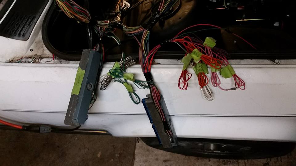

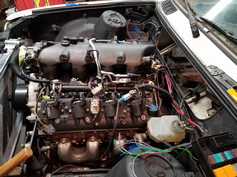

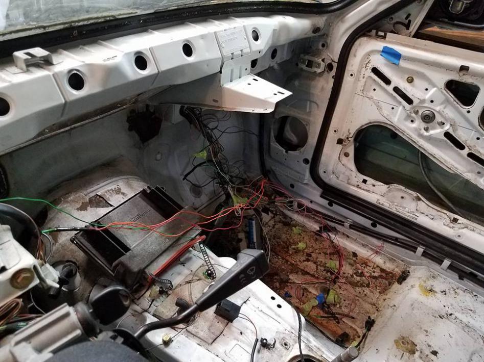

    Worked on the wiring some more this weekend. The harness is installed on the engine and in the car. Next step is to integrate the engine harness with the car's harness.
    I had to extend all the wires coming from the driver side since the computer will be located on the passenger side.
    All the connections needed were bundled together and separated

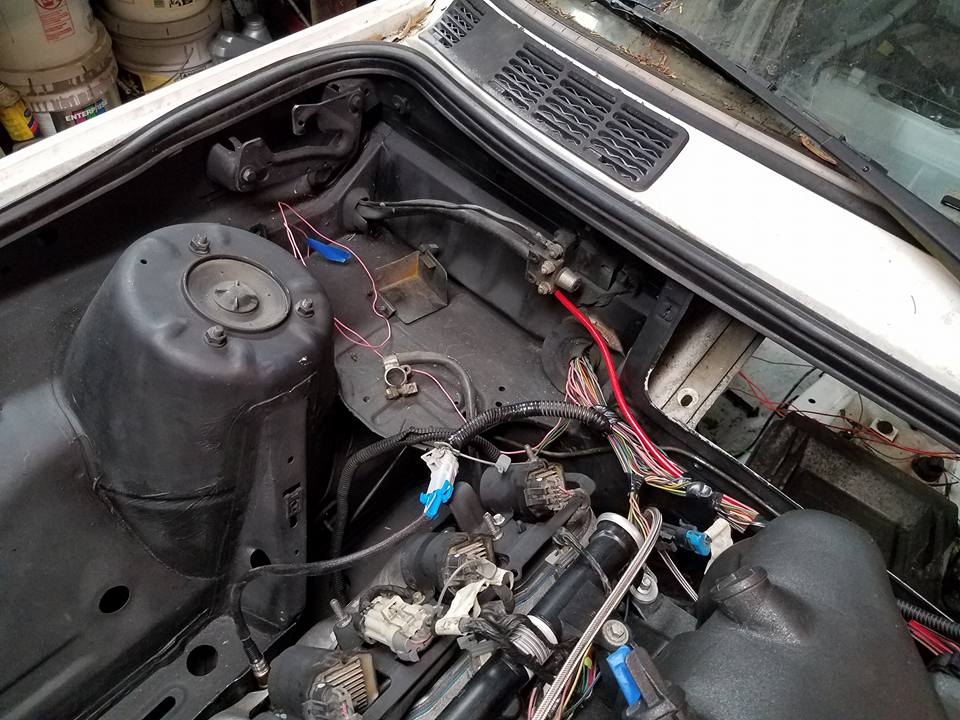

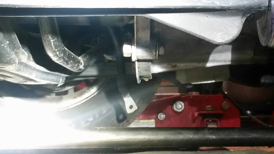

    While running the harness to the trans, I noticed that there was brake fluid dripping from the bell housing.
    Looks like I'll be pulling everything back out. :down:

        Is the intake going to clear the hood? I kinda wish I went this route if it does
        1989 325i LS Swap (Money Pit):https://www.r3vlimited.com/board/sho...d.php?t=244933
        COTM Feb 2019: https://www.r3vlimited.com/board/sho...d.php?t=428404
        • sgtskid
          • 763
          #49
          It's really close. Removing the padding and a light massage may give the extra clearance I need but as it sits, it won't clear. The hood isn't great and modifying it doesn't hurt my feelings.
          Cheaper than buying an ls intake with the injectors, fuel rail, fuel filter, etc.

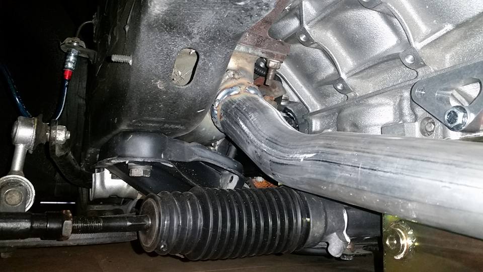

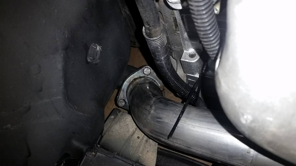

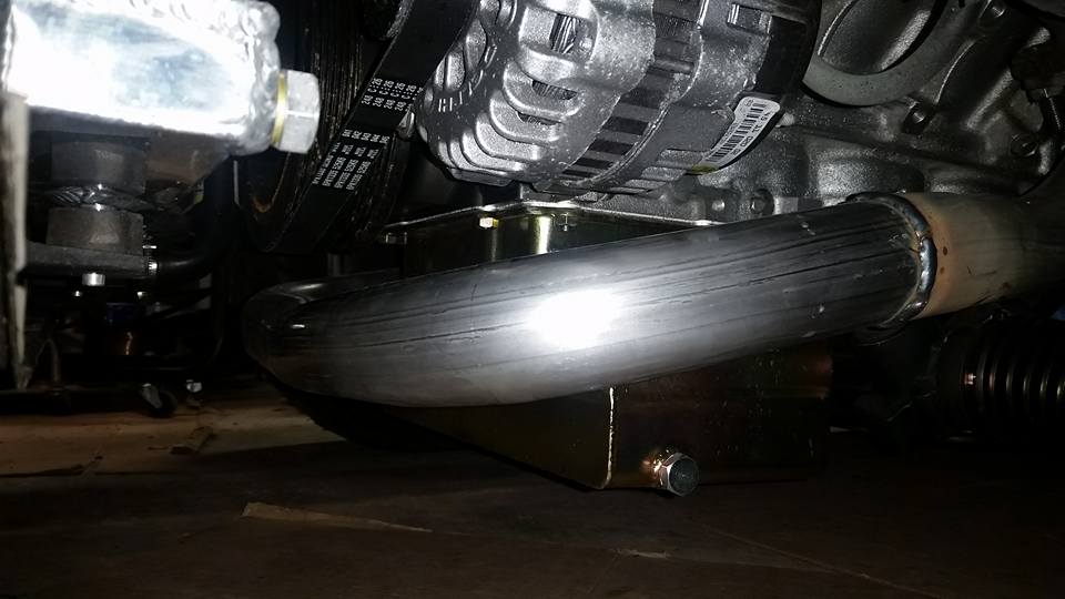

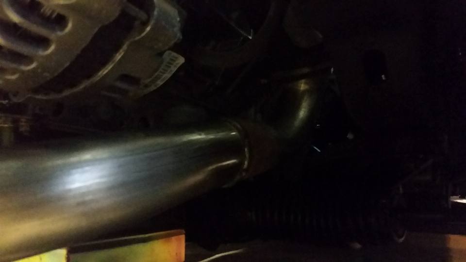

            Got the exhaust done yesterday. We tried something a little different...
            The exhaust was super simple and cheap - no fancy, expensive headers. The motor plates allowed me to use stock LS2 manifolds from a 2007 Corvette ($150 shipped with gaskets). The stock manifolds also have O2 bungs built in which saved on fabrication costs.
            The stock manifolds allow for plenty of room to run the exhaust on both the driver and passenger side with zero interference with the steering linkage. However, I tried something different. Since the factory exhaust routes down the passenger side of the car, the floor board is raised which allows for the pipe to sit higher which equals ground clearance. To keep ground clearance, I ran the driver side exhaust around the front of the motor and tied it to the passenger side and then ran the exhaust pipe down the stock location. The exhaust is constructed in such a way that I can unbolt it from the engine and at the fire wall and easily remove it. The exhaust is straight piped back to a series 40 (delta flow) Flowmaster. I am excited to see how it sounds

                  That exhaust setup looks good!
                  We did something similar in my friend's LS1 swapped Jeep Wrangler to clear all the suspension and steering bits.

                    Thank you. I can't wait to hear how it sounds! I had to cancel Sunday's meeting with my wiring buddy. We rescheduled for Tuesday. Hopefully we can get the wiring knocked out!

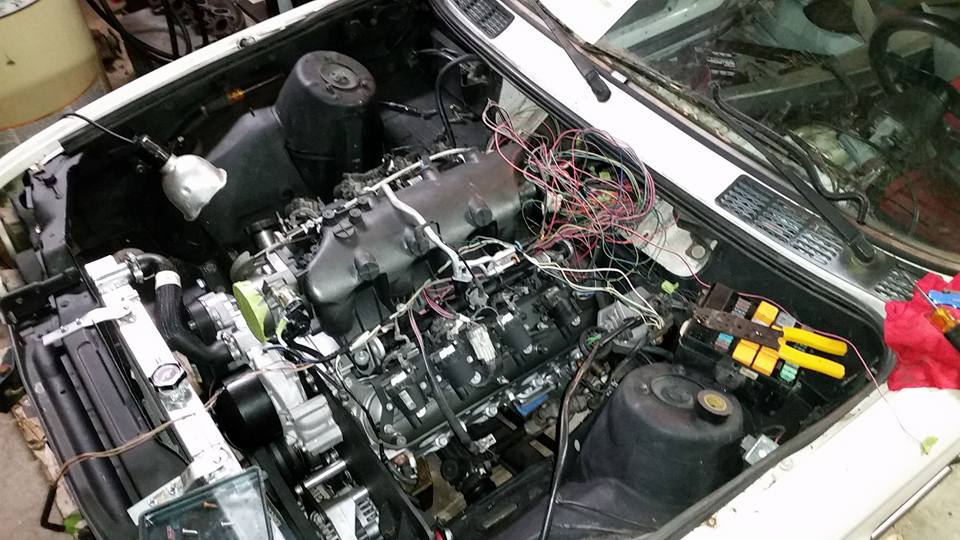

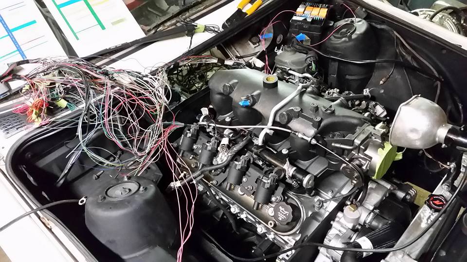

                                Slowly knocking out the wiring.
                                Holiday travel and first of the year stuff has left the ol' girl a little neglected over the past couple months. Racing season is about to start again so hopefully I can get some stuff knocked out before it starts consuming my time.
                                Getting close to being able to crank it!
                                I still need to finish plumbing the oil lines to the filter, mount the dipstick, and fill the engine with oil. The mechanical installation will be complete.
                                Electrically, I need to connect the starter but the wiring studs broke off the starter last night. I also need to finish the alternator wiring. Once everything is complete and the engine is running I'll put everything in looms and make it look tidy. I want to hear her run first.
                                The rats nest that is wiring....
                                An ohm meter with an audible alarm is a man's best friend when it comes to tracing wiring!
