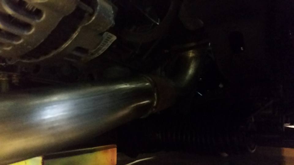

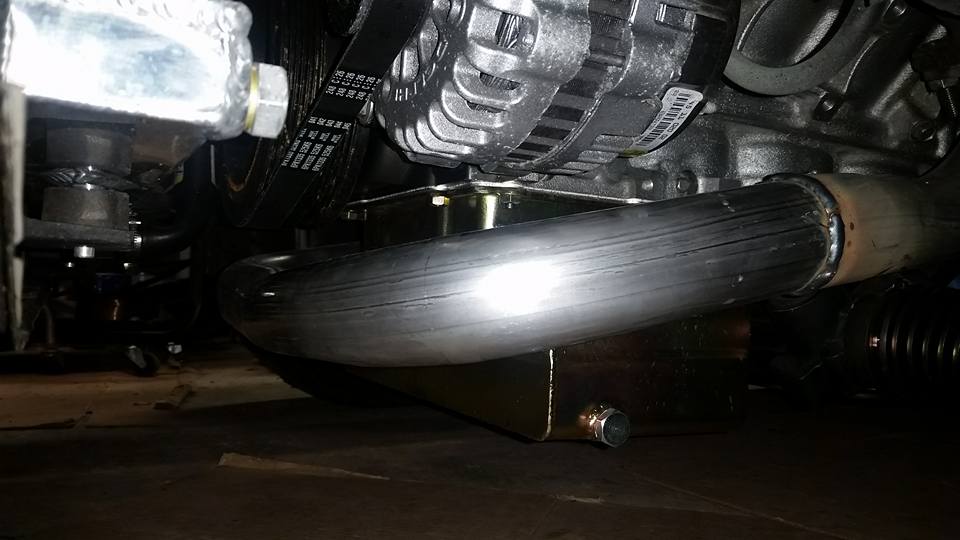

    Got the exhaust done yesterday. We tried something a little different...
    The exhaust was super simple and cheap - no fancy, expensive headers. The motor plates allowed me to use stock LS2 manifolds from a 2007 Corvette ($150 shipped with gaskets). The stock manifolds also have O2 bungs built in which saved on fabrication costs.
    The stock manifolds allow for plenty of room to run the exhaust on both the driver and passenger side with zero interference with the steering linkage. However, I tried something different. Since the factory exhaust routes down the passenger side of the car, the floor board is raised which allows for the pipe to sit higher which equals ground clearance. To keep ground clearance, I ran the driver side exhaust around the front of the motor and tied it to the passenger side and then ran the exhaust pipe down the stock location. The exhaust is constructed in such a way that I can unbolt it from the engine and at the fire wall and easily remove it. The exhaust is straight piped back to a series 40 (delta flow) Flowmaster. I am excited to see how it sounds
