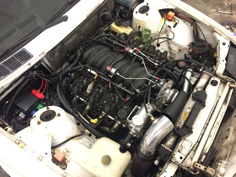

    Got my ECU all mounted up. It actually bolted up to the factory Motronic mounts and fit with some minor cover/glovebox trimming. Enough real estate under the cover for my bluetooth adapter as well.
    Got my passenger side header squared away. It's from a 5th gen Camaro shorty set. One runner took a little massaging for the frame rail clearance but it was pretty minor. Exhaust should be finished up this weekend.
    Intake pipe and coolant tank finished up. Had to use OE style hose clamps since everything is so narrow.
    Lower radiator hose setup. 135 degree silicone bend, 1.5 u bend, 1.5 straight coupler
    Bent up some hardlines for most of the trans cooler run. Way cheaper than AN hose.

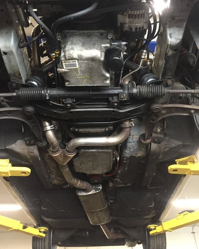

          Tomorrow will be one month since I started. Getting to the final stretch. Filled the motor with oil. All the wiring, minus some battery power connections, is finished up. Just need to install my shift kit in the trans, source a 2.79LSD and install some hose clamps, air filter, trans cooler and radiator fan. Used an F-body power steering hose and just welded the banjo fitting off the old BMW hose. Finished up the exhaust as well.

            Fired it up on 7 coils today. Freshly motivated to finish the rest of little stuff. Trans is still empty so didn't let it run for more than a few seconds.

                  #38
                  Pretty much a diff, driveshaft, silicone coupler and throttle cable away from doing burnouts. Topped all the fluids off and let it run for an hour or so. Didn't get over 186 holding the motor at 4k rpm for awhile. No higher than 181 at idle. Just running the stock radiator with a 16" Spal pusher.
                  Can't wait to get it back on the road every day.

                            whered you get the piece that connects to the throttle body
                            e30Ls1 Swap IG: 1dirty30
                            • jon volk
                              • Dec 2004
                              • 524
                              #44
                              Ebay
                              Powerdyne supercharger elbow
