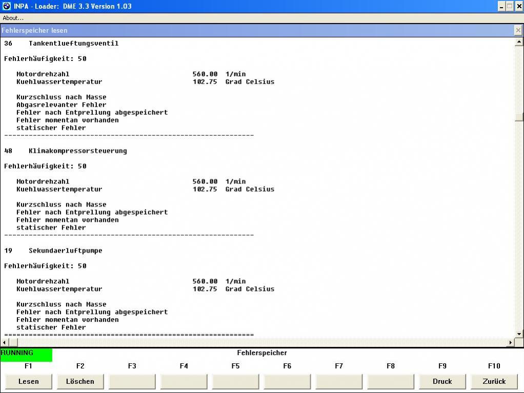

    hi,
    by end of 2015 i swap'd my car from the m52b25 to the m60b30,
    everything works as expected but i would like to remove these codes from appearing.
    they all are related to stuff my car doesnt have.
    Code:
    tankenlueftungsventil       -> Tank venting valve
    klimakompressorsteuerung    -> Air conditioning
    Secondary air pump          -> sekundaerluftpumpe
    i dont have any of those,
    car is a 316i(m40b16) from 1989 (no obc/no airbag/no abs/no check engine light im in france)
    the engine is from a manual e32
    harness comes from an auto e32
    the ecu from an e38 (484-w/ no ews)
    i have a 404 that i dont use because no diagnostic/data-graph program works with it (testo/inpa) and i just keep it as a backup incase my actual one dies.
    how should i proceed to remove a/c & sap & charcoal canister related errors.

      i wonder if i need a chip or if i must trick the system to somehow believe these items are present & if so, how?

        will removing the wiring/relay related to it solve my problem or do i need to wire in a resistor or some shit to fool the dme but then will this little guy mess with my idle and other things? (no i dont plan on adding a/c it's fairly cold here)
