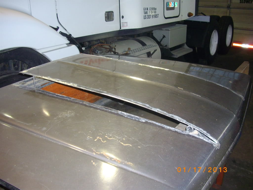

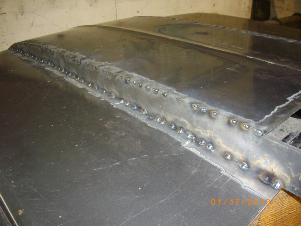

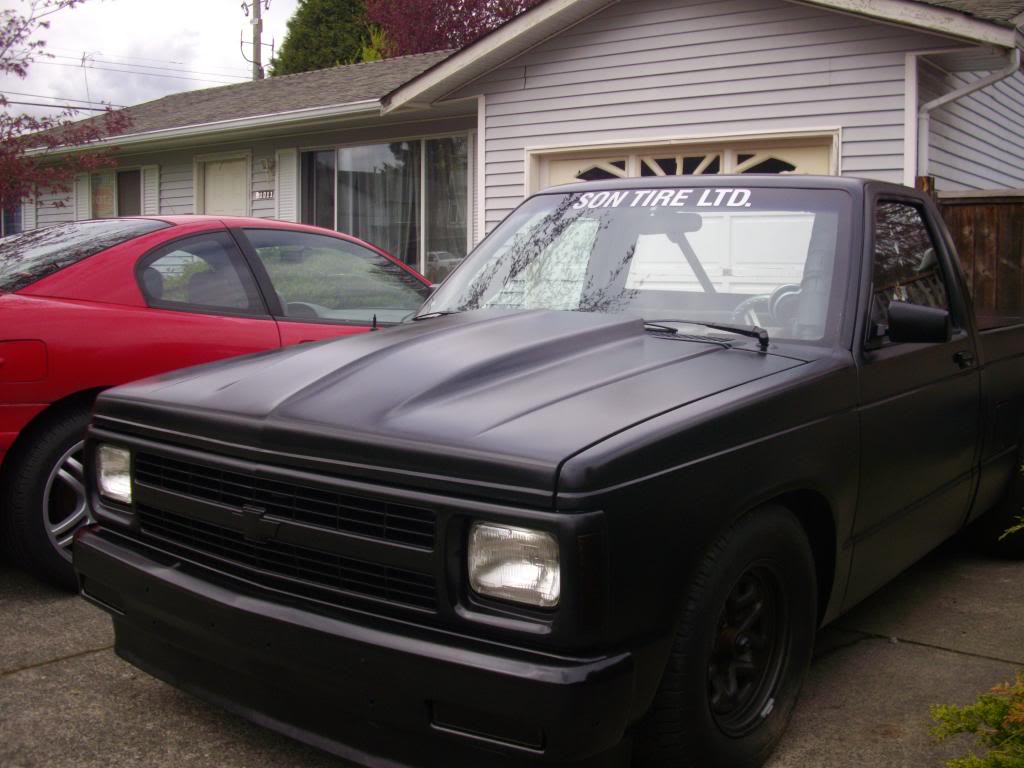

          So I'm thinking of doing something like this... With a spare hood of course. Just incase I don't like the way it comes out.

          I really want to follow the existing lines of the car.

            #35
            That is really close to what I did with the exception of going all the way back with the raised portion. I used a cutoff wheel and made a cut along the bottom of the body line. I put a piece of foam on top of the engine and placed the hood back on the car. I let the engine make the shape in the hood and then I exaggerated it a little more for clearance. I welded it in place and then filled in the gaps with scrap metal I had.
            I thought I had more pictures of it in my build thread, but i guess not. I can send you some tonight if you'd like. I have them on my portable hard drive.
