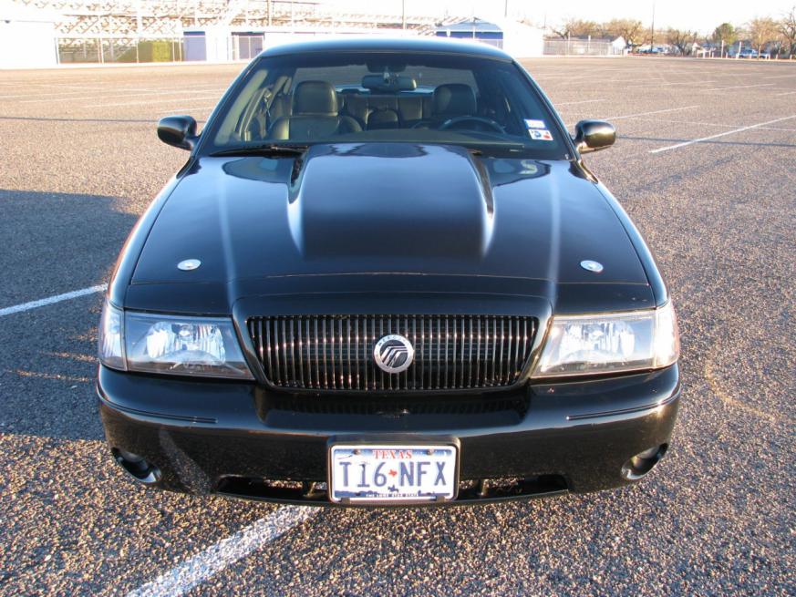

    you have a beautiful car Dave. hacking a hole in the hood would be awful. I think about akin to going to a fancy steak house, buying the 100 dollar ribeye, and then proceeding to blast a greasy Mexican food and beer shit all over it before consumption.
    I'll look around a little to see if I can come up with some ideas to post here for a hood bulge.

      Believe me I really don't want to cut a hole in the hood. The hood clearance has been bothering me since I started on this project. I really appreciate the help

                  can you give me an idea about how far it will stick out?

                    Its about 4" taller then a ls1/ls6 intake. I don't know how much head room those intakes have to the hood. Maybe someone here can pull those measurements from the ls1/ls6 intake to their hood. That way we can figure out how much room I will need to have.

                            maybe you can experiment with laying something about that height on top of your engine and see if the hood will close over it?
                            Originally posted by Supadave
                            No, there cathedral. I'm running the adapters which are 1/2" thick.
                            will this make the intake stick up higher? maybe it might be worth finding the matching heads if it could clear without hood modification.

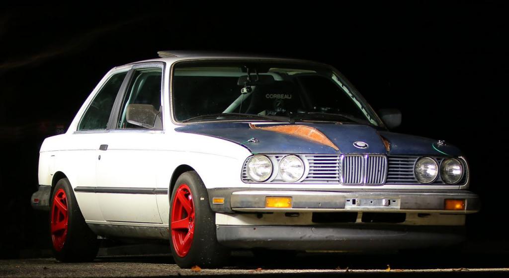

                              The truck intake will not clear the stock hood. I butchered a scrap hood as a quick fix but i had to raise it 2-3" to clear comfortably.

                                Not bad, I bet with a lil more time and effort this could look pretty good. I would probably continue the height all the way to the end of the hood...
