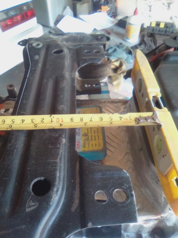

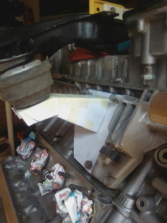

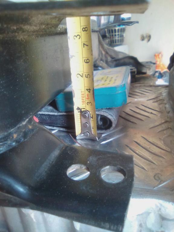

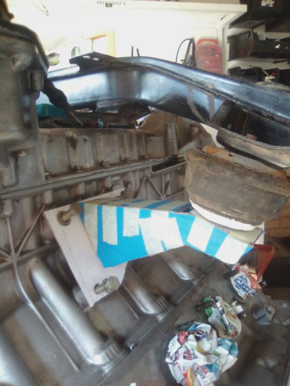

    Good day r3v, need a little help with my swap.
    M60 v8 from 540i
    Oil pan has been notched
    Subframe top steering rack mounting tabs will be cut and welded low for the purple tag e46 rack
    I will be making welding my own mount brackets using original 540i engine mounts
    I would like to know what should the space between subframe and pan be?
    I plan on using the original 540i reservoir for cooling system so would like my engine just high enough for that to fit .
    Basically I have a complete donor car so I would like to make use of whatever I can.
    Thanks guys
  • slum dog
    • Jun 2017
    • 110
    This is were I am now ,would like some experienced input
    Thanks

        I'd probably leave a ~1/2" gap between the pan and the highest point of the subframe/steering rack area. If your mounts settle, you could always add big washers between the rubber mount and mount arm to raise the engine. Try to bring the engine down is much harder...
        I ran new OEM mounts for a while, they are very stiff, as far as not allowing much engine movement. I switched to Poly mounts, which are stiffer yet, but do allow a bit of vibration. I could probably have an 1/8" pan-to-subframe gap, and still not have contact under load.
        Also keep an eye on the distance between the rack and the vertical part of the oil pan. I believe I have less than 1/2" there as well.
