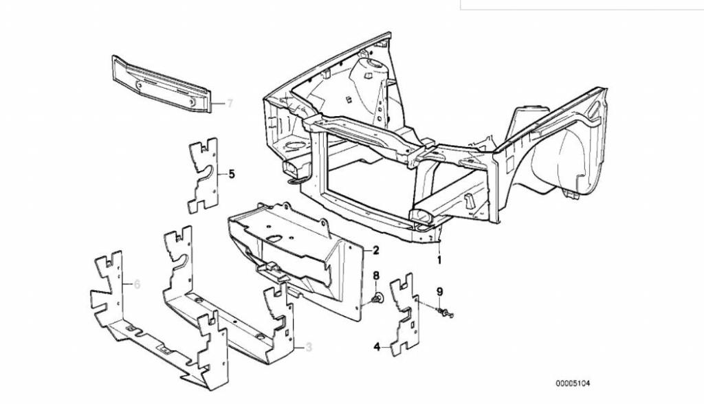

    Can anyone confirm there should be a Fan Shroud in the front? I checked Real OEM and it shows item 2 that I do not have on my car, but I have items 4 and 5. Should I have all three? I don't have items 3 and 6 either. What should I have there?

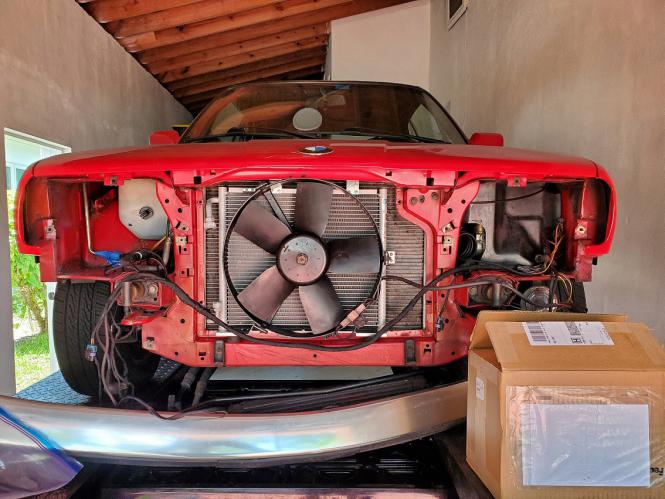

    Yes you need a fan shroud, that's definitely not helping your pressures. If your condenser fan in front of the car isn't working efficiently that's also only hurting your high side pressures. Is it coming on high speed? Will it suck a rack into the valance when it's on? 300psi isn't anything all that crazy for A/C pressure pending ambient temps though.

      In terms of the Fan Shroud, just to confirm, I have the Shroud on the Engine Coolant Radiator side and the two side "plastic plates" items 5 and 9 above, but nothing in between the AC Fan and the Condenser, but it really does not seem a Shroud fits in there. I am looking at some of the threads and see some do not have that item 2 either. But seem to have item 3. These Parts Catalogs are not clear. The price is not that high for item 2, but it does not seem it will fit and might be for some different model (?). Mine is a 1989 325i Convertible Auto. Last pix is mine.
